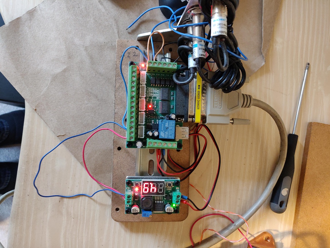

Thanks a lot… and thanks for the video!
I just tried your edited version out, but still no luck… I don’t know why not…
What kind of switches did you use?
I have some NPN switches, which I will use for my next build… I will try them also.
I found the input pin in the HAL watch under parport, but they also don’t trigger when I manually trigger the switch.
- Clive S
- Posts: 2204
- Thank you received: 486
14 Feb 2022 11:06 #234801
by Clive S
OK I saved thee hal show config which you can download.
I used pnp sensors and used your config that I modded, I also used the same BOB as you.
I see you are using usb for 5v that is not a good idea !!
I will test with switches like yours and report back.
Can you be specific in how you are connecting the power supplies and if you are connecting the 2 grounds together.
You could of course have a faulty bob but I doubt it.

I think the solution lies in the grounding…
Basicly my whole electronics box is grounded to earth.
I have 1 power supply, 24V MW.
The ground lead from the power supply is connected to the electronic box.
I think I have to connect the inputs GND from the BOB to ground.
So shall I connect it to the electronics box or shall I connect it to the - (negative) from the 24V power supply?

A I see how you connected the 5V, that is a smart solution! But why do you prefer it over USB?
- Clive S
- Posts: 2204
14 Feb 2022 12:29 #234813
by Clive S
USB can be flaky . Have you checked the pp cable?
Replied by Clive S on topic Home switches wiring / setup
