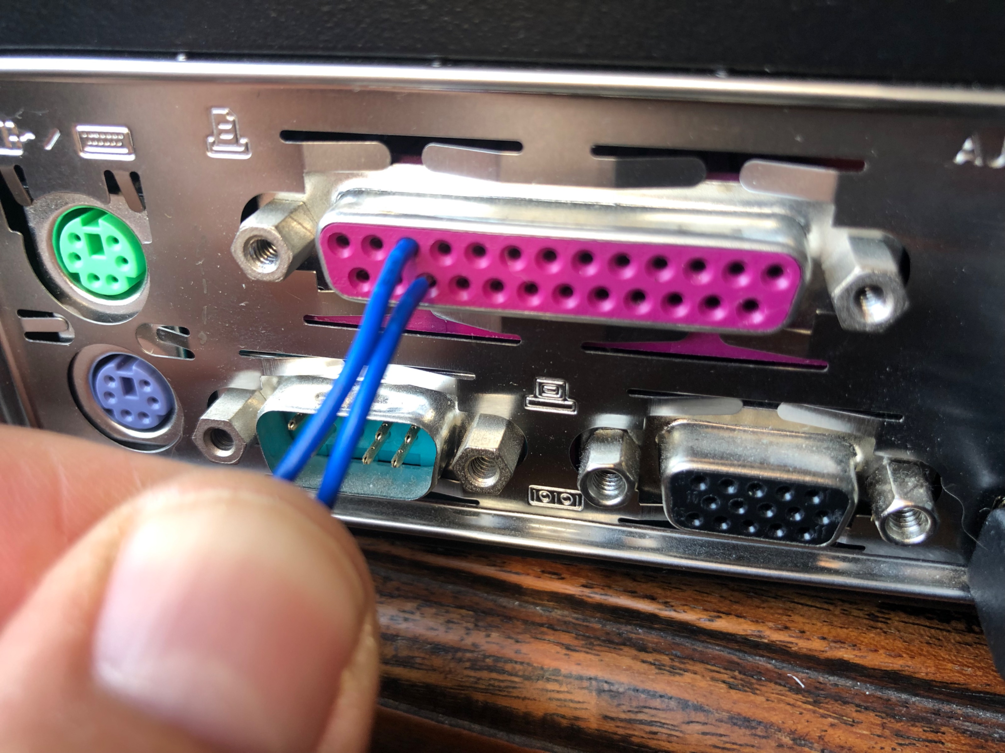

I have only 1 parport which is build in.
I also changed the address in the BIOS to 0x378 and I’ve changed that in my HAL file also. To jumper P10 to GND I used a piece of wire with both end stripped (pretty long) to get the wire all the way in.
Have you ever seen someone to be able to use the outputs but not the inputs? Is that possible?

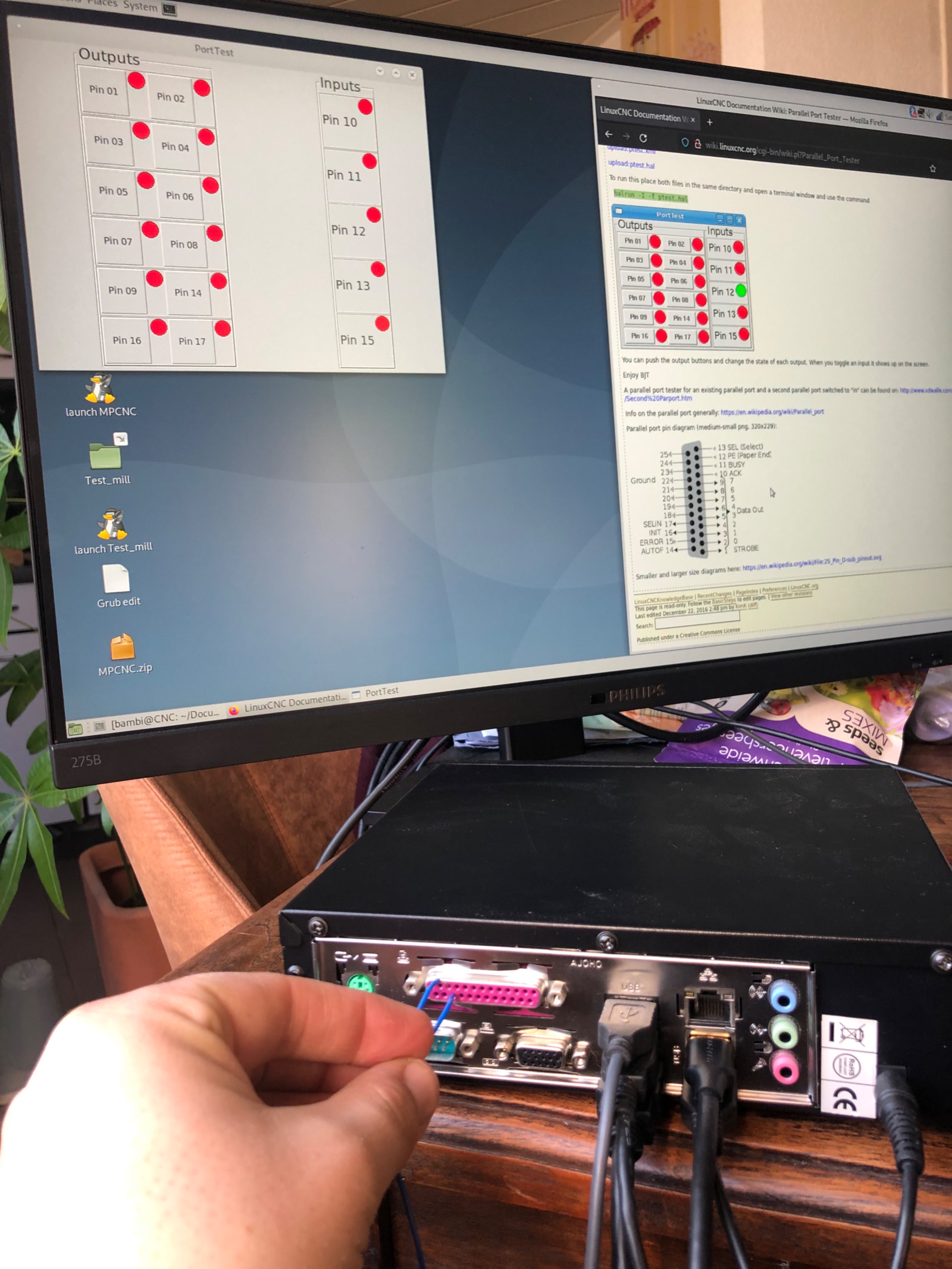

05 Mar 2022 10:17 - 05 Mar 2022 10:32 #236412 by remon_v
Replied by remon_v on topic Home switches wiring / setup
Thanks Clive for the reply!
I haven’t connected the GND next to the input pins to the PCGND next to the PC5V pins. I can try that later…
But correct wiring yes or no, I can’t get the PP tester to work on the input pins…
I’m testing it directly on the parport on the motherboard. If that doesn’t work then the rest doesn’t work either right?
look at the photos I have attached, I’m testing it correctly right?
Last edit: 05 Mar 2022 10:32 by remon_v.
05 Mar 2022 10:55 #236416 by Clive S
Replied by Clive S on topic Home switches wiring / setup
Yes it should work like you have it. I have just tested it to make sure
So you might have the wrong address for the PPort or wrecked it. Be careful when shorting pins on the PPort.

05 Mar 2022 14:04 #236431 by tommylight
Replied by tommylight on topic Home switches wiring / setup
In the attached picture of the BIOS screen you have the parallel port set to "auto", change that to 378, save and reboot.
Wire test is OK, but to be sure, one side of the wire touch to the screw, the other on the input.
05 Mar 2022 21:34 #236453 by remon_v
Yes I did already!
What do you mean? Don't use one of the GND's on the parport but one of the 2 bolt/screws where the cable goes in?

05 Mar 2022 22:05 #236455 by tommylight
Yes.

07 Mar 2022 14:17 #236582 by Todd Zuercher
Replied by Todd Zuercher on topic Home switches wiring / setup
What mode do you have enabled for the parallel port in the bios? SPP usually is best for use as GPIO and software stepping, especially if you want to use the port with X-mode in stead of the usuall in or out, but EPP should still work. What ever setting, you may want to try it in different modes to see if it might work with one of the other settings.
It is possible that the parallel port was damaged when you ruined the other BOB. (or that it never worked right.)
