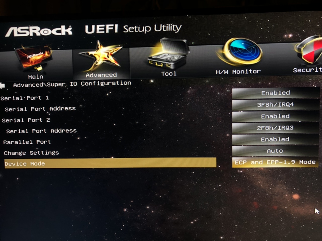

So my new BOB arrived today, finally!
First I tested it with everything connected the same… no luck
Then I did what Clive said, disconnect USB and connect 5V from a power supply… no luck
Then I tried a buck converter…. no luck
Then I hooked up a NPN sensor, brown and blue to 24V and the black wire to P10. The light turns on when in contact with metal, so that should be good. I also measured between P10 and the -VE, 24V when not triggered and 0V when triggered… also good right?
lastly I bridged P10 and GND and run the PP tester… P10 doesn’t trigger… so there is something wrong.
Oh I forgot to mention… I also tried some other BIOS settings.
Am I just unlucky or what….

04 Mar 2022 22:04 #236375
Replied by Todd Zuercher on topic Home switches wiring / setup
When you say you bridged p10 to ground, was that at the parallel port on the computer or at the end of the parallel port cable or at the BOB? Also you have to be sure to change the parallel port address in the parallel port tester config (hal) file to match the address of your port. or it won't work.

04 Mar 2022 22:26 - 04 Mar 2022 22:32 #236378
by remon_v
When I wrote this I was talking about bridging P10 to GND on the BOB... but now I've tested it on the cable also (the end/part that goes into the BOB)
'config string '0x378 out' it says before opening so that's oke. I can push the output buttons and the LED turns green, but when I bridge P10 or any other input pin to GND it doesn't trigger the LED
edit: I've now also tested the PP on the PC, still nothing... is that even possible???

05 Mar 2022 04:15 #236389
Are you certain about the parallel port address? 0x378 would be one possible (usually default) address for a built in port on a motherboard, if you have an add in pp card it won't be correct.
The Hal file you posted at the beginning of the thread uses [code]loadrt hal_parport cfg="0 out"[\code] which is the first parallel port address in the system what ever that is, which may or may not be 0x378.
