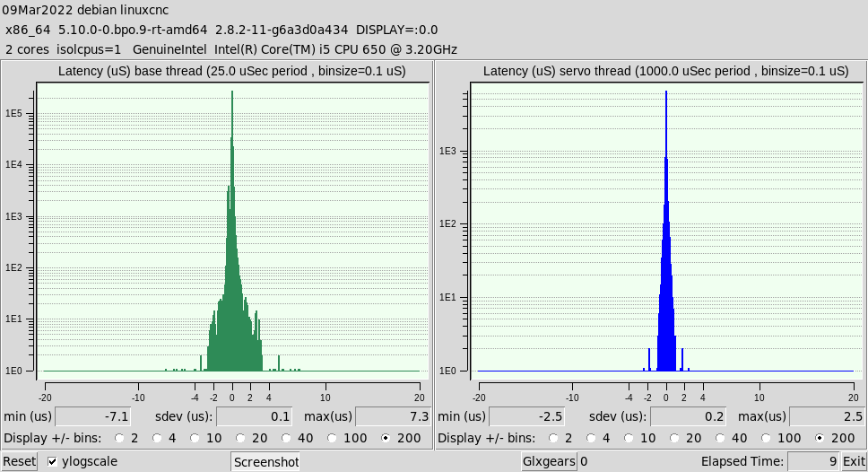

General info:
Dell Inc., OptiPlex 980
Bios version A18, dated 02/27/2018
Chipset: Intel Corporation 5 Series/3400 Series
Harddisk is non-rotational, ie. SSD
The amount of swap currently used is 0
CPU related data:
model name : Intel(R) Core(TM) i5 CPU 650 @ 3.20GHz
cpu cores : 2
stepping : 5
cache size : 4096 KB
RAM related data:
Maximum Capacity: 16 GB
GPU related data:
product: Core Processor Integrated Graphics Controller
configuration: driver=i915 latency=0
Parallel port related data:
number of parallel ports is 1
parport0: PC-style at 0x378 (0x778), irq 7 [PCSPP,TRISTATE,EPP]
Os and desktop related data:
PRETTY_NAME="Debian GNU/Linux 10 (buster)"
Should the info below not match with your machine,
kindly post the output of pstree here, including a brief
desciption of your desktop environment, window manager and
display manager. Tia
forum.linuxcnc.org/18-computer/39370-scr...-of-computer-latency
Desktop environment : gnome
Windowmanager : Xfwm4
Displaymanager : lightdm
Kernel related data:
Kernel 5.10.0-0.bpo.9-rt-amd64
GRUB_CMDLINE_LINUX_DEFAULT="quiet isolcpus=1"
Cpu idle driver: intel_idle
Kernel modules data:
Check if pcspkr is loaded: Yes, may cause bigger latency.
can be eliminated using:
sudo echo "install pcspkr /bin/true" >/etc/modprobe.d/pcspkr.conf
Check if snd modules are loaded: No, which is good!
Keyboard & Mouse related data:
Number of mice: 1
Mouse 0 : Logitech M570
Mice attached to USB:
Keyboards attached to USB:
LinuxCNC related data:
LinuxCNC version is: 2.8.2.11.g6a3d0a434
Preparing for latency test:
Started glxgears No. 1, 2, 3, 4, 5
Started firefox with 'vimeo.com/150574260', WID 27263123
Command for latency test is:
su linuxcnc -c "latency-histogram --bbinsize 1000 --base 25000 --sbinsize 1000 --nox 2>&1 | tee -a 1646751829.lat &"
Latency testing loop started 2022年 3月 9日 水曜日 00:04:07 JST,
should end after 2022年 3月 9日 水曜日 02:04:07 JST
Useless to proceed, read the relevant part in 1646751829.lat
>>>Unexpected realtime delay on task 0 with period 25000<<<
Swap useage: prerun: 0, running: 0
CPU core temperatures:
Core 0: Tmin: 45.0°C, Tmax: 61.0°C, (high = +89.0°C, crit = +105.0°C)
Core 2: Tmin: 40.0°C, Tmax: 59.0°C, (high = +89.0°C, crit = +105.0°C)
last latency data is as follows:.
249 secs base min: -14.600 uS max: 21.800 uS sdev: 0.200 uS
249 secs servo min: -10.100 uS max: 10.200 uS sdev: 0.600 uS
Hmmm. I don't know how to attach the result.
How do you paste it in a gray window?

Further, run the test again, but increase base to say 50'000. 50'000 is actually what I am using on my 980. Also check out my GRUB_CMDLINE_LINUX_DEFAULT (dig in this thread to find the last, best one. Further, doHow do you paste it in a gray window? use Block quote in advanced editor ( [ quote ] and [ / quote ] without the blanks)
It made some difference on my machine. In addition check out the colored parts in your output and compare them to what I have used. Ie.sudo echo "install pcspkr /bin/true" >/etc/modprobe.d/pcspkr.conf

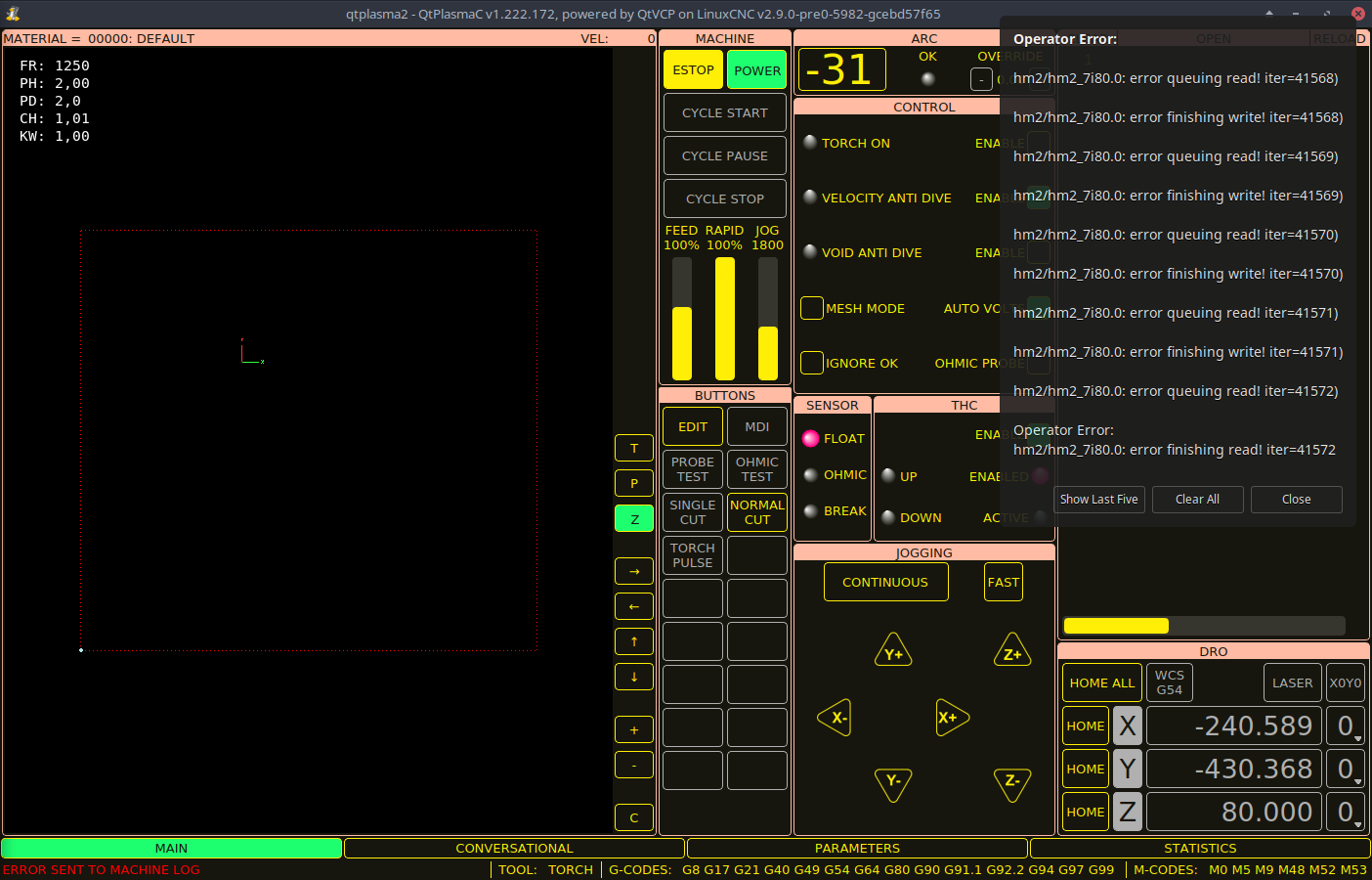

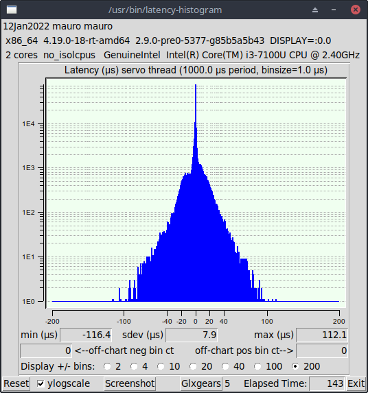

Thanks for bringuing this nuc here. I am getting intel nucs to test in about a month or two too only. I believe, a run with less than 3 minutes is rather short. also, it would be nice, if you could post the results of my script here. Just the .hw file is enough.
Regarding mesa problem, I think you might find answers or help in other threads.

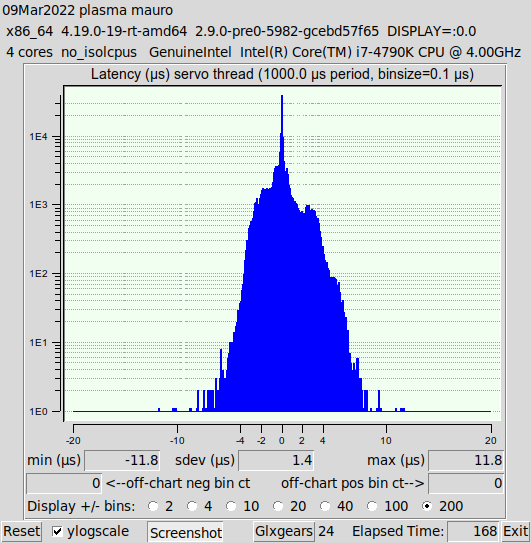

Thanks a ton. I need to upgrade the script urgently and your zip helps me doing just that. I intended to do a complete update, but like that, I think I'll release an intermediate version soon.
I'll post what you have included in your zip as a summary, completed with last latency data:
That seems to be a very good candiate, given, you still got room to improve. But I guess, tommlight would agree: good as it is now, no further improvments required. One caveat: The video stuff: Couldn't you see the vimeo video at all?LinuxCNC pc tests, version 20200930, started 10.03.2022 08:59:06
General info:
ASUSTeK COMPUTER INC., All Series
Bios version 2601, dated 12/08/2014
Chipset: Intel Corporation 9 Series
CPU related data:
model name : Intel(R) Core(TM) i7-4790K CPU @ 4.00GHz
cpu cores : 4
stepping : 3
cache size : 8192 KB
RAM related data:
Maximum Capacity: 32 GB
Maximum Voltage: Unknown
Maximum Voltage: 1.5 V
Size: No Module Installed
GPU related data:
product: Xeon E3-1200 v3/4th Gen Core Processor Integrated Graphics Controller
number of parallel ports is 0
Kernel 4.19.0-19-rt-amd64
GRUB_CMDLINE_LINUX_DEFAULT="quiet splash"
Check if pcspkr is loaded: No, which is good!
Check if snd modules are loaded: Yes, may cause bigger latency.
can probably be disabled in bios, alternatively, you can run
"./block-snd-modules"
which has just now been created for your convenience.
Number of mice: 1
Mouse 0 : Logitech USB Optical Mouse
Logitech, Inc. M105 Optical Mouse
Primax Electronics, Ltd HP PR1101U / Primax PMX-KPR1101U Keyboard
LinuxCNC version is: 2.9.0~pre0.5982.gcebd57f65
Started firefox with 'vimeo.com/150574260', WID 88080428
su mauro -c "latency-histogram --nobase --sbinsize 1000 --nox 2>&1 | tee -a 1646899127.lat &"
Latency testing loop started gio 10 mar 2022, 08.59.18, CET,
should end after gio 10 mar 2022, 10.59.18, CET
