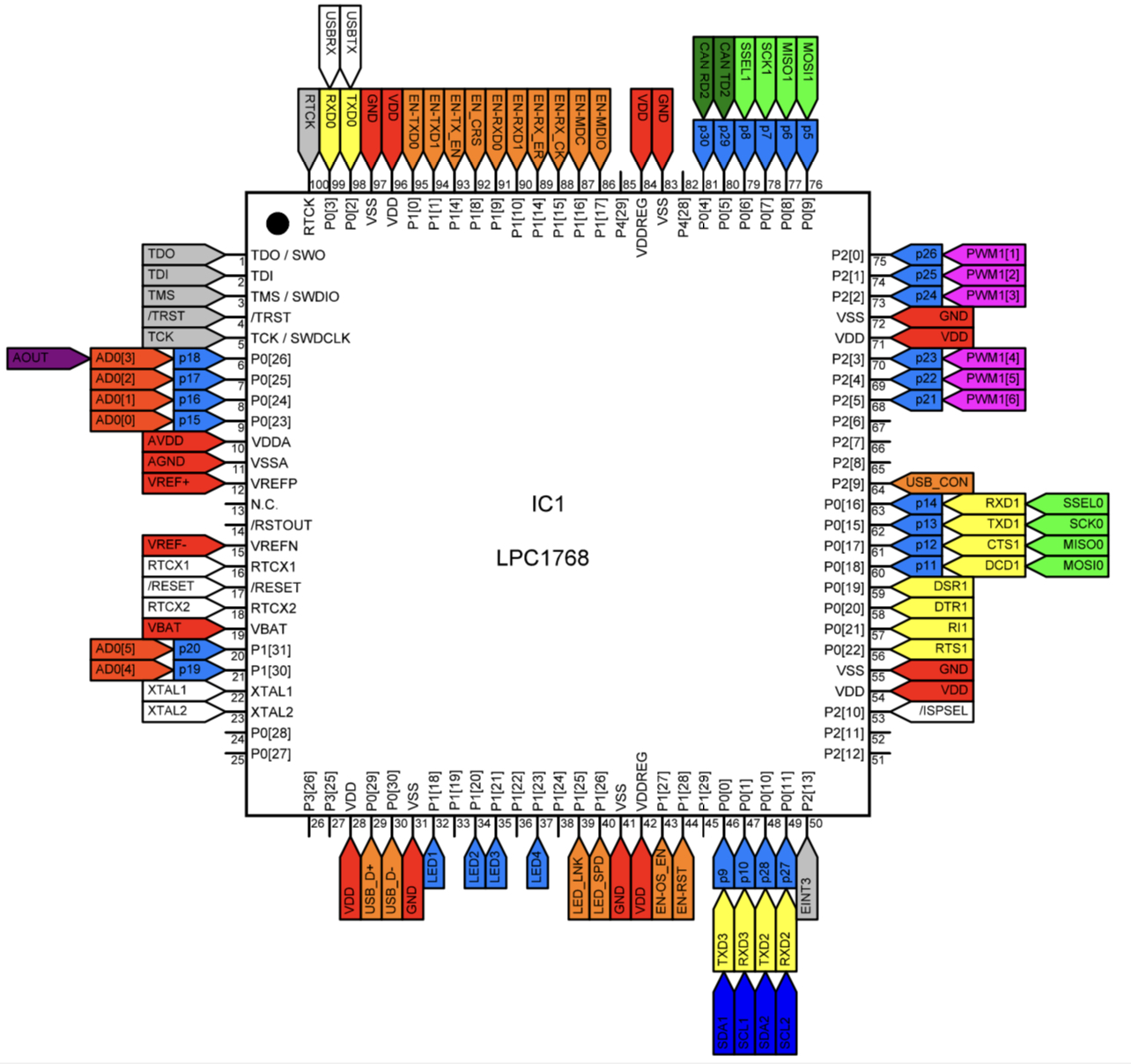

- scotta
- Posts: 959
- Thank you received: 489
06 Aug 2021 03:06 #217020
by scotta
BR
Scott
Replied by scotta on topic Remora - Rpi Software Stepping Using External Microcontroller via SPI
SPI comms runs at the Servo Thread frequency and it passes the required step frequency. All steps are generated in the Base Thread, which is the limiting factor.Most 3D printer board manufacturers don’t use the right pin mapping of the chip. The chip is using software pwm to generate steps if the pin is not hardware pwm. I’m trying to use P2.0 to P2.5 for step generation with good results.
The step generation limitation could come from the SPI communication too slow maybe.
BR
Scott
