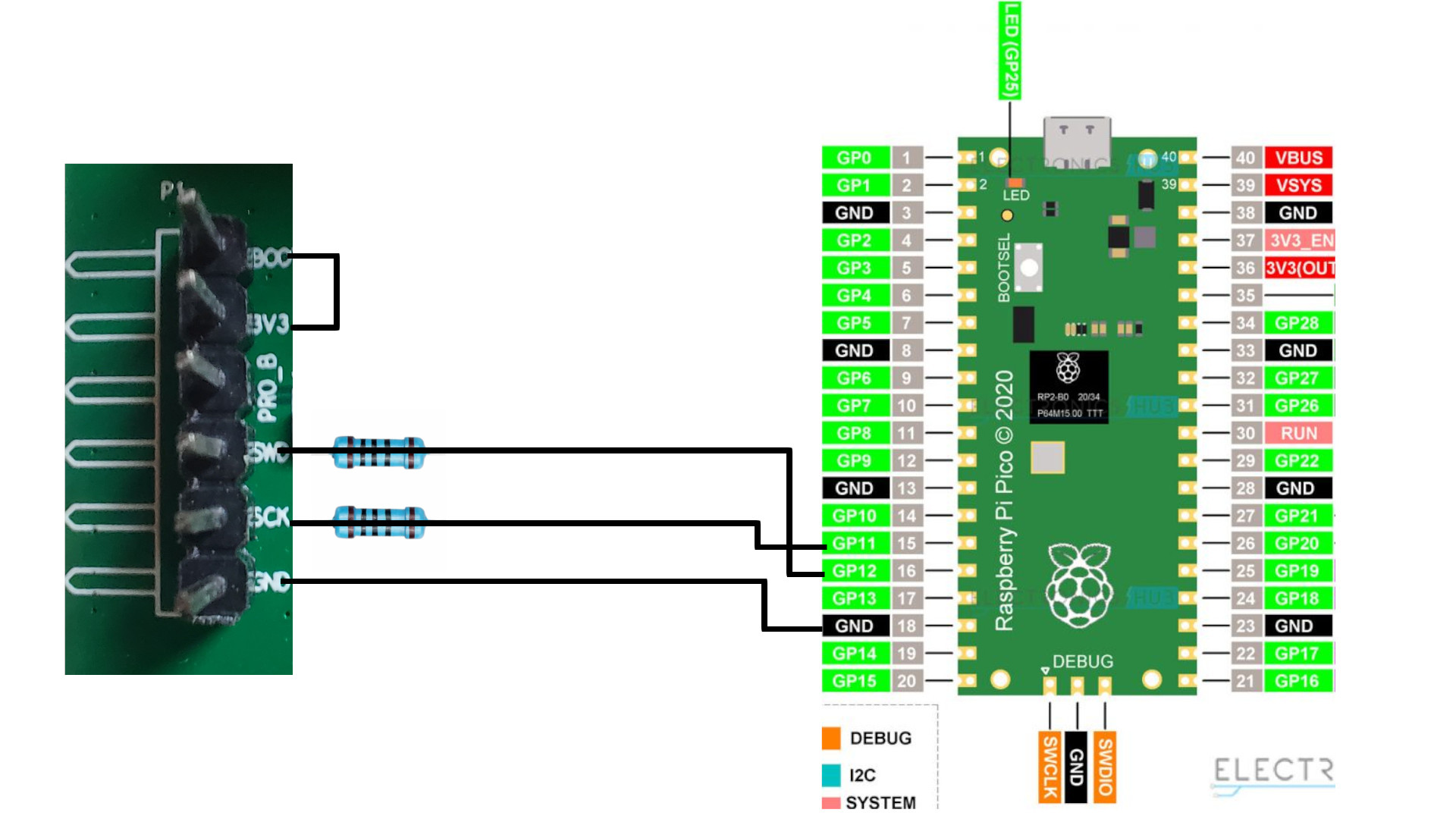

I'm still having a hard time flashing my EC 500 using the Pi Pico method.
I'vd flashed the pico with the free DAP binary from here github.com/ataradov/free-dap
When I do a lsusb I get this for the Pi:
Bus 001 Device 003: ID 6666:9930 Prototype product Vendor ID Combined VCP and CMSIS-DAP Adapter
This is the pinout provided by the free-dap binary
11 SWCLK/TCK
12 SWDIO/TMS
13 TDI
14 TDO
15 nRESET
0 VCP TX
1 VCP RX
2 VCP Status
25 (LED)DAP Status
This is how I connected the EC500 to the pico . The EC500 is powered and the BOOT and 3V pins on the board are bridged. I have a feeling that I'm missing something because in the @scotta videos the stlink is connected by 4 wires and I have only 3.
When I do pyocd flash ./remora-rt1052-1.1.0.bin --target mimxrt1050_quadspi -v
I get this error in the terminal:
Any ideas?

Did you powered the board. You need to connect "System GND and 24V" to a power supply.

Hmmm I’m not sure why your using resistors, my usb Amazon daplink works great and I don’t have to use resistors, have you tried without resistors? Your controller requires 24v at the power pins. I’ve seen instability using anything else such as 12v. Sometimes the firmware can get locked up or possibly you could have locked it up. So shorting boot to 3v3 I think pauses the boot loader before it loads the firmware that way you don’t get locked out by a bad firmware. Once you do a flash like that you have to remove the short turn the board off and back on and then flash it again. This has been my procedure, I’m not sure exactly why that’s so but that’s how I get myself out of a jam usually.

Yes, the EC500 is powered by 24V while trying to flash it, I'll give it some more tries then I think I'll try the ST-Link method. Do you think the original firmware needs to be erased before flashing the new one? I'll try the @GeramyL suggestions too. Thank you both

You shouldn’t need to erase it first, I would doubt it especially shorting the pins which should change the boot mode so it doesn’t boot the firmware that’s on the chip. Have you tried to do pyocd and list devices or open up the command interface to see if you get any sort of information out of the pi

I think you have to remove BOOT->3.3V jumper. Just tasted with jumper and i'm not able to flash.

Yes, I've only ever had to use the boot button or jumper when I've locked up the firmware with bad code or not being able to connect the debug probe.
