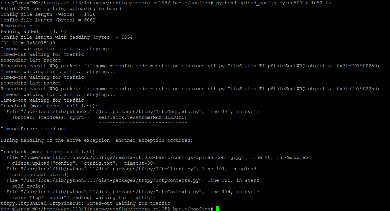

by scotta
No need to use tftp command line to upload the config file. Just use the python script. It will check that it is proper JSON and add the required header meta data before doing the tftp upload.
If your config file is called config.txt, then your command would be
python3 upload_config.py config.txt

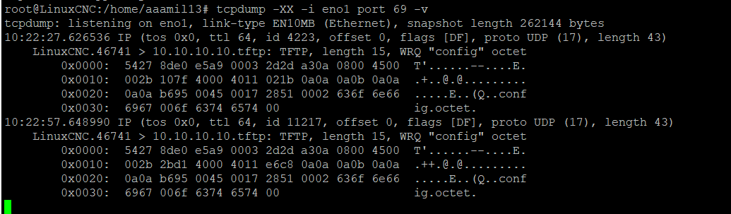

22 Sep 2023 14:47 - 22 Sep 2023 15:11 #281385
by aaamil13
Replied by aaamil13 on topic Remora - ethernet NVEM / EC300 / EC500 cnc board
open("/tmp/config.txt", "wb").write(config)
# Upload using TFTP, set large timeout
client = tftpy.TftpClient("10.10.10.10", 69)
client.upload("config", "/tmp/config.txt", timeout=30)
It's a TFTP which differs from FTP and TFTP is configured on port 69.
I have no steps forward, PyOCD communication is timed out, and even no debug info on ComPort. Flashed with remora-rt1052-1.1.0.bin and remora-rt1052-1.0.0.bin. Flash is OK, have ping to 10.10.10.10, but not able to upload configuration file and no ComPort. LinuxCNC communicates with EC500v5, I am able to Enable and start the board from LinuxCNC, but if i try to move Axis then popup "joint 0 following error". BOOT led sets on when i press enable on LinuxCNC.
I am not sure if debug ComPort is DB9 port on EC500 or have to use some other pins.
Do I have to enable TFTP by a special procedure ( short pin, some command or etc.) and is there a procedure to enable debug on ComPort
Thanks in advance
Thanks in advance

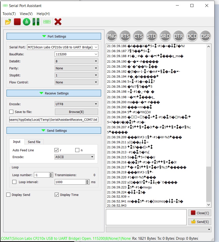

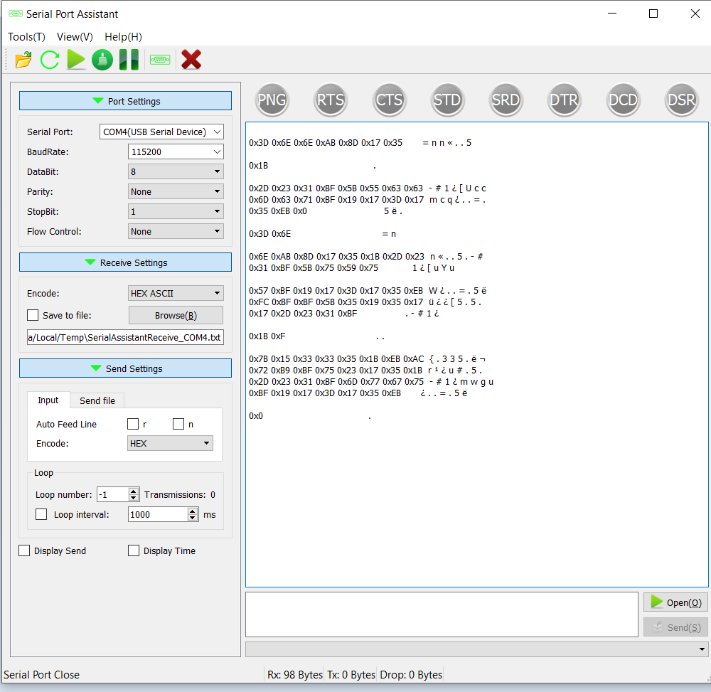

Finally got some success with ComPort. Debug port is the one with type DB9 on the board,
Pin 1 -> +5V
Pin 2 -> RXD
Pin 3 -> TXD
Pin 5 -> GND
But the levels are not RS232. these are 5V TTL logic levels.
I have some kind of data but it is not readable for now.
Baud ->115200, Parity -no, DataBits - 8 , StopBits 1,
Firmware -> remora-rt1052-1.0.0.bin
Board EC500v5
When i try to Upload my config.txt there is some text on Debug port, but unfortunately can't read it.
EC500 has RS232 voltage levels, Pin 3 is TX and should be connected to PIN 2 on the computer side . Baud ->115200, Parity -no, Data Bits - 8 , Stop Bits 1.
Pin 2 -> RXD
Pin 3 -> TXD
Pin 5 -> GND
Board EC500v5
Last edit: 31 Aug 2024 19:59 by aaamil13.

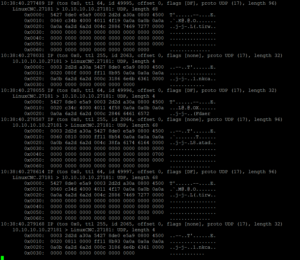

22 Sep 2023 22:10 #281414
by scotta
The latest firmware is v1.1.0, but this only added encoder support.
I'd try ascii encoding setting on your receive to see if that helps.
For the TFTP, are you going through a router or direct connection between computer and controller board?
Have you tried monitoring the eth0 with wireshark to see if any response packets are coming from the board?
During the TFTP transfer, the controller board threads are stopped. If the upload fails you would still need to power cycle the board to get everything back and running. On a successful upload this happens with a software reset of the board.

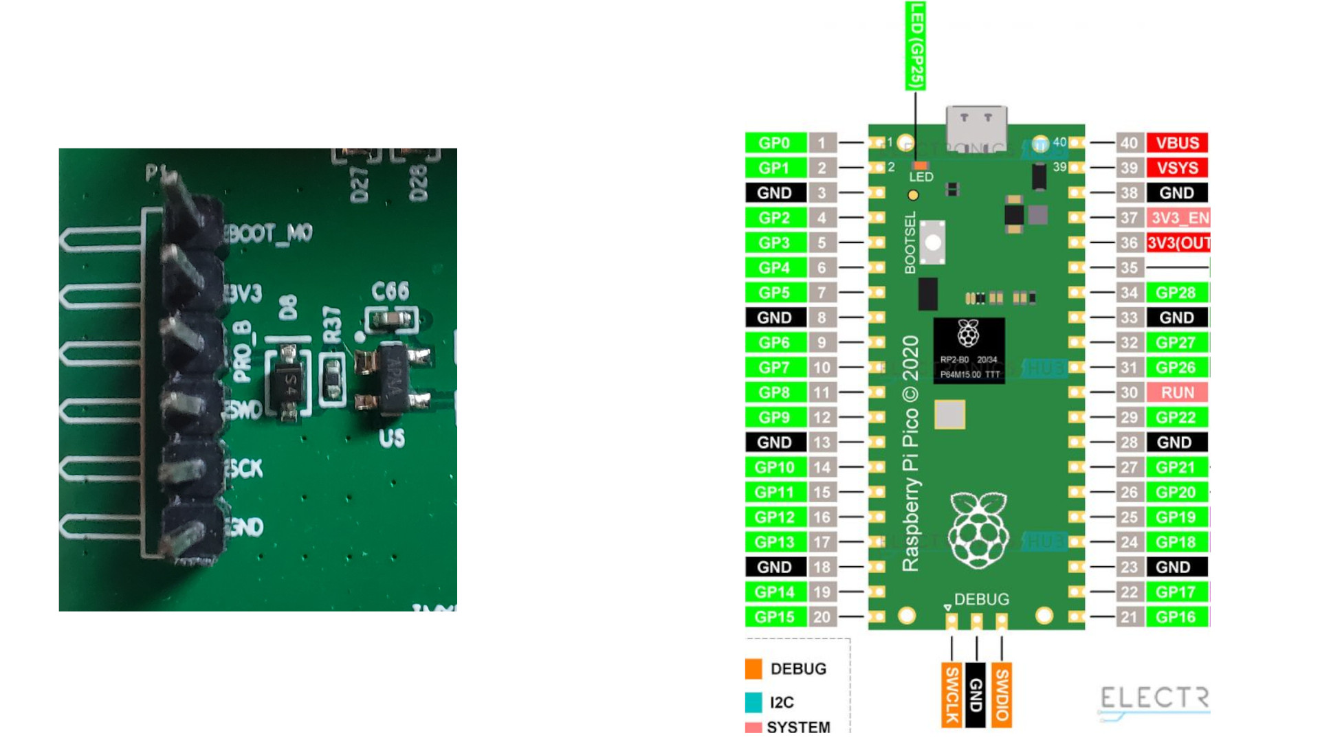

- oficinerobotica
- Posts: 47
- Thank you received: 12
23 Sep 2023 04:58 #281432
by oficinerobotica
Replied by oficinerobotica on topic Remora - ethernet NVEM / EC300 / EC500 cnc board

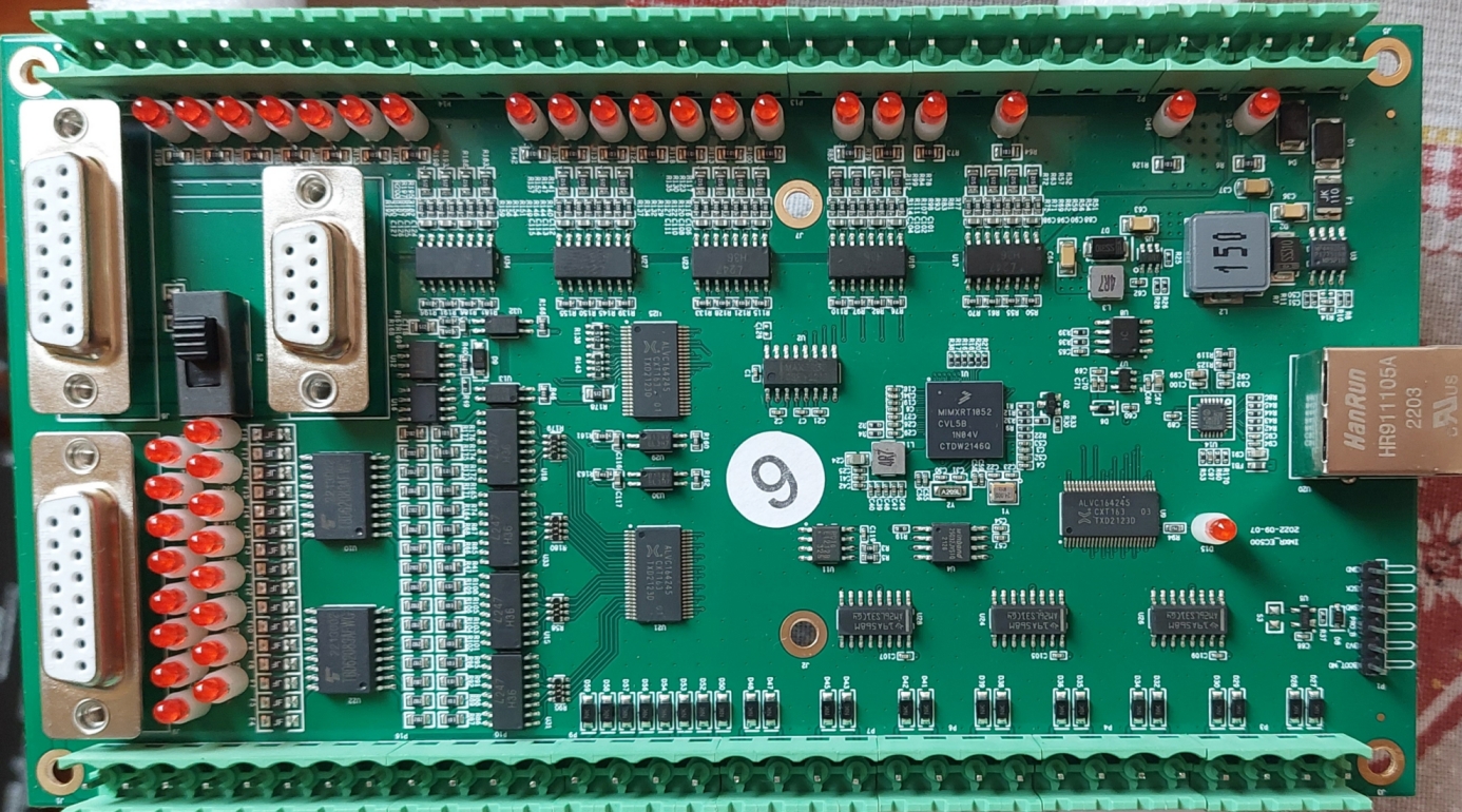

First of all I just don't know how I can thank enough you guys for the tremendous work. I love mesa cards just like anybody else here but given the availability and cost to importing them in certain parts of the world, blowing one like I did can become a costly mistake.
I just received my ec500 card but I don't know how to identify what version it is.
I would like to flash it using a Pi Pico using this instructables "cmsis-dap-v2" programmer as i understand that it could be the easiest way to do it afterall. www.instructables.com/CMSIS-DAP-V2-Progr...With-Raspberry-Pi-P/
Can somebody please help me with the connection between the pi and the ec500? I'vd read the whole thread twice and watched Scotta's videos but it is still not clear to me.
P.S. @scotta .... where can I donate?

- aaamil13
- Posts: 10
23 Sep 2023 07:59 - 23 Sep 2023 11:11 #281443
by aaamil13
I have no experience with RPI, but you have to connect GND, SCK->SWSCK(GPIO_11), SWD->SWDIO.(PGIO_12)
If you want to use debug port, you have to connect to an adapter USB -> RS232_TTL, or you can use RX pad on the same RPI board and connect RX to DB9_Pin3 on EC500 board ( RPI_GND to DB9_5 pins too).
You must connect 24V to SYSTEM on EC500 to able to flash. If you are going to use PyOCD -> pyocd flash ./remora-rt1052-1.1.0.bin --target mimxrt1050_quadspi -v. It takes some time to flash the board. Your EC500 is V5, which uses mimxrt1052cvl5b MCU.
