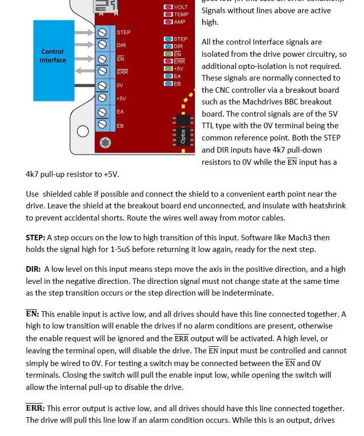

Hi everyone
-For my EC500 V5
I was able to flash my board and upload the config. I think my hal, config and component are ok in linuxcnc. I can come out of estop and the serial data look all right. My motors don't move and no error is reported in linux but the dro is changing. I have DC servo and I think my drive need the pulse to be positive low to high.
1- Does the EC500 output the pulse correctly for my drives?
2- I took the nvmpg.c component in the nvem directory, is this ok ? Not sure I have the right one
-I also own a EC500 V3 STM32F407
3-Do I have to compile the code myself to put remora on it? I don see any .bin file in the EC500 STM32 repo
4- I think no new feature gonna be added to this on but . I know the RT1052 is faster but is there other differences I need to be aware
Thank you Scott for your great work, this project is awesome
Drive documentation

1. you may need to change the modifier in your config file to something like PULL UP or PULL DOWN
2. , just install both github.com/scottalford75/Remora-NVEM/tre.../LinuxCNC/Components
3. , no its provided as a hex file github.com/scottalford75/Remora-EC500/tree/main/Firmware
4. the 1052 has encoder support aswell as dma stepgen
@aol, i think thats something with the new debian install. other users have that issue, unrelated to linuxcnc im fairly sure . you might have to google search to find it.
@raf, it would be more than helpful to compile all the knowedge you have required into some official documentation. remora-docs.readthedocs.io/en/latest/ , it would be very helpful. im sure we would all appreciate it.

How have you wired your drive to the EC500? The EC500 has differential outputs, where your drive has single ended so you will need to pick up a ground and just use one side of the differential pair. You should be able to get it to work. Start with the default config so you don't have issues with step length.
For your SMT based EC500. The firmware is here github.com/scottalford75/Remora-EC500/tree/main/FirmwareHi everyone
-For my EC500 V5
Drive documentation
