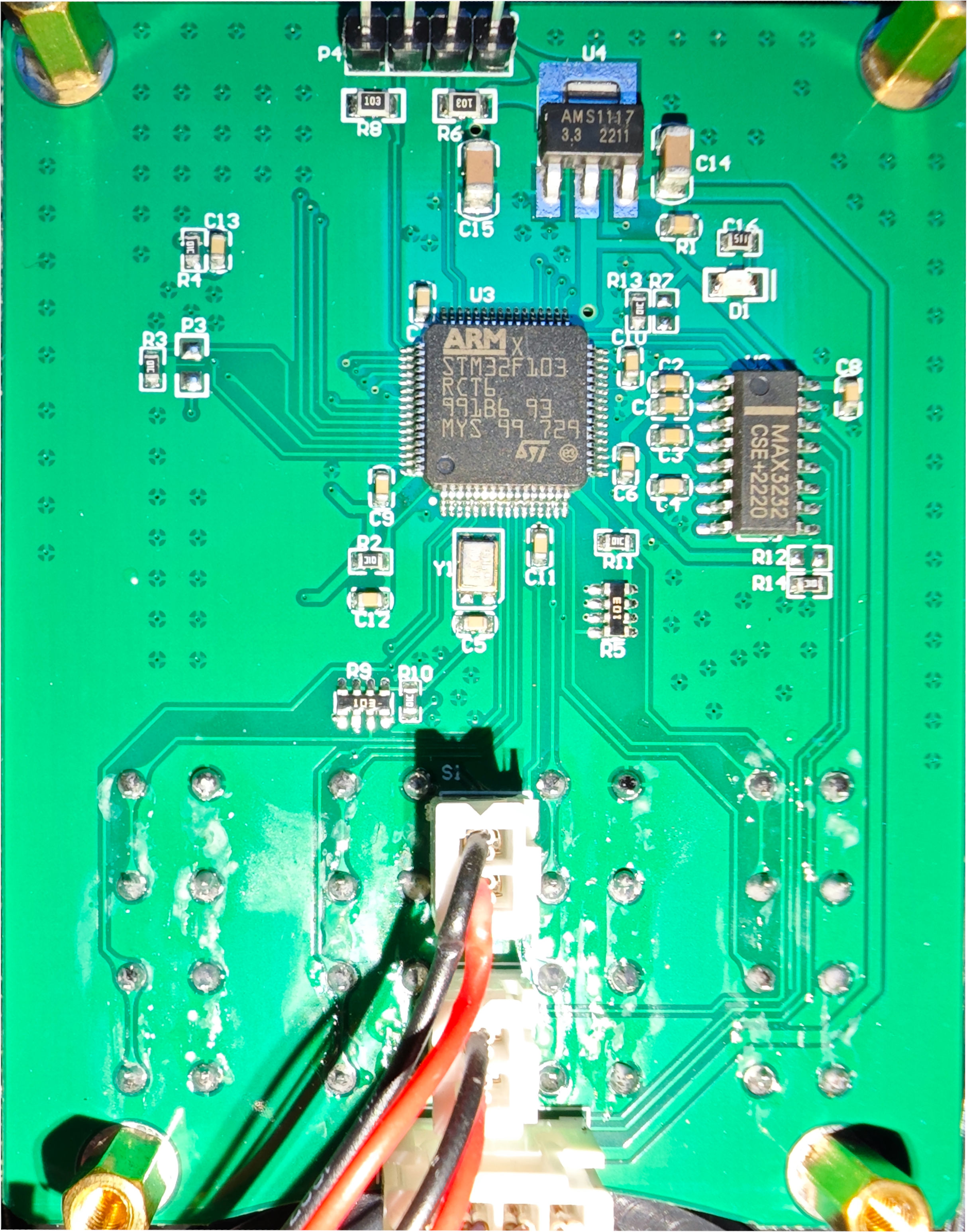

I believe that protocol may be a little different. I connected NVMPG trough uart and I can see button presses, but I can't seem to update the screen or PING NVMPG with the data calculated using spreadsheet from scotta
forum.linuxcnc.org/18-computer/44828-rem...oard?start=30#233498
In the end NVMPG sends key presses and rotation correctly. I guess the problem is between EC500 TX and NVMPG RX.
EDIT: I Made a photo of the board. Looks like there is JTAG exposed, maybe it would be possible to dump the firmware and compare with working one.
