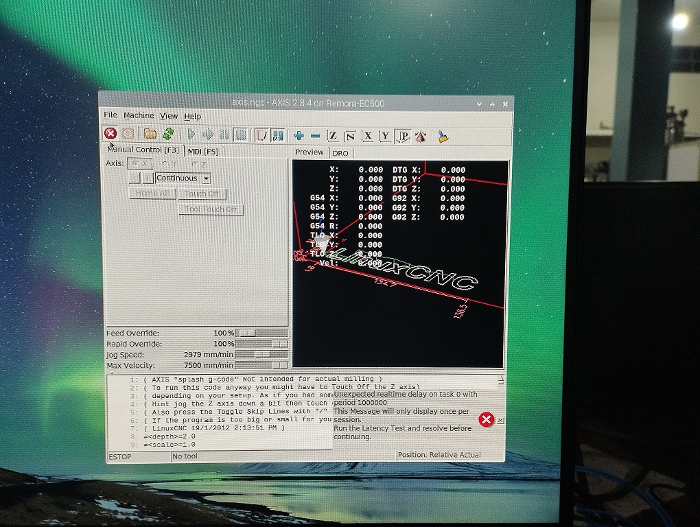

I am currently doing a project with EC500_v5 using remora firmware. I have flashed the controller board with the remora firmware and have done all the necessary steps mentioned in the remora documentation. When I faced certain problems, I had refered this forum and I could solve those issues on my way, Now I am able to open the LinuxCNC, but I am not able to come out of the e-stop. I am adding all the steps that I had done till now. I would like to get some help from this community for solving this problem.These are the steps that I had followed. I would like to know whether I have done anything wrong in this. I am new to LinuxCNC and trying to learn more about it. So sorry if I ask silly questions.
remora-nv: dlopen: /usr/lib/linuxcnc/modules/remora-nv.so: cannot open shared object file: No such file or directory
./remora-nvem.hal:9: waitpid failed /usr/bin/rtapi_app remora-nv
./remora-nvem.hal:9: /usr/bin/rtapi_app exited without becoming ready
./remora-nvem.hal:9: insmod for remora-nv failed, returned -1
1798
Hope to get a help on this.

Replied by Aravind on topic Remora - ethernet NVEM / EC300 / EC500 cnc board

- Error:
Debug file information:
- Error:
1798

Attaching the image of Linuxcnc window
- cakeslob
- Posts: 927
- Thank you received: 280
17 Feb 2024 13:18 #293642
by cakeslob
Replied by cakeslob on topic Remora - ethernet NVEM / EC300 / EC500 cnc board
Hmm, that selenium is a new one
install this component
github.com/scottalford75/Remora-RT1052-c...omponents/Remora-eth
change this line in your config
github.com/scottalford75/Remora-RT1052-c.../remora-ec500.hal#L9
change it to this
It looks like all the configs except one are calling for remora-nv, anyone wanna do a PR to fix it?
change it to this
loadrt remora-eth-3.0 PRU_base_freq=500000It looks like all the configs except one are calling for remora-nv, anyone wanna do a PR to fix it?
The following user(s) said Thank You: Aravind

Thanks for your reply.
Well I tried these steps, installed remora-eth-3.0.c and edited the file remora-ec500.hal line 9 . And I rebooted my board.
But now when I try to open linuxcnc > remora-ec500, it is showing the board is unreachable. And when I try to ping 10.10.10.10. it is showing Network is unreachable.
Previously I was able to open Linuxcnc and when I tried to exit e-stop the Red LED light near to the ethernet port was blinking. Now it is not there. I don't understand what happened. Did I missed any step?
Kindly help me to solve this issue.
Edit:
[SOLVED]
The issue got resolved when I reinstalled the RPI4 image and do all the steps again with the above mentioned step.
Thanks Cakeslob. Thanks all for your support.

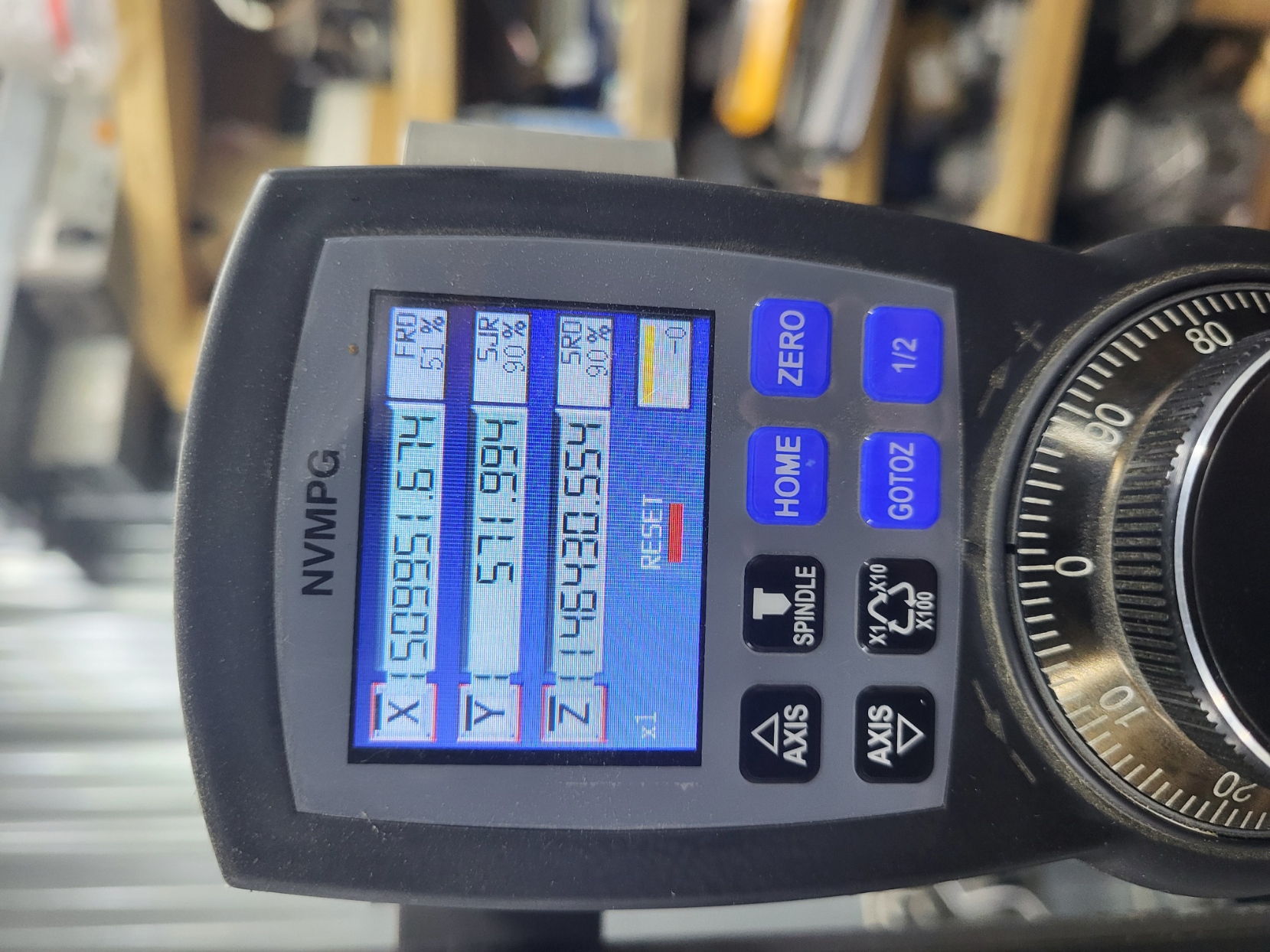

I was able to flash my 2 boards and make my servo motors work with them with the DMA config:
EC500 RT1052 & EC500 STM32F407
But I have differents problems with both boards:
-My NVMPG work great on the STM32 but on the RT1052, I dont have any update on the display, is there differents components or files somewhere. The inputs and encoder are all working but nothing change on the display, it stuck at X0 Y0 Z0 while axis is moving. Maybe I also have a bad MAX3232 chip on my board, anyone know how to check this.
I before had these weird values (attached picture) but after reflashing the board everything is at 0
I use the same NVMPG on the 2 controllers for my tests, It's probably the the STM32F103RCT6 chip inside, I bought it 5 years ago.
-My other issue is with the STM32 board, I cant get the spindle 0-10V working, It's stuck at 9.7V and this was working in Mach3 . On my RT1052, it work fine and I use the same HAL spindle commands.
Any help would be really appreciated.
