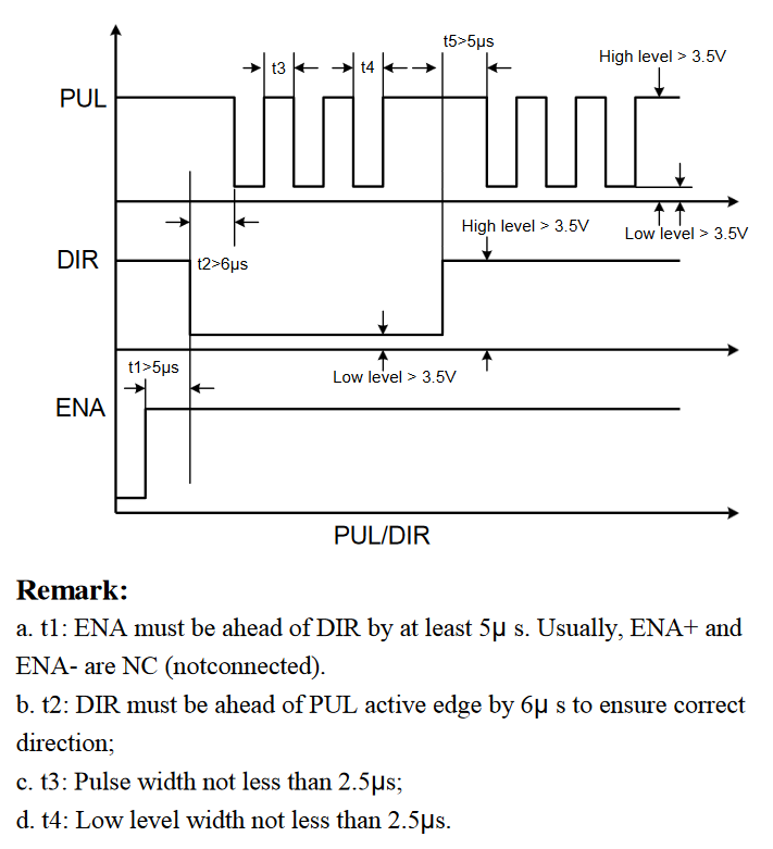

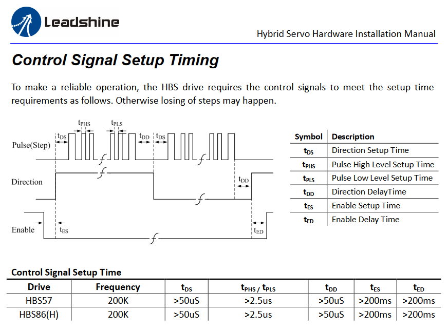

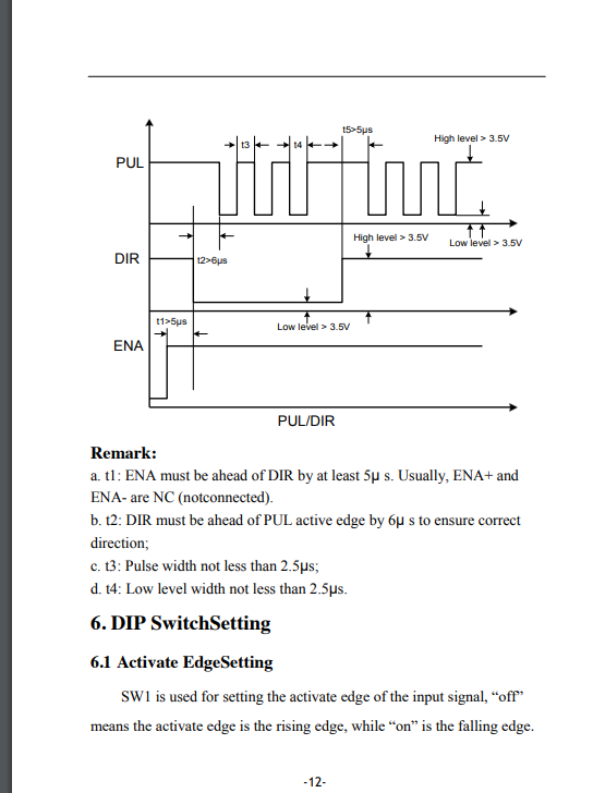

thank you for mentioning the manual for timing. These HBS860H drive/stepper arrangements are commonly available although the manual is not easily obtained; I have asked the supplier again. The drive appears to be a clone of the Leadshine HBS86H drive and documentation is more readily available for those, although conflicting in data.
hardware-cnc.nl/images/PDF/ACT/HBS86H_English_Manuel.pdf
www.machsupport.com/forum/index.php?acti...40069.0;attach=51122
Please see images of two versions of the pulse timing attached.
In one the DIR goes low during the STEP while in the other the DIR goes high.
I am suspecting that I have STEP/DIR timing issues and so I would like to understand what form of signal the Remora EC300 is producing and can it be modified to suit a particular drive?
The HBS680H drive form can be changed between rising and falling, by an RS232/RJ12 cable and software, but I would first like to better understand the EC300 STEP/DIR output undr Remora.
In the image with the table and diagram tPHS and tPLS are clearly "Step Length" and "Step Space".
Is tDS the "Dir Setup"? Is tDD the "Dir Hold"?
Is the EC300 active high for the STEP/DIR?

The dir signal is most likely high for one direction and low for another

27 Feb 2024 16:44 #294610
by TimGow
Thank you for your time.
I have bought a low-cost logic analyser with fx2lafw firmware and I hope to utilise the open source sigrok software with ‘Stepper motor’ protocol decoder, to verify my EC300 step/dir timing and rising/falling sense.
It will be interesting to verify the timing that was set in the config.txt.
