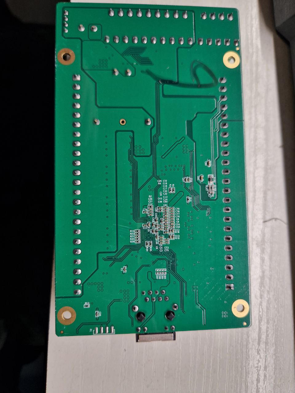

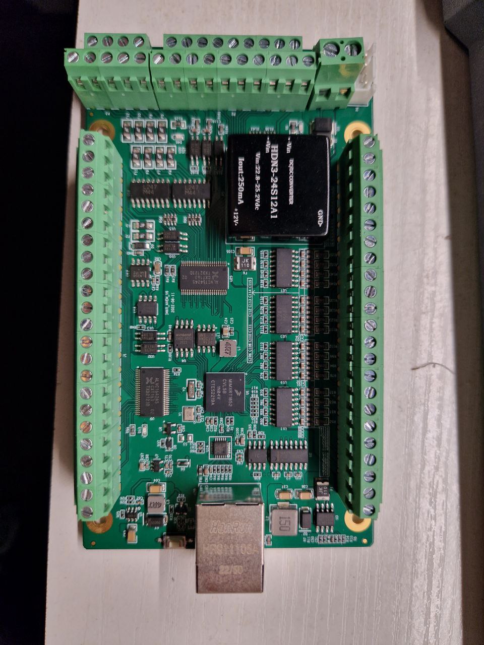

I went through a lot of post on this forum thread, but I'm not able to find the schematics for the EC500. Does anyone have a reverse engineering version of the PCB schematics? Thanks!

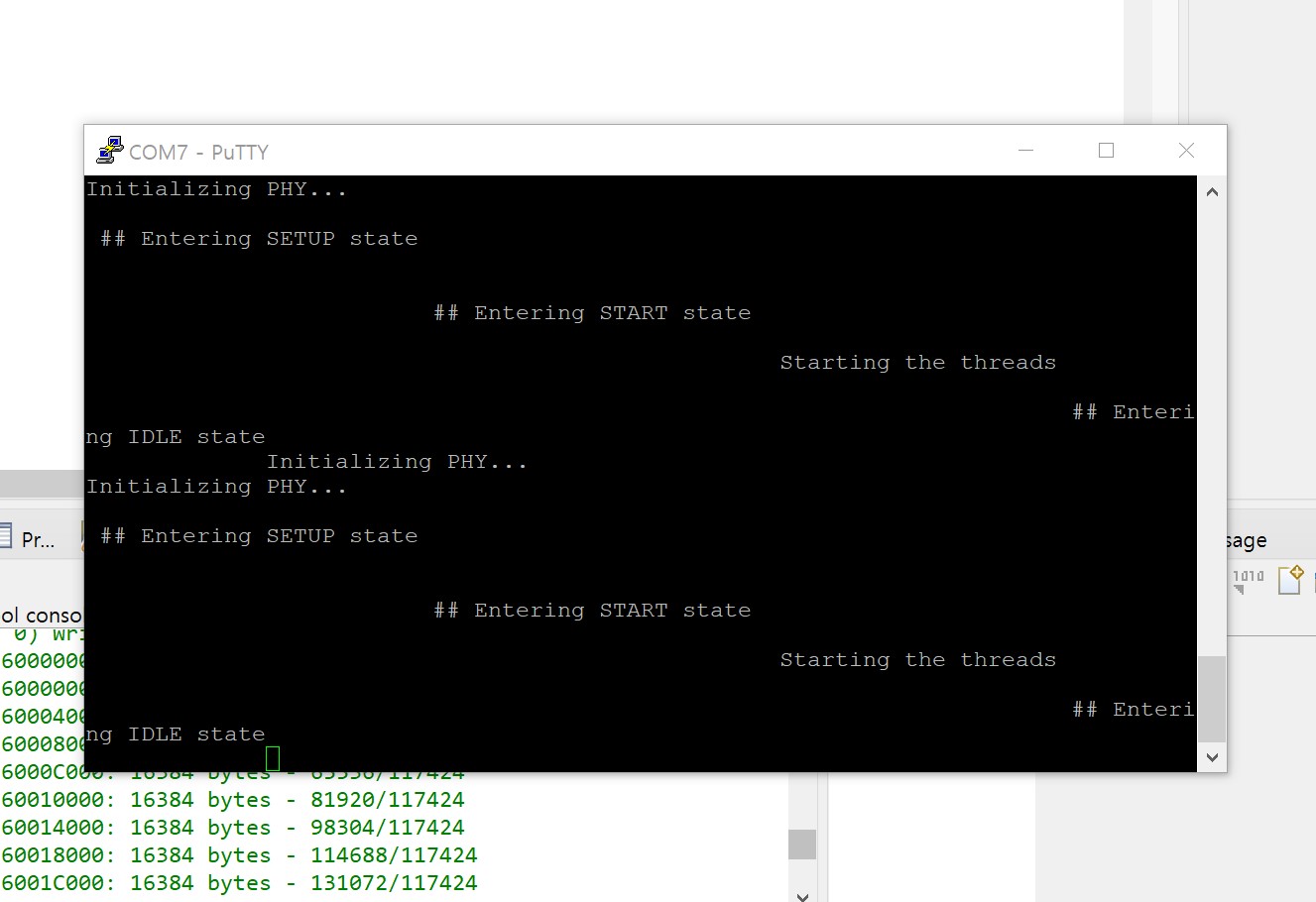

I need help about downloading config.txt to nvem v5.
I succeeded in downloading renoma nvem-rt1050 throw MCUXpresso IDE.
and received ping from nvem like below.
However, if I try to send config.txt, a timeout occurs.
As I see the letters in the temianl as below, I think the firmware was well put, but I don't know why it's not working.
[code]cnc@raspberrypi:~/linuxcnc/configs/remora-nvem-basic$ ping 10.10.10.10
PING 10.10.10.10 (10.10.10.10) 56(84) bytes of data.
64 bytes from 10.10.10.10: icmp_seq=1 ttl=255 time=0.443 ms
64 bytes from 10.10.10.10: icmp_seq=2 ttl=255 time=0.143 ms
64 bytes from 10.10.10.10: icmp_seq=3 ttl=255 time=0.141 ms
^C
--- 10.10.10.10 ping statistics ---
3 packets transmitted, 3 received, 0% packet loss, time 2029ms
rtt min/avg/max/mdev = 0.141/0.242/0.443/0.141 msHowever, if I try to send config.txt, a timeout occurs.
[code]cnc@raspberrypi:~/linuxcnc/configs/remora-nvem-basic$ python3 upload_config.py config.txt
Valid JSON config file, uploading to Novusun board
Config file length (words) = 134
Config file length (bytes) = 535
Remainder = 3
Padding added = [0]
Config file length with padding (bytes) = 536
CRC-32 = 0x2bf84f80
Timeout waiting for traffic, retrying...
Timed-out waiting for traffic
resending last packet
Resending packet WRQ packet: filename = config mode = octet on sessions <tftpy.TftpStates.TftpStateSentWRQ object at 0x7fa39536d0>
File "/home/cnc/.local/lib/python3.11/site-packages/tftpy/TftpContexts.py", line 171, in cycle
(buffer, (raddress, rport)) = self.sock.recvfrom(MAX_BLKSIZE)
TimeoutError: timed out
During handling of the above exception, another exception occurred:
File "/home/cnc/linuxcnc/configs/remora-nvem-basic/upload_config.py", line 72, in <module>
client.upload("config", "/tmp/config.txt", timeout=30)
File "/home/cnc/.local/lib/python3.11/site-packages/tftpy/TftpClient.py", line 101, in upload
self.context.start()
File "/home/cnc/.local/lib/python3.11/site-packages/tftpy/TftpContexts.py", line 325, in start
self.cycle()
File "/home/cnc/.local/lib/python3.11/site-packages/tftpy/TftpContexts.py", line 174, in cycle
raise TftpTimeout("Timed-out waiting for traffic")
tftpy.TftpShared.TftpTimeout: Timed-out waiting for trafficAs I see the letters in the temianl as below, I think the firmware was well put, but I don't know why it's not working.

solved problems.
rebuilt and downlaod :
github.com/scottalford75/Remora-RT1052-cpp
and upload_config.py config file :
github.com/scottalford75/Remora-RT1052-c...xCNC/nvem-rt1052.txt
and board is working.
