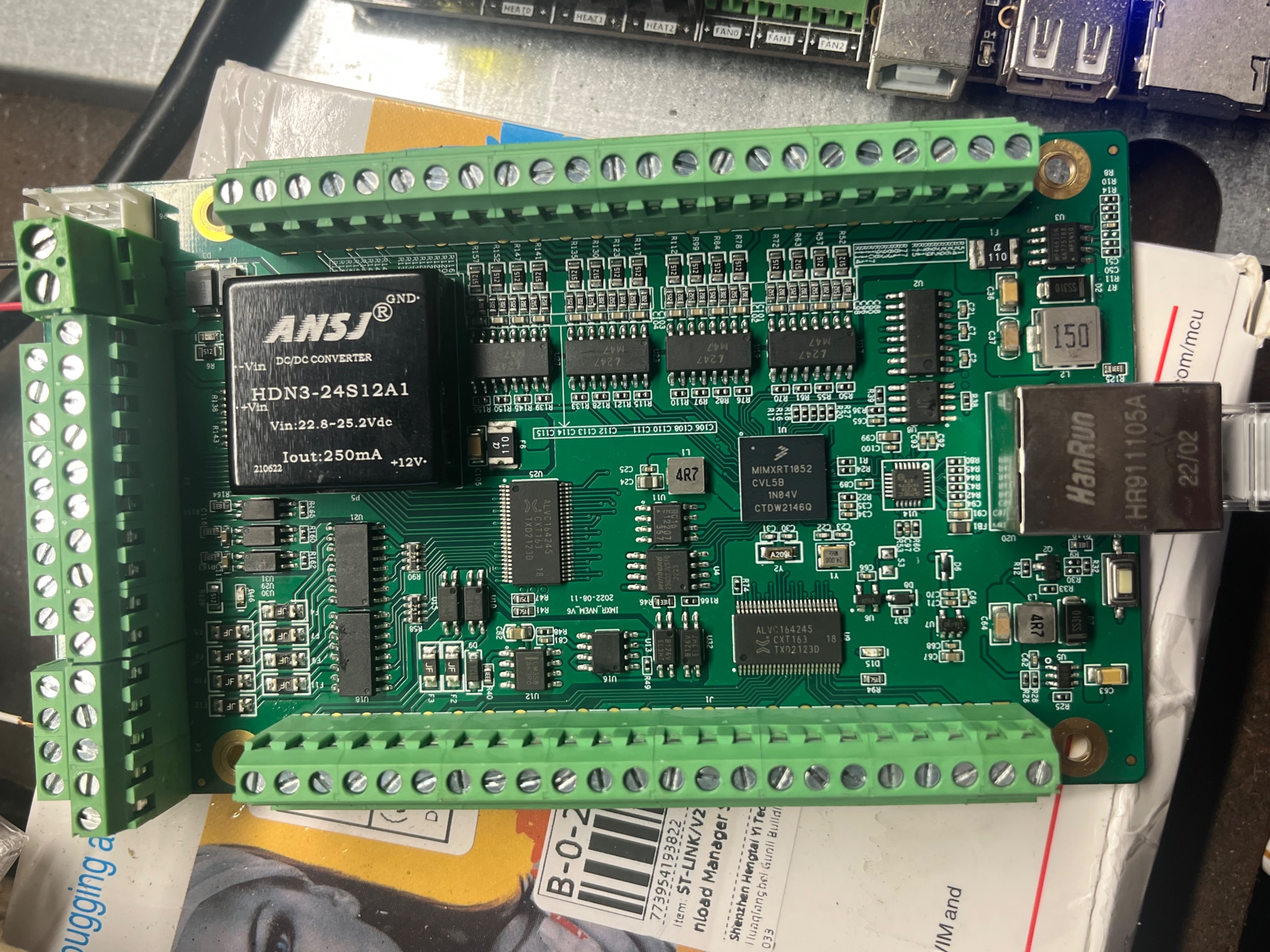

13 Oct 2024 13:57 #312002 by Tertech
Hello everyone!
I've been reading the forum for a while now!
I successfully installed rt1052.bin on ec300.
Linux is connected, Ethernet led lights up, connected.
But due to the MPG error I wanted to upload the new fixed bin. 3.1.3.
But I got these two errors.
Does anyone know the solution? Some have already run into this.
E Error during motherboard assembly: [session]
0000984 C No ACK received [__main__]
13 Oct 2024 21:30 #312024 by Tertech
Whoops!
Ec300 Motherboard push button switch. Reset
Turn it off, press and hold the button, reset the switch when you turn it on.

21 Oct 2024 17:32 #312803 by p0ulp75
Hello everyone I'm done trying to have my ec300 to work properly on mach 3 and I've already ordered a mesa card to get my mill running, anyway I really appreciate ll the work you be done on this project and would like to give a try at remora firmware, at least for learning purpose.
My board is a ec300 with the rt1052 chips on it, and I can't find the pin diagram for connecting the debug probe to flash it ?
I could only find the double stlink flashing method so far.
