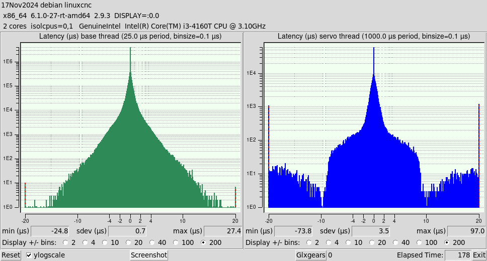

- Posts: 11
17 Nov 2024 10:15 #314650
by LabOuest
Replied by LabOuest on topic Remora - ethernet NVEM / EC300 / EC500 cnc board
Hello again,
I'm struggling with the infamous following error when I try to go faster than about 2300mm/min.
I'm running my steppers at 1000 steps/mm as is required by my application.
I've read through this topic and the stepper tuning doc but I can't seem to figured it out.
Does my servo thread latency matters ?
I'm still running the default configs beside the JOINT SCALE set to 1000.
I was also thinking that this issue could be due to the default signal timing being to long for remora to keep up.
How and where do I configure the stepgen timing with remora ?

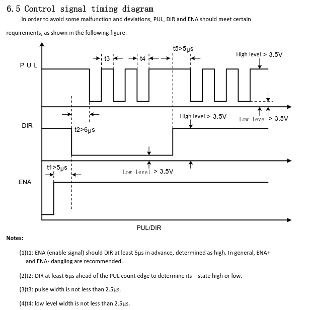

See the attached timing requirements for my drivers.

The latency is already high after such a short amount of time without running glxgears, so the latency might be the cause if it goes higher during operation. Isolating all cores makes no sense, you should always have one available for the system to run its tasks on. It won't hurt to try to find better settings in the bios and kernel parameters.
Network latency can also be a cause, pinning the Ethernet irq to the isolated core can help.

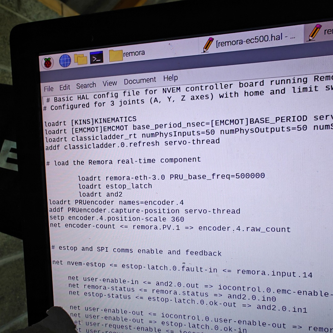

Does this look ok to get the encoder PV1 counting? PV1 should be the MPG socket. I don't know if I have a hardware issue or code issue. Also does the nvmpg.so need to be compiled first? I'm using an adum1200 to bypass the opticouplers. PV1 does not count when I move the encoder in Halshow

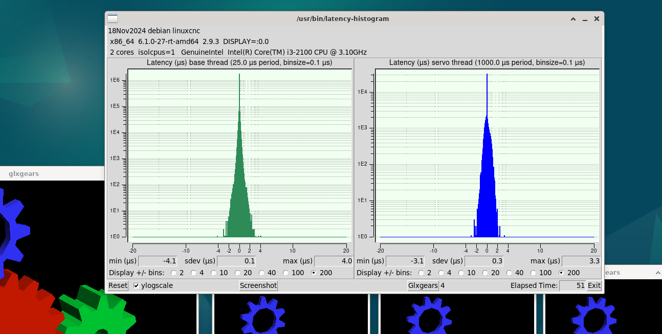

I borrowed an old pc with a very low latency of about 3-4us (still steady after 1300sec)
Unfortunately, I'm not getting any improvement, I'm still getting a following error above 2300mm/min (~38KHz)
There must be another limiting factor somewhere else, how can I improve my troubleshooting method ?
Did anyone achieve a step rate higher than 38KHz with a similar setup ?
As Royka suggested, I've tried to increase the servo period, without success. (Though, lowering it definitely makes things worse)
Also, how can I make sure that the default stepper timing are correct ?
Attached to this post, you'll find my config.
