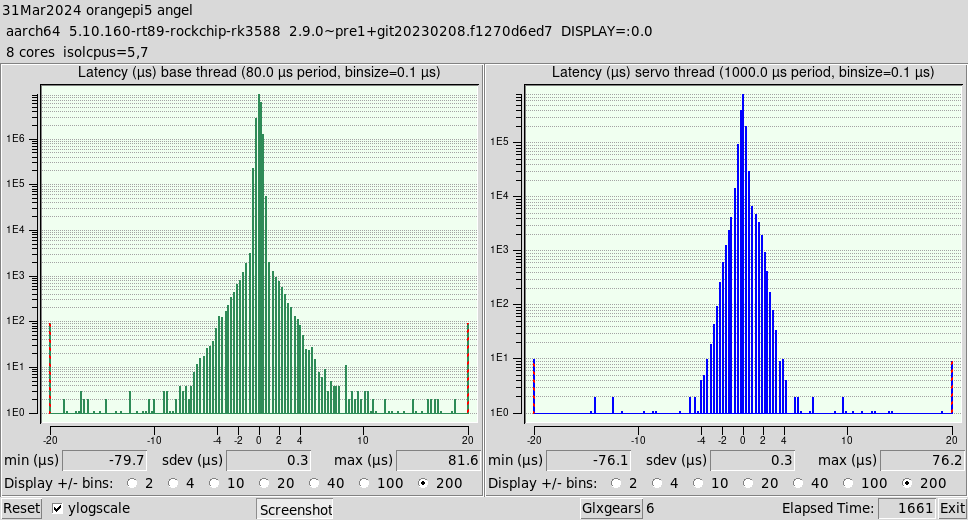

I am trying to run Linuxcnc on OPI 5 and I get a latency of 75 - 85 us, I am using kmike's image mega.nz/file/UCMhiZgZ#Qdg-e3CaQBDQQXQ0rN3...dNJfphJSckes99q7FAR8.
I tried to use royka's image at mega.nz/folder/78Z3UbRD#Pl8DdWmxLF3CDma21An8gQ for debian bookworm but it didn't start.
I added extraargs="isolcpus=5,7" in the armbianEnv.txt file, and it looks like I am running linuxcnc with realtime kernel.
The error I got on first boot:
ln: failed to create symlink '/boot/uInitrd': Operation not allowed.
update-initramfs: Symlink failed, moving /boot/uInitrd-5.10.160-rt89-rockchip-rk
3588 to /boot/uInitrd
renamed '/boot/uInitrd-5.10.160-rt89-rockchip-rk3588' -> '/boot/uInitrd'.
update-initramfs: Armbian: done.
I don't know what it means.
Any ideas or suggestions to improve latency?

@angelnu Sorry a bit of a late reply, but in the screenshot you sent, it shows "no_isolcpus" which indicates that you didn't isolate any CPU.
It seems like something went wrong with adding the following line to armbianEnv.txt:
extraargs=isolcpus=5,7

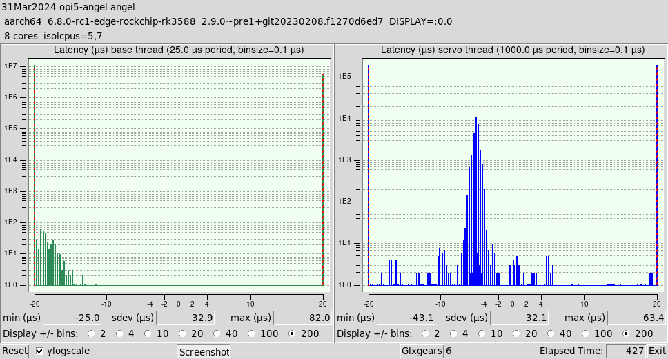

31 Mar 2024 16:40 #297294
by angelnu
With the image of armbian kernel 6.8.0-RC1-edge, without real time but with isolcpus = 5.7. Something better in Servo Thread behaves, I have a Orange Pi 5.
Replied by angelnu on topic Can the OPI5 be Configured to Run LCNC?
I have tried it later with isolcpus 5.7 and I do not get other difference. With the image of kmike: Kenel 5.10.160 RT and ISOLCPUS = 5.7.@angelnu Sorry a bit of a late reply, but in the screenshot you sent, it shows "no_isolcpus" which indicates that you didn't isolate any CPU.

That's strange, maybe you can try this kernel on another image:
drive.google.com/drive/folders/1JglCIPKv...roZcjOvr?usp=sharing
I'm using this kernel with the Debian Bookworm Image from the site of Orange Pi and HW acceleration works, although while watching YouTube videos the latency increases a bit, but not so much as yours for sure.
