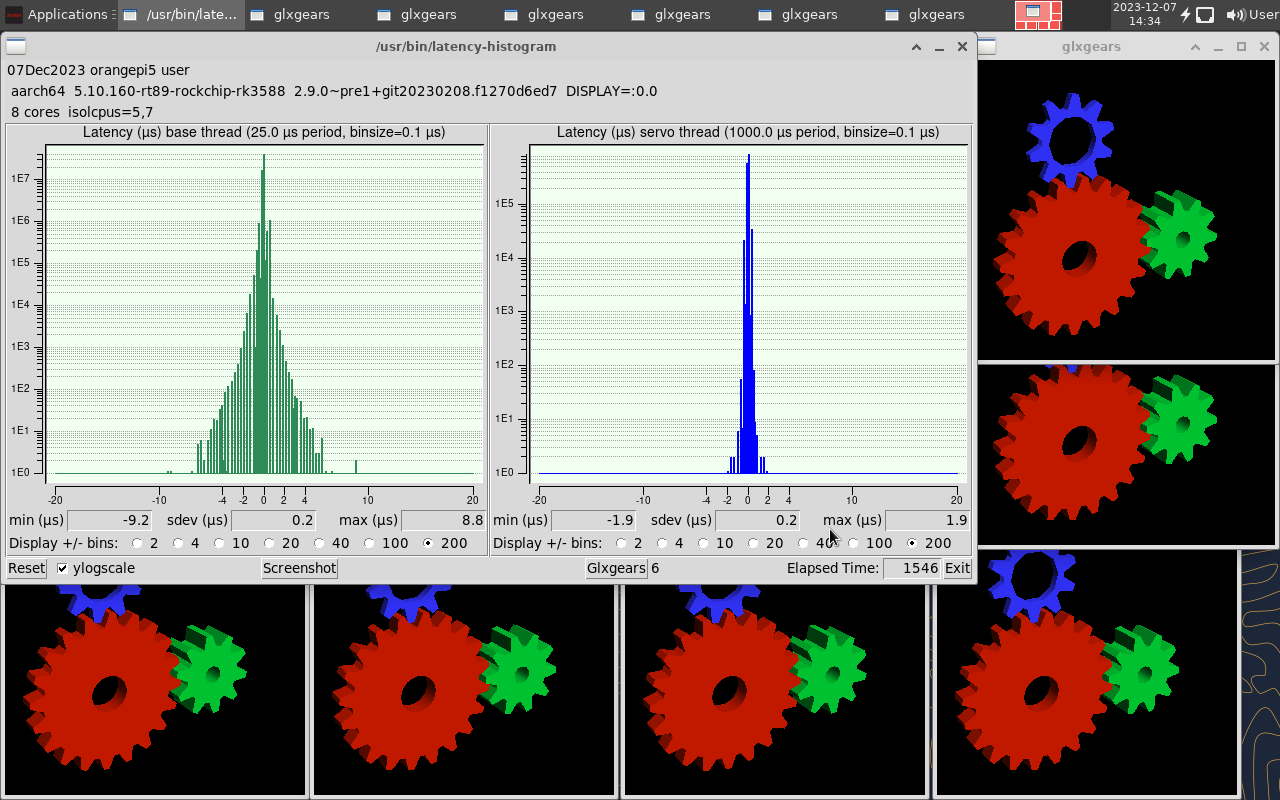

07 Dec 2023 14:23 - 07 Dec 2023 14:32 #287445
by royka
Replied by royka on topic Can the OPI5 be Configured to Run LCNC?
Great to hear you've got it working!
Perhaps the DP output via USB-C will work, but keep in mind that you cannot use the vertical USB port when you use the USB-C port.
Although you don't use the base thread when you use a hardware stepgen I wonder why yours is a bit higher, because my result was after I opened
Chromium with YouTube first (also an OPi5 instead of the plus in contrast of what the screenshot shows). Perhaps you ran it from a SD or without cooling? Anyway when you'll use a hardware controller over ethernet you might wanna look some of the previous messages about moving the IRQ of the ethernet controller.

07 Dec 2023 14:40 #287450
by kmike
Replied by kmike on topic Can the OPI5 be Configured to Run LCNC?
The OPi is cooled, but I am still using my (old and pretty slow) SD card.
Currently the CPU is 66°C warm (don't know if that is already too much)
I will try installing the system to my SATA SSD, and try again
I plan to use my own FPGA card with the machine, but that is a story for another post or thread...

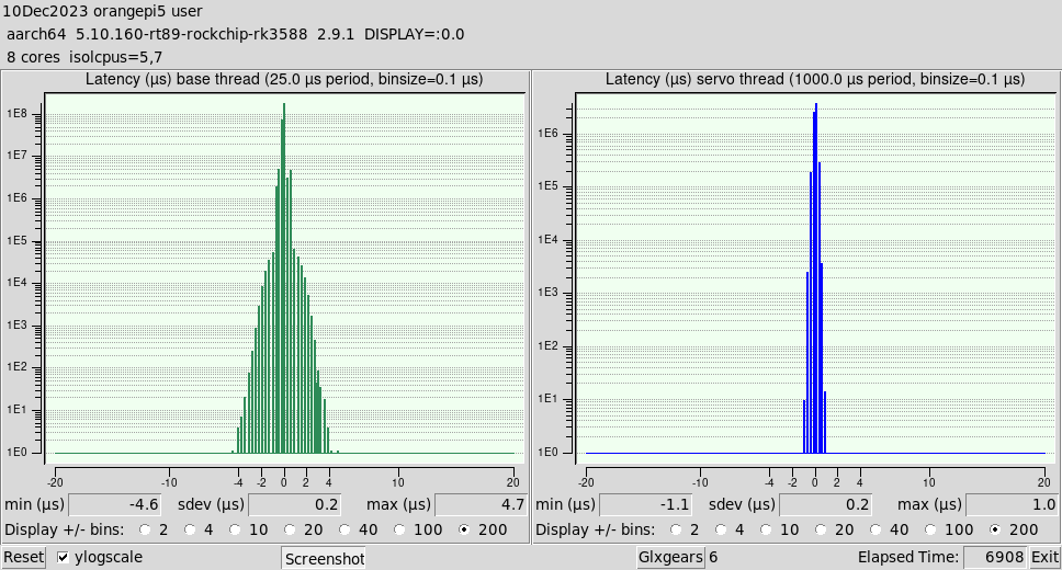

11 Dec 2023 10:34 - 11 Dec 2023 12:45 #287836
by kmike
Sorry for the late reply, the last days where very busy
Hardware and software data for the attached latency diagram:
- Orange Pi 5, 8GB RAM
- 256GB NVME SSD
- had to replace the SATA SSD, latency was terrible. In my opinion a SATA SSD is absolutely not recommended for LCNC with the OPI5
- boot: cma=128M idle=poll isolcpus=5,7
- overlays: lcd1
- "end1" IRQ moved to core 5
- kernel: 5.10.160-rt89, config is from royka with some minor changes
- Armbian Bookworm + Xorg + XFCE4 + LCNC 2.9.1 form the LCNC website
- 6 glxgears
- network traffic of about 65MBit/s generated with a test script (send and receive TCP and UDP + a ping flood to my PC)
I did not open a Youtube video, as the support for Xorg was dropped by ARM in 2019, so Xorg is using fbcon driver without any hardware acceleration. Playing a Youtube video basically immediately overloads the whole system (over 160% load with just 1 glxgears), thats why I have made a primitive script to do HTTP GET, UDP TX/RX and a ping flood with my PC. This way I got 60-70 MBits/s traffic on the network adapter.
@Cornholio:
I am using a Gowin GW2A FPGA with a custom board (6x analog out, 2x analog in, 6x step/dir outputs, 6x encoder in, 27 sinking 24V digital inputs, 27 push-pull-float digital outpus, dedicated limit switches and home input for all 6 axis), with the HAL driver and Verilog done from almost scratch. Communication is over UDP. It is very much a work in progress (even missing a watchdog, thats the next to-do) so no public sources at the moment. I just got fed up with the unavailability of the Mesa cards in Europe, thats why I started my own design with parts easily sourced from Mouser and Farnell
- 256GB NVME SSD
- overlays: lcd1
- 6 glxgears
@Cornholio:
Last edit: 11 Dec 2023 12:45 by kmike.
