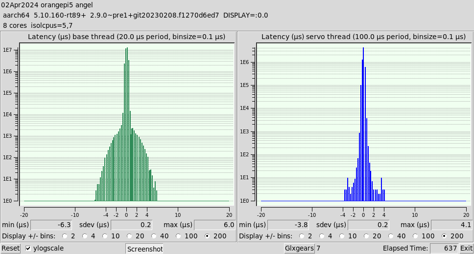

Use --show at the end of the latency-histogram line to show those excursions.
Replied by tommylight on topic Can the OPI5 be Configured to Run LCNC?
No, this is much worse than the first picture, see the colored columns on both sides of the graph.
With the image of armbian kernel 6.8.0-RC1-edge, without real time but with isolcpus = 5.7. Something better in Servo Thread behaves, I have a Orange Pi 5.

02 Apr 2024 18:50 #297452
by angelnu
Replied by angelnu on topic Can the OPI5 be Configured to Run LCNC?
The following user(s) said Thank You: tommylight, royka
- Posts: 21958
- Thank you received: 7478
02 Apr 2024 20:24 #297462
Yes they are!
I have installed the kernel in Armbian Debian Bookworm, the results are magnificent.
