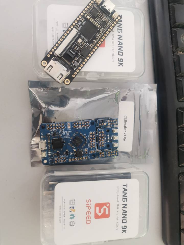

10 Jun 2023 22:16 #273298
by kzali
Replied by kzali on topic LinuxCNC-RIO - RealtimeIO for LinuxCNC based on FPGA (ICE40 / ECP5)
Excited to see the Tang Nano 9K as I recently got one to dabble in the FPGA world. Looking forward to your work on this as I am very new to this area.
- meister
- Posts: 805
- Thank you received: 502
10 Jun 2023 22:22 #273299
by meister
Replied by meister on topic LinuxCNC-RIO - RealtimeIO for LinuxCNC based on FPGA (ICE40 / ECP5)

- kzali
- Posts: 38
- Thank you received: 12
11 Jun 2023 07:51 #273314
by kzali
Wow thanks still trying to wrap my head around Oss-Cad-suite/litex
