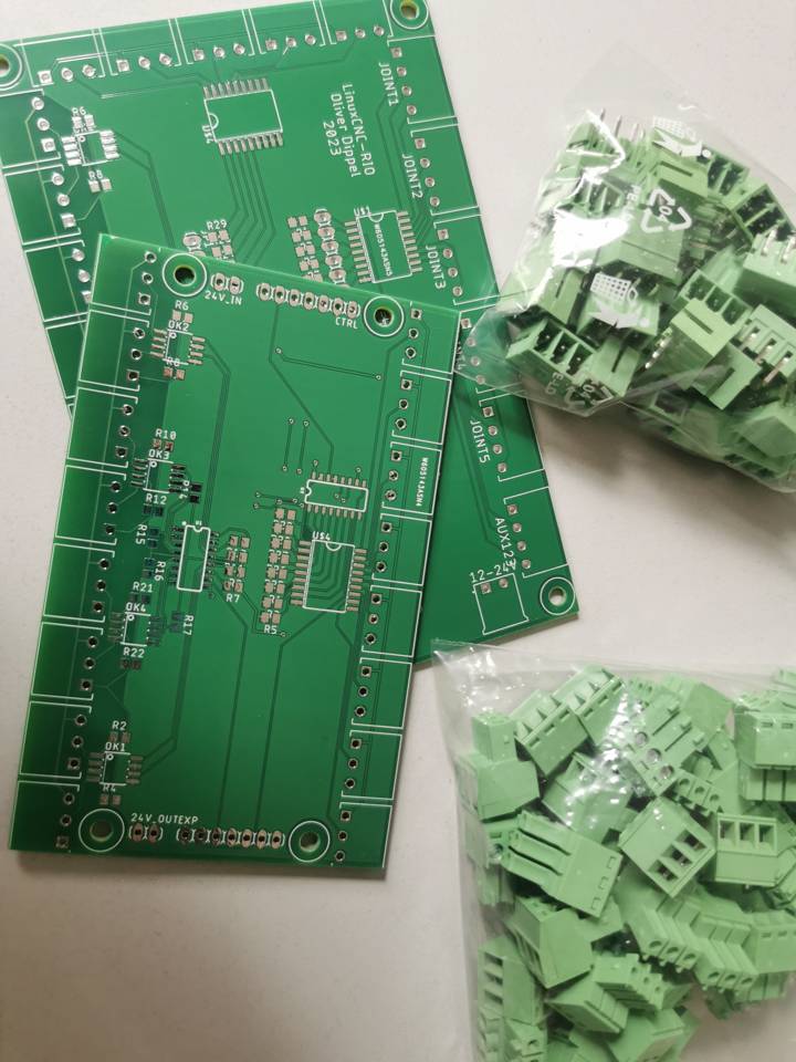

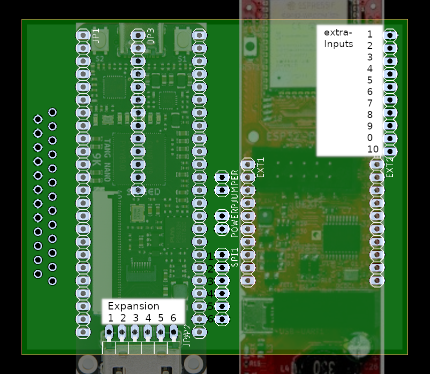

We have a very simple bob-adapter now for the TangNano9K Board:
github.com/multigcs/LinuxCNC-RIO/tree/main/configs/TangNano9K

Replied by cakeslob on topic LinuxCNC-RIO - RealtimeIO for LinuxCNC based on FPGA (ICE40 / ECP5)
Hey, any thoughts on making it configurable via SD card config like the regular remora? I notice the tang has an SD card slot

24 Jun 2023 06:45 #274163
by meister
Replied by meister on topic LinuxCNC-RIO - RealtimeIO for LinuxCNC based on FPGA (ICE40 / ECP5)
no, if you change the config (IO-Functions), you have to generate a new bit-file.
it's far away from remora, only the linux-component is adapted from remora.

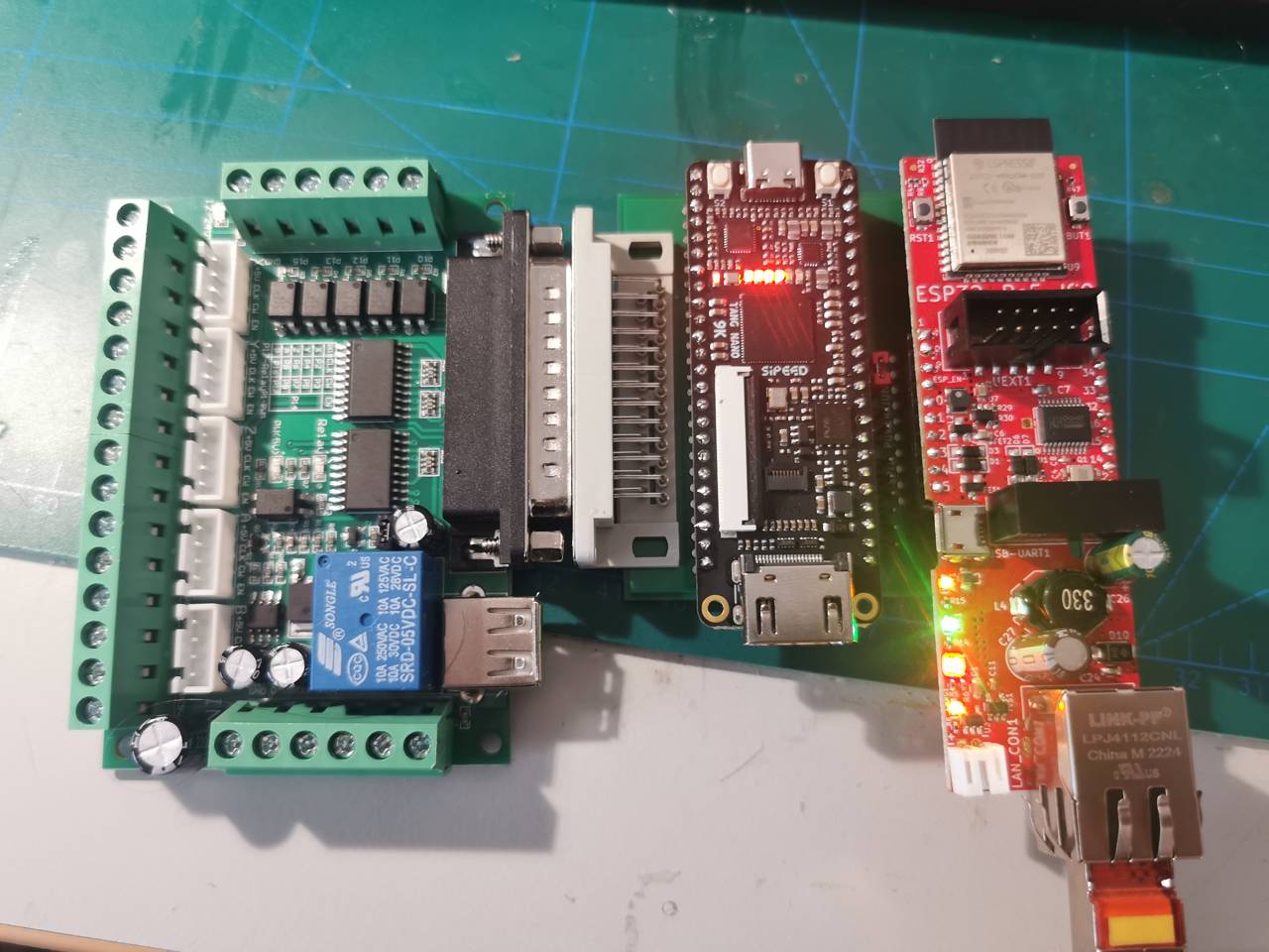

03 Jul 2023 14:25 #274692
by MaxEkb77
Replied by MaxEkb77 on topic LinuxCNC-RIO - RealtimeIO for LinuxCNC based on FPGA (ICE40 / ECP5)
tang 9k & pi (orange & raspberry), table pick&place for test.
How about w5500 for link normal computer ?

03 Jul 2023 14:59 - 03 Jul 2023 15:00 #274694
by meister
because there is no softcore running on the FPGA it is difficult to connect such interfaces.
but you can use one of this two modules to add UDP support:
github.com/multigcs/LinuxCNC-RIO/tree/main/UDP2SPI-Bridge

03 Jul 2023 16:22 #274697
by MaxEkb77
flash & wiring ok - working.
Question:
Driver have pid? - why not standart linuxcnc pid ?
Ok np, next time.because there is no softcore running on the FPGA it is difficult to connect such interfaces.
Question:
