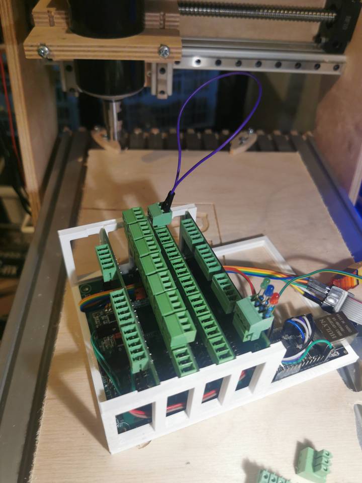

06 Aug 2023 18:39 - 06 Aug 2023 19:02 #277129
by fest
Replied by fest on topic LinuxCNC-RIO - RealtimeIO for LinuxCNC based on FPGA (ICE40 / ECP5)
I recently stumbled upon this topic- looks really impressive project. I'm currently building a milling machine and was planning on using linuxcnc and mesa, however this looks a tempting alternative for my use case.
I'm not afraid from building the needed electronics and fiddling with building the gateware as I have some leftover Colorlight ecp5 modules, have experience with open source fpga tools (though, with LiteX/amaranth, very rudimentary verilog knowledge), and have another cnc machine planned, so the work would be amortised over more than a single machine.
My main question would be: what might I be missing out by using this instead of mesa? Are there known features not implemented yet (I think my needs are rather modest: up to 5 step/dir axes up to 6 incremental encoders, digital inputs/outputs). I'm not really sure where the closed motion control loop is being executed usually- is it Linuxcnc, or does mesa have support to do closed loop stepgen in hardware (which doesn't seem to be supported here, right?)

06 Aug 2023 19:39 - 06 Aug 2023 19:41 #277143
by meister
Replied by meister on topic LinuxCNC-RIO - RealtimeIO for LinuxCNC based on FPGA (ICE40 / ECP5)
Hi fest,
thanks
I don't have any mesa cards, so I can't tell you what's missing.
But if you miss something, let me know and I'll try to add it.
I think mesa also uses the pid controllers in linuxcnc.
About the colorlight boards i have to say that the networkport is not supported, you need 4 free pins for SPI and either a UDP2SPI bridge or a raspberry.
5 step/dir axes up to 6 incremental encoders should be no problem if you have enough pins.
EDIT: do you know this project ?: forum.linuxcnc.org/27-driver-boards/4442...roller-board?start=0

06 Aug 2023 20:06 - 06 Aug 2023 20:06 #277151
by fest
Hmm, thanks for the pointer, LiteXCNC also looks quite interesting. Direct Ethernet support is indeed intriguing, though it also appears that IO options are more limited in LiteXCNC.
The modules I have are SODIMM, with FPGA, SDRAM and 2x GigE phy, not the boards with LED buffers, so pin availability is not a problem. I'll probably design my carrier board to be compatible with both projects (so far it seems that LinuxCNC-RIO only needs an SPI header while LitexCNC needs the phy) and see what works best for me.

07 Aug 2023 08:01 #277204
by meister
if you mean this board: tomverbeure.github.io/2021/01/22/The-Col...velopment-board.html
i have a test board for it:
without Ethernet and stepper/encoder/IO interfaces on extra cards

07 Aug 2023 16:07 #277249
by fest
Nice, this is similar to what I had in mind. Is the board design open source?

07 Aug 2023 20:50 #277280
by meister
was not the plan, it's only for testing the concept, but you can have it:
multixmedia.org/color_i5.tgz
(eagle-files, but you can import it into kicad)
where you living ?
i have some PCB's of this version, if you need one....
where you living ?
