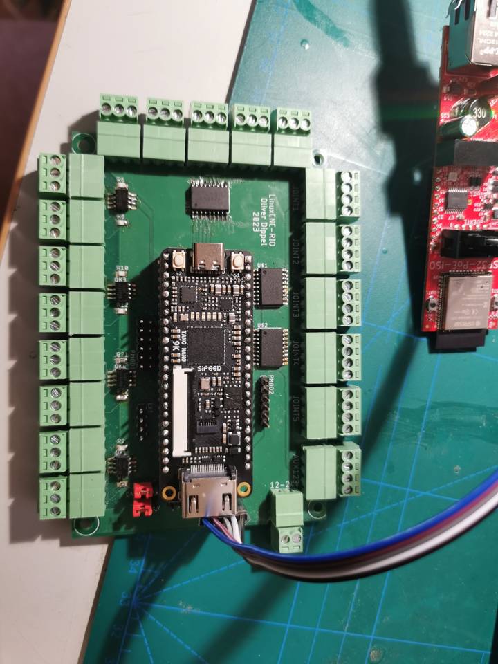

I see in your video of the TangNano9K it's connected to a DB25 which is then connected to some other board(breakout) which then drives some stepper driver boards. My question is, will the TangNano9K, with RIO, directly drive a CNC having "standard"/Mach 3 type DB25 connectors and opto-isolated control/drivers internally? I have a Chinese CNC3040T in this configuration and would be willing to try RIO with it. Thanks.
Also wondering what that Ethernet to SPI board is on the other side of the Tang Nano 9k?
PS, I did some work with Scott and Remora and found that by using a standard ribbon cable for 3D printer remote displays and grounding every other wire in the ribbon, I could get SPI to work reliably out to almost 300mm. My PCB adapters( dirtypcbs.com/store/user/edit/6524 ) but for the rPi side I designed it for the Argon One Pi 4 case( www.aliexpress.us/item/2255800056869749.html ).

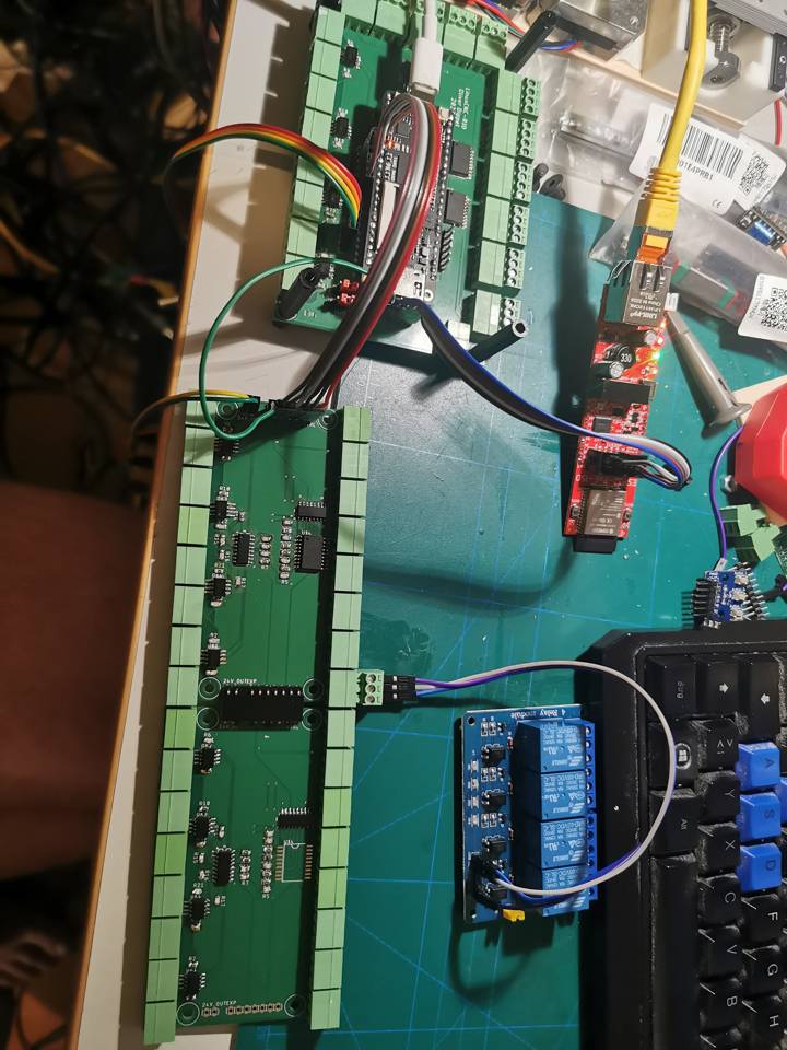

the tangnano9k is directly connected to the bob, you can simply solder an adapter to the DB25 Connector.
BUT !!! the FPGA is not realy 5V tolerant, pullups are ok, i have no problem with my china BOB, but i can't say if it works with other BOB's
The Ethernet-Board is an optional UDP to SPI bridge, so you can use any PC.
And before you are frustrated, please try to build the project before buying the hardware, some user have problems to compile the firmware.
EDIT: you can map each pin to more or less each function
