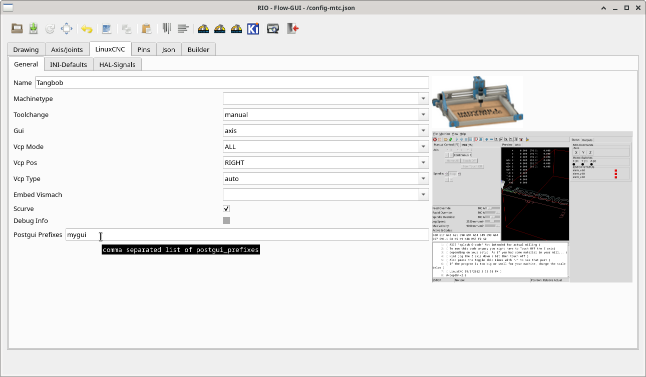

Thank you so much for the quick fix on the touchy prefix and for explaining the call_list mechanism! That makes managing external custom files much cleaner. Also, the virtual signals logic feature looks very neat and powerful—I'll definitely look into the demo.
Regarding signal assignment in Rio Flow: while having auto-detection via POSTGUI_COMPONENTS works great for standard prefixes, would it be possible to add an explicit target selector in the UI (for example, a dropdown or toggle in the HAL-Signals section to choose whether a connection belongs to Main/PreGUI or PostGUI)?
Having this option directly in the GUI would give maximum flexibility:
- It prevents having to hardcode every possible GUI/component prefix inside POSTGUI_COMPONENTS.
- It handles custom user interfaces, custom PyVCP/GladeVCP panels, or non-standard naming schemes seamlessly.
- It allows users to decide explicitly where each net lives directly from the Rio Flow design environment.

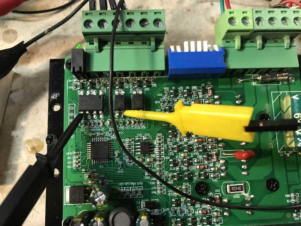

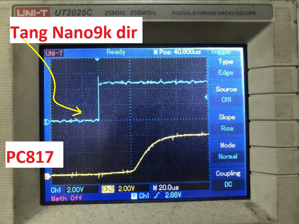

Dear meister, after adjusting the joint and pid values correctly, I observed the DIR circuit of the DM542 with an oscilloscope and found that the PC817 was delayed by more than 60 usec. Setting dir_delay to 80 usec allowed it to correctly return to the zero position. I apologize for asking some silly questions a few days ago.

@viewsat you can tune the PC817 with lower resistance values on the transistor side, this produces a steeper slope

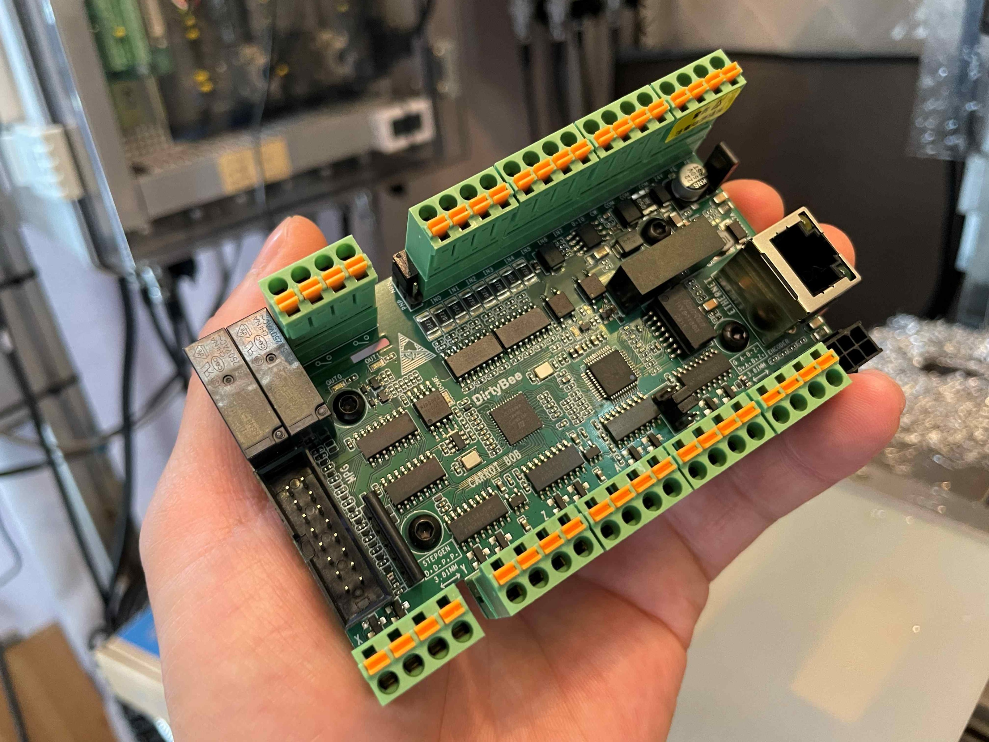

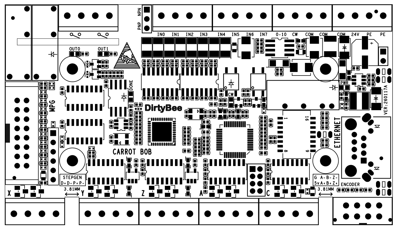

@viewsat do you have some more informations about the DrDirt - Carrot Bob board ?
documentation, pinouts schema's or so, or a contract mail to the seller/developer,
I’d like to add it to Rio-Flow and still need a bit more information to do so.

19 Aug 2026 11:59 #348858
by viewsat
Replied by viewsat on topic LinuxCNC-RIO - RealtimeIO for LinuxCNC based on FPGA (ICE40 / ECP5)
I have a json file that I can provide; other files may not be publicly available for download here.@viewsat do you have some more informations about the DrDirt - Carrot Bob board ?

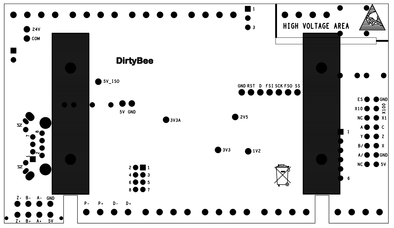

Dear meister:
The CARROT BOB sch is in attachments.
I build it for my hobby mini mill machine in my bedroom.
I think it's not very good just like my English,and I don't know how to send it to you,you are live so far with me.
I'm so happy you like it , if you know the way, I'll send it to you for free
Tim
Tim

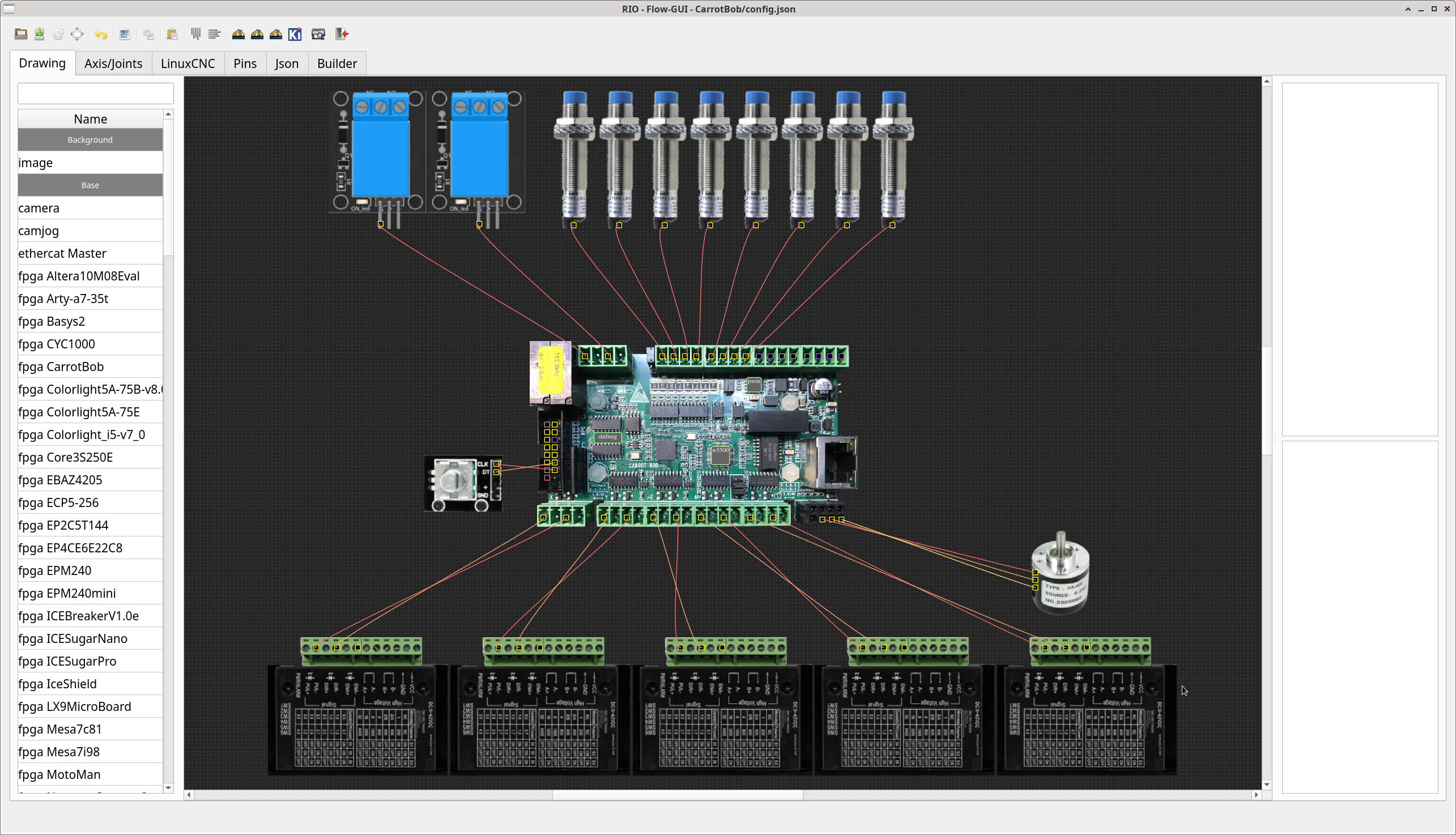

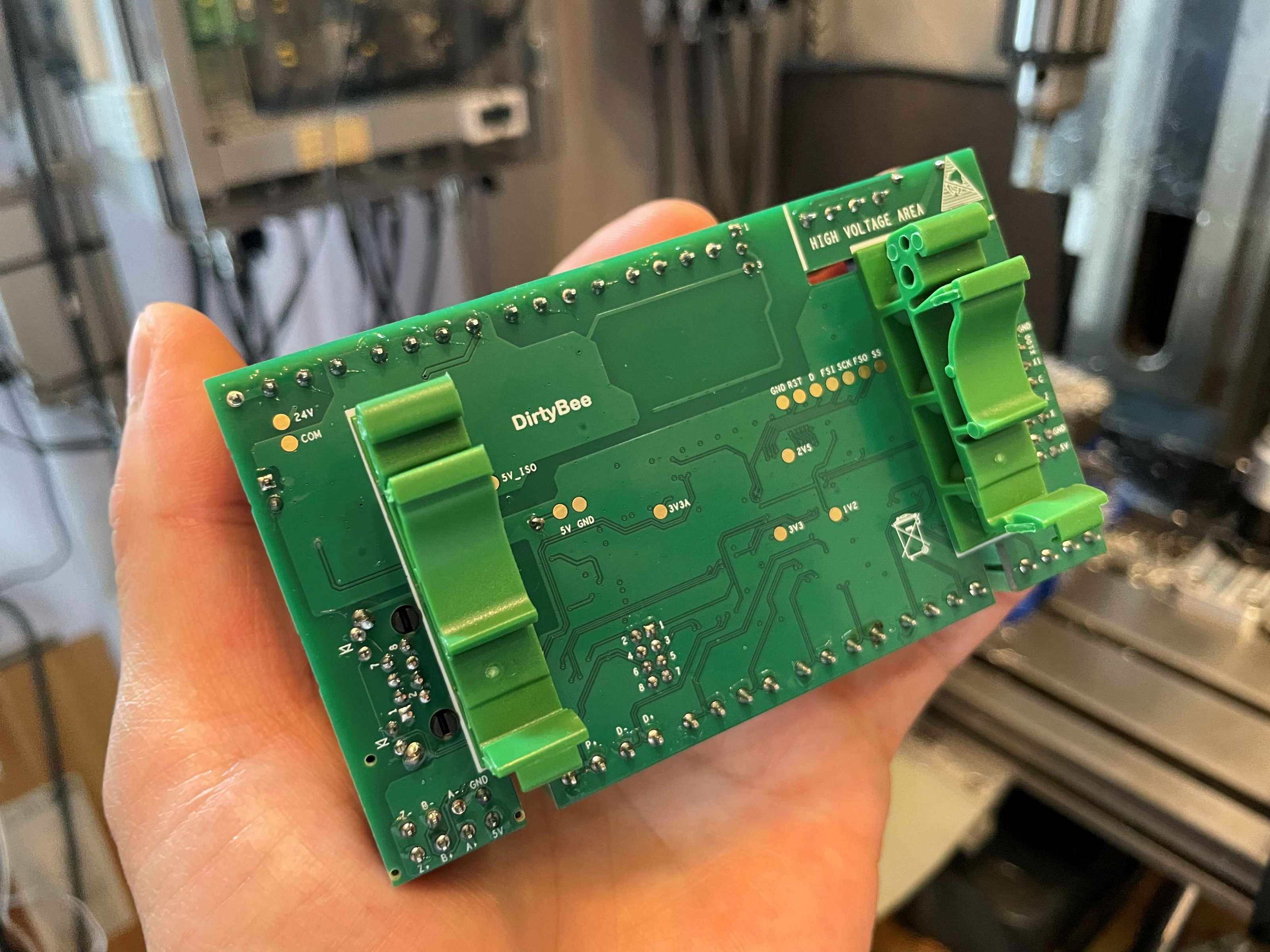

Thank you Tim,
Thanks very much for the details; I’ve entered the board’s details as best I could,
I hope it’s all correct so far – please do have a look over it.
What’s not quite clear to me yet is, how do you flash it? Are there any connectors on the back?
You’re also welcome to send me some text and a link for the description, and I’ll update it.

20 Aug 2026 09:15 - 20 Aug 2026 09:56 #348870
by Tim Bee
Replied by Tim Bee on topic LinuxCNC-RIO - RealtimeIO for LinuxCNC based on FPGA (ICE40 / ECP5)
Last edit: 20 Aug 2026 09:56 by Tim Bee.
