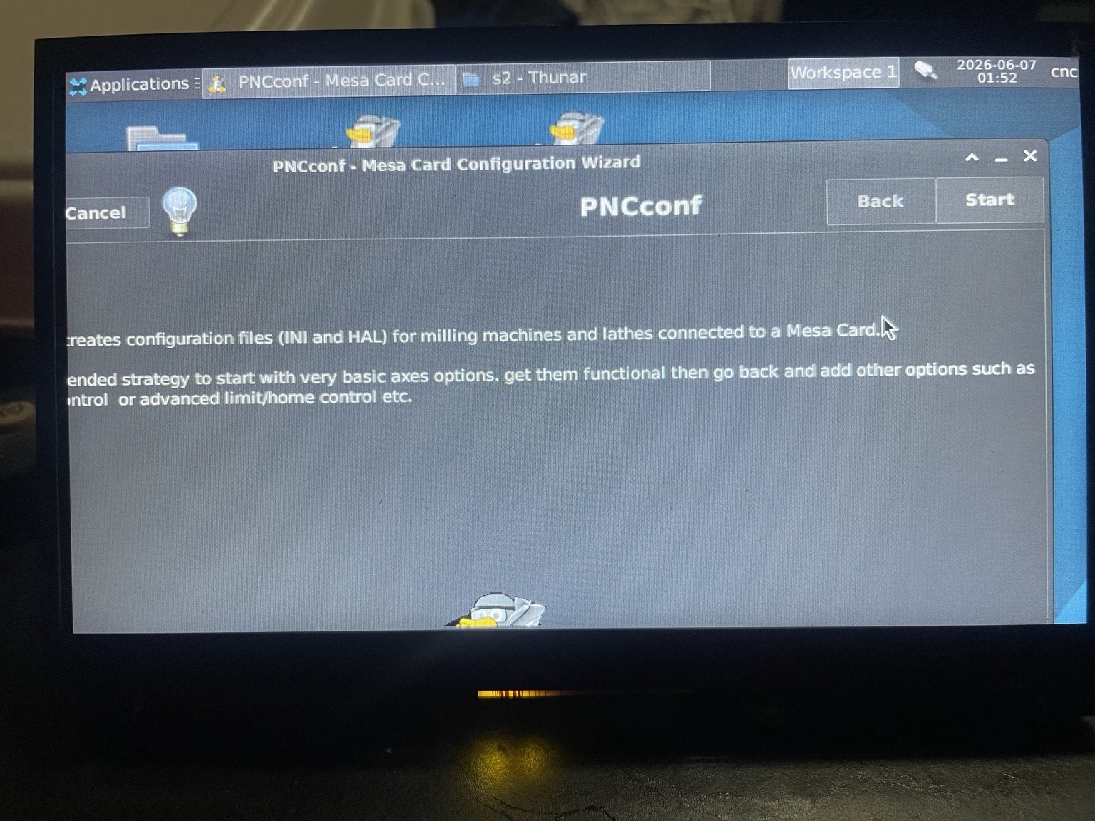

Maybe 5 axis with rtcp. My plan is to make one with 5 axes this year that would work on rpi5 + 7i96s + touch screen...otherwise I won't change it, although I've already forgotten how to insert the procedure exactly (which file where), but it looks perfect. Thank you.

07 Jun 2026 11:20 #346950
by Masiwood123
Replied by Masiwood123 on topic Axis 2 - touchscreen version of old friend

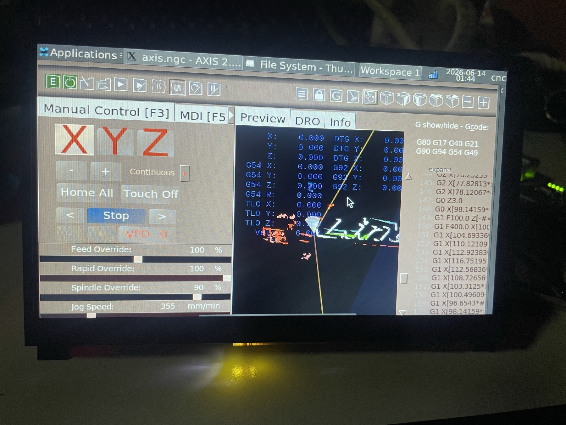

I will look at the config but that is actually a separate application
Did u try axis 2 on a small screen it should fit I think it removes a slider or 2 for convenience

13 Jun 2026 23:51 #347061
by Masiwood123
- zack
- Posts: 91
- Thank you received: 47
17 Jun 2026 07:01 #347127
by zack
Replied by zack on topic Axis 2 - touchscreen version of old friend
We can enlarge those fonts but I think we are compressing too much info on such a small display
I have done a Aus where the touch screen was for control and a separate monitor like an old 15” was used for preview only
Ie dual screen one touch one display
So can do if u interested

17 Jun 2026 07:19 #347128
by Masiwood123
I fully understand, I even tried to hook up a 32 inch external monitor without touch function, however it gives the image from rpi4 via mini hdmi, and regardless of the resolution of the large screen the numbers on the preview tab are still quite blurry, yes it would mean that we try. thanks
