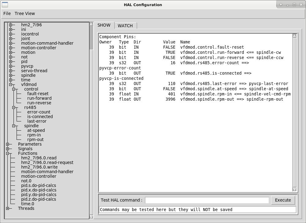

Thanks Rob. I am pretty close with my H100 VFD. I have everything set "correctly" as far as I am able to tell, but I have one issue. I cannot get the RPM above 4000. I don't have a tach, but the spindle seems to be turning at the 4000 rpm indicated. Spindle turns on and off, and I can slow it down, but I cannot go faster. (It works fine in manual mode).
Screen shot and config attached.

I would look at the vfd itself. Look at F014-F021 - mine are all set to 5.00. If these are too high it won't get to the target speed. I had this issue and I *think* it was the accel settings that straightened it out.

I changed them all to match yours and still have the issue. Maybe I am not describing it well. When I bring up the Axis gui, and press on the spindle forward icon, it goes to 3996 and will not go any faster. Is this a linuxcnc setting or still something on my VFD?

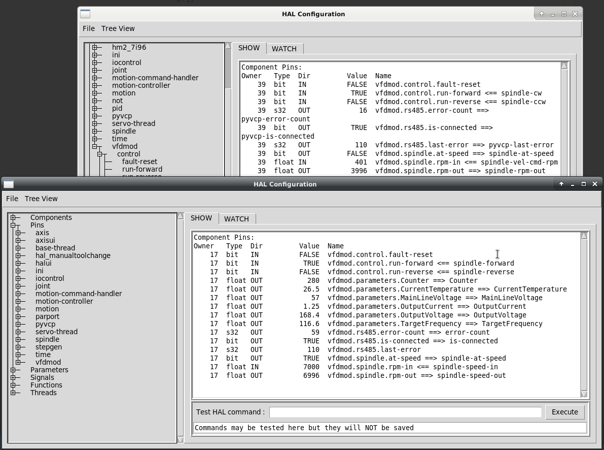

The screenshot shows some of the different vfdmod settings / syntax that we have, along with the different rpm in / out / spindle-at-speed values. To get your 3996 rpm out and 401 rpm in, did you click the spindle + button in axis, or do an MDI command? Try to doing M3 S6000 and see what those values say then.
Then the attached file shows all of your spindle related settings, with my spindle related settings below (with the // in front). These are spread over different files but I have pasted all into one so it's easier to see. Your main ini and vfdmod ini files seem to be fine, so I am thinking the problem lies in these vfdmod net settings.

I was doing a S6000 and F9. When I do a M3 S6000 (or whatever speed) it works!!! I guess I just assumed that F9 did the same as a M3.
Are our net settings different due to different linuxcnc versions? I'm at 2.8 but I could upgrade to 2.9.
