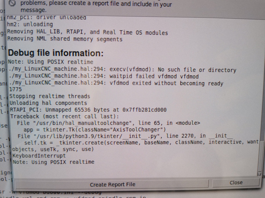

[/code][Common] MaxSpeedRPM=24000 MinSpeedRPM=6000 ;AtSpeedThreshold=0.05 [RS485] SlaveAddress=1 SerialDevice=/dev/ttyUSB1 BaudRate=9600 LoopDelay=500 ProtocolDelay=6 ;IsConnectedDelay=10 ConnectionErrorList=110 ConnectionDelay=500 [Control] Address=0x1000 RunForwardValue=0x0001 RunReverseValue=0x0002 FaultResetValue=0x0007 StopValue=0x0006 [SpindleRpmIn] FunctionCode=0x06 Address=0x3000 Multiplier=10000 Divider=24000 [SpindleRpmOut] Address=0x3001 Multiplier=30 Divider=10 [freq-running] FunctionCode=0x03 Address=0x3001 PinType=float PinName=freq-running Divider=10 [bus-voltage] FunctionCode=0x03 Address=0x3002 PinType=float PinName=bus-voltage [output-voltage] FunctionCode=0x03 Address=0x3003 PinType=float PinName=output-voltage [output-current] FunctionCode=0x03 Address=0x3004 PinType=float PinName=output-current Divider=100 [output-torque] FunctionCode=0x03 Address=0x3006 PinType=float PinName=output-torque [run-speed] FunctionCode=0x03 Address=0x3007 PinType=float PinName=run-speed [spindle-load-speed] FunctionCode=0x03 Address=0x300F PinType=float PinName=spindle-load-speed [power-on-time] FunctionCode=0x03 Address=0x301A PinType=float PinName=power-on-time [spindle-run-time] FunctionCode=0x03 Address=0x301B PinType=float PinName=spindle-run-time [fault-code] FunctionCode=0x03 Address=0x8000 PinType=float PinName=fault-code And here's the files added to the custom.hal to make it work with the interface: [code]loadusr -W vfdmod bd600.ini --debug net spindle-vel-cmd-rpm => vfdmod.spindle.rpm-in net spindle-at-speed <= vfdmod.spindle.at-speed net spindle-cw => vfdmod.control.run-forward net spindle-ccw => vfdmod.control.run-reverse
[code]Hi, I also have a bd600 inverter and I used your configuration but I get this error. What am I doing wrong ?Attachments:

Replied by rodw on topic [ Vfdmod ] An easy VFD control over MODBUS RTU
Did you install vfdmod per the instructions at the beginning of this thread?
