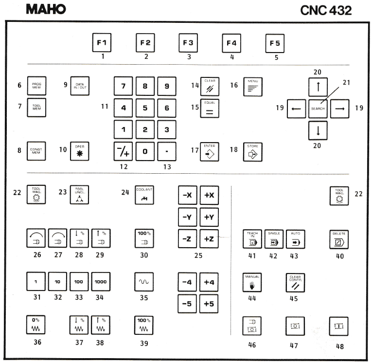

Would you be able to interface an existing matrix key board (like this Maho example)...
... and be able to command functions like spindle on CW with button 26, while also typing numbers into the MDI with buttons like in keypad 11?
- okay crap example, as I don't know what they mean by having 9 buttons called (11).
- Also a crap example as you would really want a keypad with G, M, X, Y, Z, I, J, K, R, F, etc.
If that is what it can do, I can see plenty of use cases. It will take a pretty good documentation for non-experts to be able to use it.

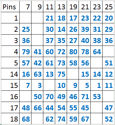

01 Mar 2021 10:18 #200548 by andypugh
Replied by andypugh on topic New component for keyboards and panels.
Would you be able to interface an existing matrix key board (like this Maho example)..... and be able to command functions like spindle on CW with button 26
Yes, that is exactly the sort of thing that it is intended for.

Do you have an old keyboard from an industrial CNC to integrate? Shame I swapped my Maho panel to someone who needed it on their working Phillips.
It would be a big asset to new users (and even advanced users) to do a step by step video on how to identify a matrix key pad, how to wire it into a 7i73, and then how to integrate it into the HAL.

01 Mar 2021 11:13 #200655 by andypugh
You can do this already. panelui was made with that in mind
Embarassingly, I had forgotten about panelui.
What sendkeys can do is either create a system keystroke from a scancode - not covered by panelui or send a keystroke when a HAL bit pin toggles - completely unrelated to panelui.
It is perfectly possible to take a 7i73 scancode into matrix_kb (to trigger bit pins) and to sendkeys (to send keystrokes) and also into panelui (to do all the things that panelui can do)
matrix_kb in matrix scan mode can output a hal-bit per key, and the scancode output can be connected to panelui (to toggle bits _and_ other things) and also to sendkeys to send keycodes.
It might make sense to add keystroke sending to panelui. This would lead to some redundancy, but having a baffling variety of ways to achieve any desired result seems to be the LinuxCNC Way.
