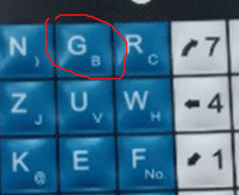

20 Jul 2021 10:59 #215400 by nkp
Replied by nkp on topic New component for keyboards and panels.
I have installed Debian10 (lcnc 2.8)
tried making a switch for a button with two values

20 Jul 2021 12:33 #215408 by nkp
if the button can have two meanings

20 Jul 2021 13:19 #215412 by andypugh
Replied by andypugh on topic New component for keyboards and panels.
Probably..
How do you plan to select the alternate function?
