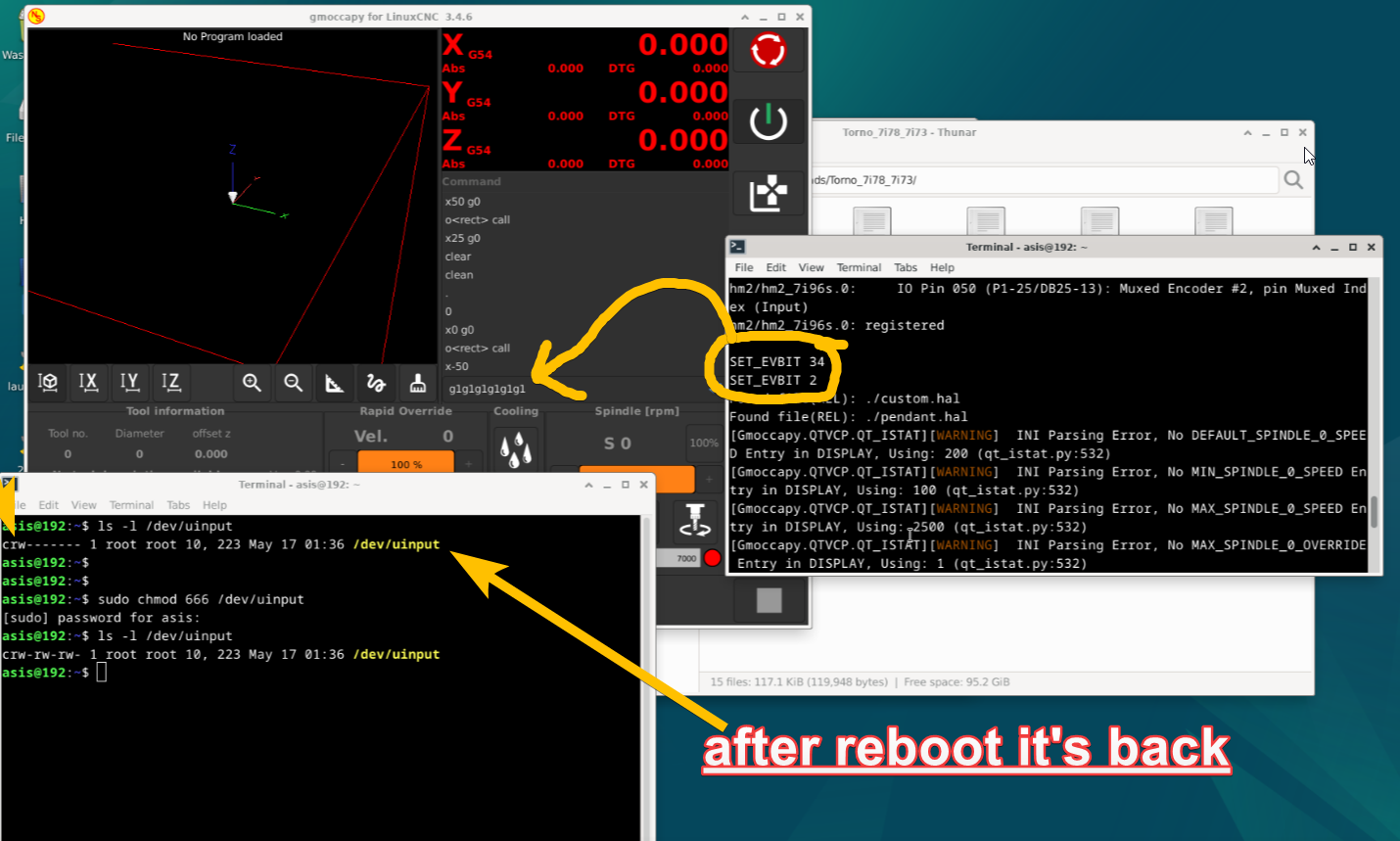

- abdulasis12
- Posts: 133
- Thank you received: 8
16 May 2024 11:50 #300730
by abdulasis12
Replied by abdulasis12 on topic New component for keyboards and panels.
Hi
Thank you for fast respond ! , MR.Aciera and MR.tommylight
sudo chmod 666 /dev/uinput
WORK !!
Now ls -l /dev/uinput result chang to : crw-crw-crw
Then I try reboot my PC
after reboot open terminal and recheck
ls -l /dev/uinput
but it's will change back to crw
I must type again : sudo chmod 666 /dev/uinput
Then I try open linux from terminal and try keycode 2 button it's Awsome I can "G" and "1" in MDI
At last .......
How to remember after reboot permission onfile uinput ?
WORK !!
ls -l /dev/uinput
At last .......
- Posts: 21959
- Thank you received: 7478
16 May 2024 11:58 #300732
Replied by tommylight on topic New component for keyboards and panels.
Well, that might be since the uinput is accessed during boot time, so something must be changing the permissions.
You can make a shortcut to start LinuxCNC and set permissions before running it as a bash script, butnit would still require entering the sudo password.

Isn't there a section in the document you posted a screenshot of that explains how to modify the .rules file so the permission is permanently set?

- MarkoPolo
- Posts: 319
- Thank you received: 90
16 May 2024 16:32 #300763
by MarkoPolo
Replied by MarkoPolo on topic New component for keyboards and panels.
The /dev directory is created dynamically at system startup, so nothing can be permanently written there.
You can create a file, e.g. uinput in the /etc/cron.d/ directory, with the following content: @reboot root chmod 666 /dev/uinput
(remember to put enter at the end of the line)
