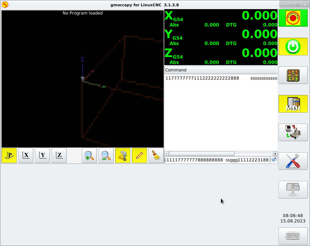

Sorry, I mean install from USB images. LinuxCNC 2.8.4 released
15 Aug 2023 12:30 #278043 by SOLD
Replied by SOLD on topic New component for keyboards and panels.
thank you for the advice I can now hit the response button.

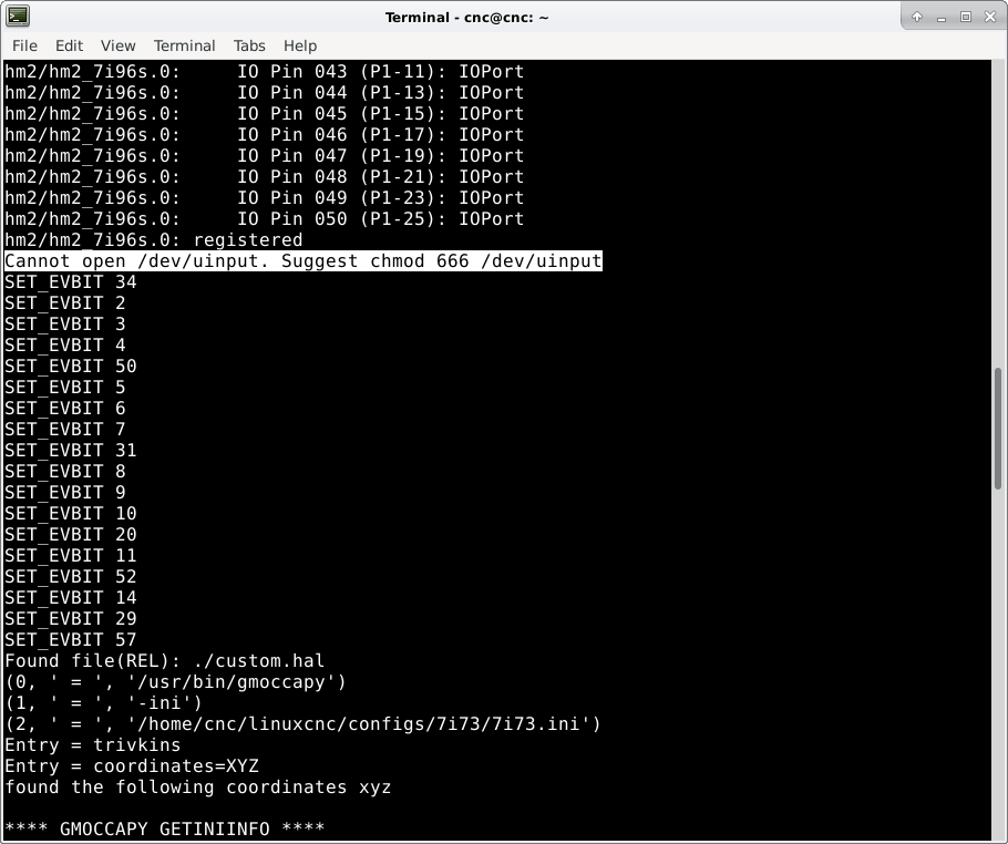

but still like you said When turning off and on Access rights will not work.
Is there any way to call the 0660 permissions on startup?
15 Aug 2023 15:13 #278047 by SOLD
in udev.conf must edit ?

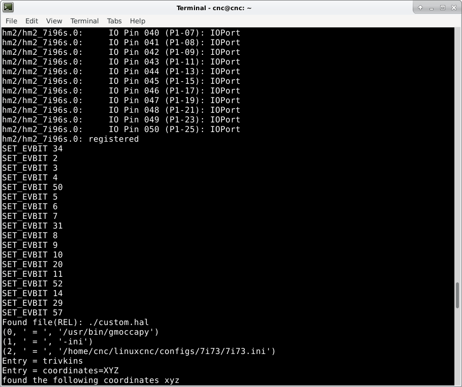

15 Aug 2023 18:28 #278065 by COFHAL
Replied by COFHAL on topic New component for keyboards and panels.
Yes, it is possible but I don't know what GUI you are using, could you send me a screenshot. Are you using Debian?
16 Aug 2023 03:00 #278110 by SOLD
yes i use debian with linuxcnc 2.8.4 gmoccapy gui.
17 Aug 2023 00:30 #278217 by COFHAL
I really don't know, I'm using this component with raspian and with root privileges, therefore when I change the permissions I was able to keep them, because I don't need a password to run sudo chmod 666 /dev/input. Today I tried to do it on a PC, but it always asks me for a password when executing the sudo command. I haven't found a way to run a script without being prompted for the password.
