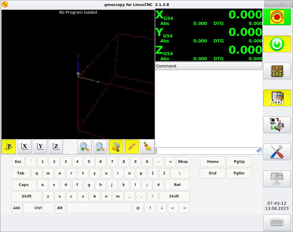

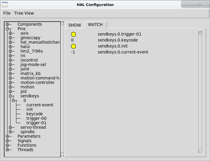

13 Aug 2023 12:28 - 13 Aug 2023 12:29 #277818
by SOLD
Replied by SOLD on topic New component for keyboards and panels.
what did I do wrong?
loadrt matrix_kb config=4x8
addf matrix_kb.0 servo-thread
loadusr -W sendkeys config=16t2
setp sendkeys.0.pin-event-01 57 # Space
setp sendkeys.0.init 1
setp sendkeys.0.trigger-01 true

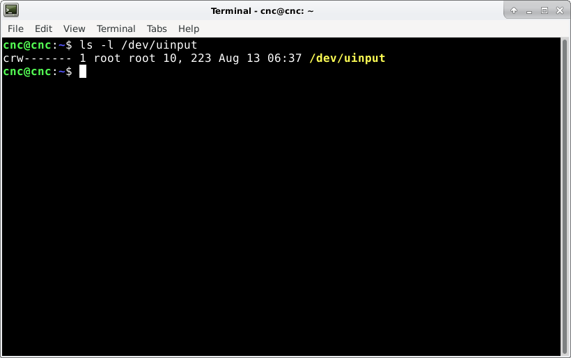

13 Aug 2023 12:35 - 13 Aug 2023 12:35 #277819
by SOLD
ls -l /dev/uinput
crw
1 root root 10, 223 Aug 13 06:37 /dev/uinput
or shouid be
crw-rw----
crw
or shouid be
crw-rw----
Last edit: 13 Aug 2023 12:35 by SOLD.
- COFHAL
- Posts: 461
- Thank you received: 62
13 Aug 2023 12:55 #277821
by COFHAL
Replied by COFHAL on topic New component for keyboards and panels.
From what I see in the picture of the terminal, you do not have access to write to the file an input, to correct this type in the terminal sudo chmod +666 /dev/un input and again check with ls -l /dev/input what permissions to write crw-crw crw are already enabled. Finally run LCN from the terminal to see that there are no errors. For the moment, I have only tested the function with events, that is, when pressing a key, write the letter corresponding to the event in the terminal, as in the example of SENKEYS.

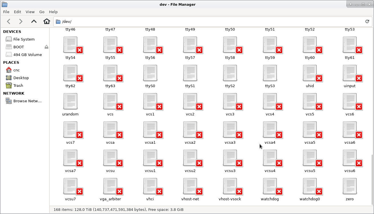

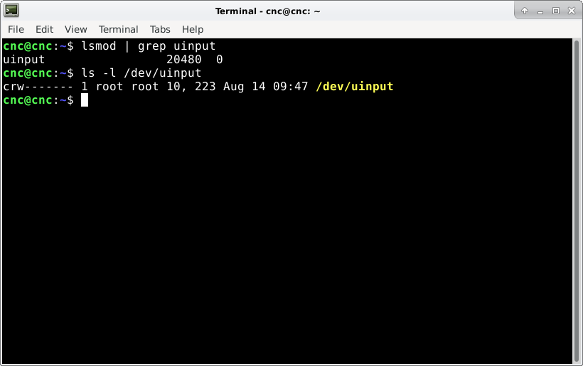

14 Aug 2023 13:53 #277957
by SOLD
i use PC Linuxcnc2.8.4 Live cd
I wonder if the uinput module started working or not.

14 Aug 2023 16:24 #277977
by COFHAL
As far as I can tell you are running from a LIVE CD, so any changes are only effective while it is running.
I don't know if executing from a LIVE CD can modify permissions.
No, please type sudo chmod 0660 /dev/uinput, but don't reboot, because rebooting will remove permissions to write to the uinput file.
To verify that the permissions have changed, run the command ls -l /dev/uinput
If crw-rw---- 1 root root 10, 223 Aug 13 10:13 /dev/uinput appears, you already have permissions to write to the uiinput file.

14 Aug 2023 21:33 #278004
by COFHAL
When using the 7i73 with MATRIX_KB with a 4x8 keypad I have solved the sendkeys.N.scan-event-MM issue, when I press any of the keys of that keypad it writes me the assigned character. Now what I don't quite understand is what is related to sendkeys.N.pin-event-MM. I have not been able to understand very well what is the use. I thought that its use was to create HAL pin and that they could be used as inputs to execute some action such as enable the machine etc. but when testing there is no answer. In the example of the SENDKEYS component, the only use is in:
setp sendkeys.0.pin-event-00 29 # Left Ctrl
#Send Ctl + Space from one trigger
net clear-errors parport.0.pin.00.in sendkeys.0.trigger-00 sendkeys.0.trigger-01
Unfortunately, nowhere on the forum is there a use for the sendkeys.0.pin-event-MM parameter.
