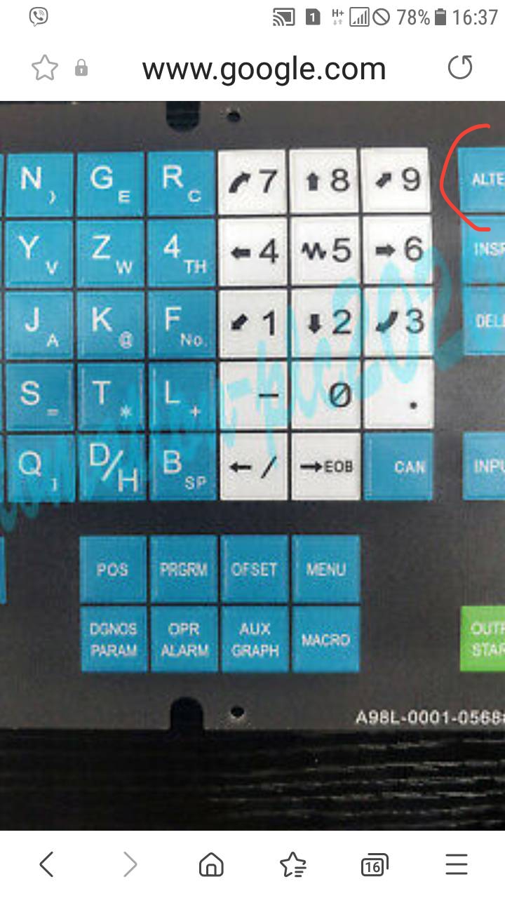

New component for keyboards and panels.
- nkp

Sorry for the late reply, I have been rather busy.
Are you using individual pins or scancodes?
If pins, then possibly you could use a (lot of) mux2 components in HAL.
If scancodes, then maybe toggle a HAL component that simply adds on an offset to the scancode.

30 Jul 2021 04:09 #216297
by nkp
Replied by nkp on topic New component for keyboards and panels.
I'm using pins. It seems to me easier to make changes in the component than to use >40 mux2 . I'll try both.

I am surprised that the keyboard wasn't matrix-wired?

30 Jul 2021 09:32 - 30 Jul 2021 09:40 #216327
by nkp
the simplest way :
loadusr -W sendkeys config=t22
setp sendkeys.0.pin-event-00 2 # Key 1
setp sendkeys.0.pin-event-01 8 # Key 7
setp sendkeys.0.pin-event-11 3 # Key 2
setp sendkeys.0.pin-event-12 4 # Key 3
param->num_tgpin = param->num_events * 0.5;
for (j = 0; j < param->num_triggers; j++){
if (param->prev[j] != *hal->trigger[j]){
if (*hal->trigger[j]){ // keydown
if (*hal->toggle){ // toggle on
emit(param->fd, EV_KEY, hal->event[j + param->num_tgpin], 1);
emit(param->fd, EV_SYN, SYN_REPORT, 0);
} else { // toggle off
emit(param->fd, EV_KEY, hal->event[j], 1);
emit(param->fd, EV_SYN, SYN_REPORT, 0); }
} else { // keyup
emit(param->fd, EV_KEY, hal->event[j + param->num_tgpin], 0);
emit(param->fd, EV_KEY, hal->event[j], 0);
param->prev[j] = *hal->trigger[j];
Last edit: 30 Jul 2021 09:40 by nkp.

30 Jul 2021 09:49 - 30 Jul 2021 09:50 #216329
by nkp
to use the first half of the pins for some values, and the second half of the pins for other values
Last edit: 30 Jul 2021 09:50 by nkp.

30 Jul 2021 11:59 #216342
Replied by andypugh on topic New component for keyboards and panels.
It is probably possible to do it with two sendkeys components, wiring the pins to both and enabling one or the other.

30 Jul 2021 12:09 - 30 Jul 2021 12:10 #216343
I think that a better way would be to add a new code to the config string, (maybe a for alternate) "a2" would create two "shift bits" as pins, and then the scancode params would be:
setp sendkeys.0.pin-event-01-1
setp sendkeys.0.pin-event-01-2
setp sendkeys.0.pin-event-01-3
(for no shift, shift 1, shift 2 and both shifts)
I would also add a scancode (negative?) to set the shift bits from the keyboard. (and bidirectional bits in HAL to show or set status)
Last edit: 30 Jul 2021 12:10 by andypugh.

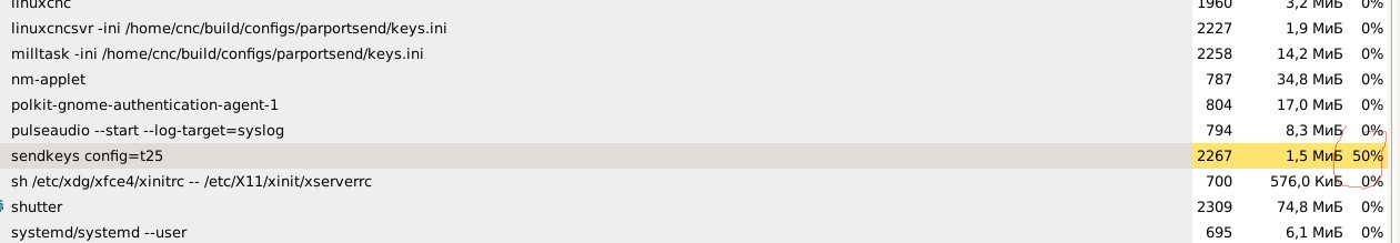

27 Sep 2021 05:16 - 27 Sep 2021 05:18 #221685
by nkp
I am trying to use sendkeys with matrix_kb component. (No board 7i73)
Are there any restrictions on the number of rows in the component matrix_kb?
For example is a 9x7s configuration possible ?
