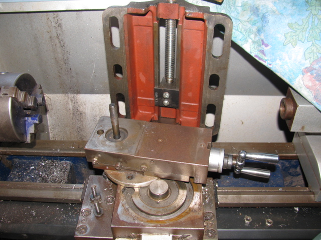

I have just had an insight to my mill table adaptation. I have taken off my tool holder with swivel base and there is actually quite a long flat steel base for the cross slide. If I can find a mill table top and mount it on some extremely sturdy 90degree brackets I can then drill and tap into my existing cross slide base and bolt the brackets down, - that would give me the option of a vertical mill table I can clamp a piece of work to and do a bit of milling.
Does this sound like a reasonable idea?
Regards
Peet
18 Jul 2012 12:32 #22125 by andypugh
Replied by andypugh on topic Re:Lathe conversion from stock to CNC
That's a much better quality compound slide base than mine.
You could make an angle block that allowed you to mount the compound slide vertically (or off-vertical in a range of ways). You could even make it using the lathe and a 4-jaw chuck.
18 Jul 2012 14:39 #22135 by BigJohnT
Replied by BigJohnT on topic Re:Lathe conversion from stock to CNC
Slap an angle on there and bolt the compound to it and fit a vise where the tool holder is and you have a manual horizontal mill. Judging from the spray can a piece of 4" angle would work. Is the tool holder removable from the compound?
John

OK, scratching around I found some rather thick C channel, wide enough to take the compound, the vice is a bit big for the compound, but it fits fine on my 10mm plate. My only concern becomes strength. If I use only existing holes in the compound I will be bolting it down with 2 6mm bolts, I do think I will duplicate the 25mm centre pin, probably bolting that down with a 10mm bolt. There is currently one hole to mount the tool holder, though I can add more holes, there is also a raised platform for the tool holder, so a logical place for another hole would require a wide shim. I hopefully attach a picture of what I have in mind. I am not looking forward to cutting the channel iron though, I think it may take a while.
Regards
Peet
