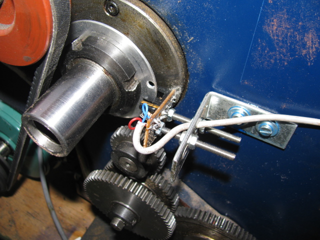

So scaling the index is a no-no.
An encoder running at some ratio is okay but a seperate 1ppr signal must be read directly 1:1 .
There is no reason to connect the encoder's built-in index to linuxcnc in a case like this.
Am I understanding all of this correctly ?
Apologies to soundreflections for the interruption.

Hi Jbraun,
No problem, I am also learning how these things work. Basically, AFAIK we need 3 signals for the best performance, namely the spindle index, one PPR, which I think is just used in tapping, as I see no effect on the RPM, or any other signal when I send an input there, a bit of a dissapointment, as it is the only pin so far connected between lathe and PC. Then there are two pulses, phase A^B, B being optional, increasing resolution and giving direction sensing. They are used by the RPM counter, I have yet to figure out where to calibrate them, but will first mount them, then worry about them.
I now have my index. 1:1, LinuxCNC gives me true / false, so it must be working, I just cannot see anytrhing in the main program itself.

You would need to set the encoder module to "counter mode" and connect your single ppr to the A channel.
You can then connect the encoder position-interpolated pin to motion.spindle-position and the encoder velocity pin to motion.spindle-speed-in and that should give you CSS and feed-per-rev modes.
Replied by andypugh on topic Re:Lathe conversion from stock to CNC
You can probably do something with that, if you want to experiment.spindle index, one PPR, which I think is just used in tapping, as I see no effect on the RPM, or any other signal when I send an input there, a bit of a dissapointment, as it is the only pin so far connected between lathe and PC.

I will do a more detailed write-up, with pictures, on the building of the stepper drivers, but I have them built and running.
I have bought some timing belt pulleys and have mounted my X axis motor. I have a 10 tooth on the motor and a 12 on thr spindle, but I had to go to 10:15 to get the scaling accurate. (I will re-check my lead-screw pitch, something gives me doubt now that I have no direct access to the machine, sitting at work).
I need to bore the Z axis gear to 15mm, I only have a 12mm mill and I am not sure how to make a 15mm bore from a 10mm HSS blank - unless I round the bottom part it won't work. (annoyance of being relatively new to metal turning).
My X axis worked very well, except that after several minutes of 50mm "axis test" The driver obviously overheated and went very strange. Power off to cool and all went well again. I have got some small fans today that I will be mounting on the drivers when next I get a chance.
I have now tapped the threads for limit switches to go in. After my next "working" session I should have X axis ready for action.
I thought I had better do a quick update on this project!

A quick update on non-logged progress:
I have now got X and Z axis's running, though Z needs to be very slow or the motor skips, I may try further micro stepping, or running to max rated current. I am yet to get my spindle encoder going, as well as the spindle control, so XZ only right now.
I now desperately need to get the game controller I bought running, even more desperately need to figure out how to operate LinuxCNC and how to create diagrams and convert to G code. I have tried several CAD programs, but when they cannot draw thread I quit them and try the next one.
I have committed to helping my cousin with a project to make a scale solar system, for which I now need to turn quite a few pulleys, hence my sudden return to the project and furthering completion.
I hope to soon write a number of outstanding posts, starting with stepper driver construction and hopefully having less colourful language than I used mounting my Z motor and making the face plate for my 4 jaw chuck.
