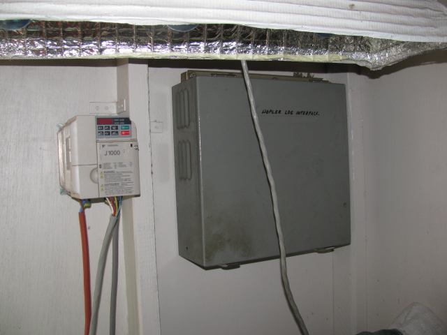

I have found an ideal box among some stuff my work is throwing out. It has latches closing it and the hinges are slide off type. It also has a full metal insert on which all electronics can mount, it can then simply screw in to the box.
I have also started working on my PC. Finally got the thing to boot (long time been standing, looks like it now had a bad RAM and video card.). Looking through the BIOS settings I can set my parallel port to Bi-directional, so hoping I can believe that.
I am wondering how to configure LinuxCNC for serial MODBUS spindle speed. I am hoping it will all be clear and easy once I actually set it up. At this stage I get a black screen once Linux starts, need to play with VGA=778, to try and sort it out, just not had time yet.
Thanks for the SFM hint, I have now found some SMM? charts.
