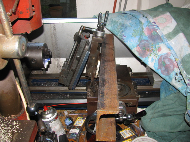

Soundreflections wrote:
I have a 4 jaw chuck, for which I have started turning an adaptor plate, but stopped when I realised I need highest precision possible for the recesses, as the plate needs to fit my lathe's faceplate snugly, and the chuck needs to snug in as well
You just need something that can screw onto the spindle nose. It need not be terribly precise at first. (though will be an interesting excercise in internal threading).
You then mount it on the spindle, and machine OD and register in-situ to take the chuck. Then it _has_ to be true.
If you want to then clean up the back face, re-mount the three-jaw, mount a bar in that then mount the4-jaw on the bar.
I am keen to know how you think I can mount the compound vertically
As JT says, a bit of sturdy angle would work (possibly with a welded gusset).
Bolt it to the cross-slide (I am not sure how, this is the hardest part) and face it off with a lathe tool held in the 4-jaw chuck (crosswise, like a big fly-cutter).
Then bore a hole to suit the compound-slide pivot pin. Probably with a drill mounted in the chuck, followed by a lathe boring-bar mounted eccentrically in a 4-jaw chuck (an adjustable boring bar would be better, of course). Maybe this one:-)
global.ebay.com/Wohlhaupter-UPA2-5702/261069311985/item (actually I was going to post a joke link to a $2000 tool, but that one is a significant bargain at the current price)
Drill more holes at the correct centres for the hold-down bolts, then mount it properly.
Then face it off with the scary fly-cutter again, and drill a second hole. The size of this one doesn't matter, but needs to be smaller than the compound slide register.
Then put the lathe back together, and turn a spigot to fit in the second hole snugly, and to suit the recess in the compound slide base.

My machine has a face as the end of the spindle - it cannot be removed. So I have a 125mm 4 jaw chuck (100mm 3 jaw), so that I can have an adaptor plate that fits the 3 jaw's profile, then has the 4 jaw bolted on. I hope this makes sense?
My biggest problem here is I don't think I will have the desired vertical travel for the hole. I see what you mean by the bit in a 4 jaw, with an offset to whatever size one wants.
I do not follow hundred percent about where I need to face, though I realise the importance thereof. I will only have vertical adjustment once the compound is mounted. I could possibly face the 10mm steel plate, depending on travel, and then mount the vice - or how feasible would it be to have T slots? I suppose 10mm is getting a bit thin here!

The vise appears a bit on the large size compared to the rest of the components. You could just have a plate mounted to the compound with some tapped holes in it and clamp your work down. For fly cutting like Andy said you just need to adjust the vertical axis (the compound) to center your material then using the crossfeed you can fly cut the material to size. More ways to skin a cat as we say around here than the cat cares to know about. You can also get machinist angles... I assume that you use mm so your not in the US?
