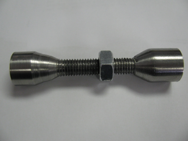

24 Jul 2012 10:18 #22379 by Soundreflections
Replied by Soundreflections on topic Re:Lathe conversion from stock to CNC
Thanks John, I will see if I can get way oil. Sounds like I need to ask your advise on all the lubricants to use.
I would be interested in the oil cups, something practical to do! (LOL) Would then have helped if I was on CNC.
Ended up making this, though I still need to finish the ends.
Cheers for now.
Peet
