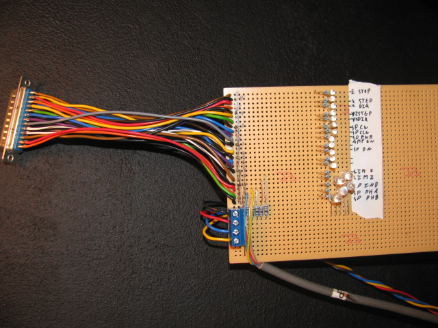

I have decided to use the time I now have, waiting for my driver kits to develop my break out board and look at the mechanical mounting of everything.
I did a very basic breakout board

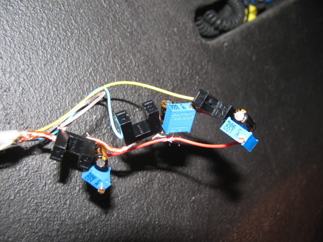

The optical spindle encoder initially gave me some hassles, but I found I was not driving the LED's hard enough, hence the variable resitors to set the current.

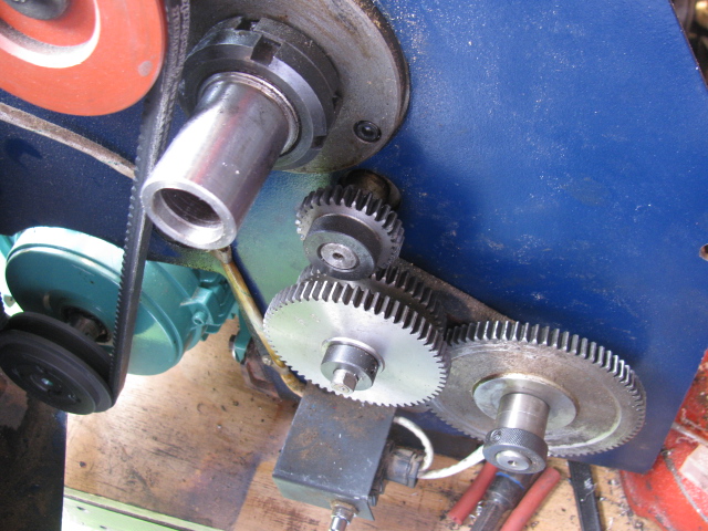

I then went and looked at my lathe's gearbox, to see what is practical.
I plan on putting a stepper through on the right, driving the leadscrew instead of the power take off.
I had thought of interfacing with the main spindle directly, but there is not enough space to fit the encoder and optics, there is also no easy way to take a timing belt off it to a seperate box somewhere. I then looked at the power teke off, which is a scaled output, has a smaller diameter shaft, which I can turn an adaptor for. It also has enough space for me to mount the optical sensors, the best is it will have no real function in CNC mode. I am also concerned with LinuxCNC picking up all the pulses from a 59 slot disk? I still need to figure out how to tell LinuxCNC what scaling / PPR, etc to use.
Can LinuxCNC use a scaled index pulse, or should I keep that on the main spindle? I have thought about using the main gearbox, but cannot see a convenient way.
I would appreciate input and comments.

For threading you need one index per rev.
If your using hardware encoders they can keep up (I forget what your using).
John
John

I am using infra red optical interrupter type sensors.
I will put index on main spindle, that should be quite easy.
Are you suggesting I take phases off main index? Or will it be OK to get phases off the scaled output?

I am using the parallel port straight at the moment, will sort the encoder once I have it on the machine.

It needs to be exactly once per rev, but a simple flag on the spindle shaft will do.
The geared-down encoder is fine. Even if it turns out to have a non-integer number of pulses per rev (though that is vanishingly unlikely considering the function of the gear you are using)
Work out how many pulses per second there are at peak spindle speed, that will tell you if you have enough p-port sampling.
If you haven't it isn't a disaster, you only really need the encoder for threading, and you can do that at a speed where the parport can keep up.
You might find wiki.linuxcnc.org/cgi-bin/wiki.pl?Closed...pindle_Speed_Control
interesting
Replied by andypugh on topic Re:Lathe conversion from stock to CNC

I will have an un scaled index pulse, just scaled phase A&B, will try and figure out how to configure CNC with that later.
