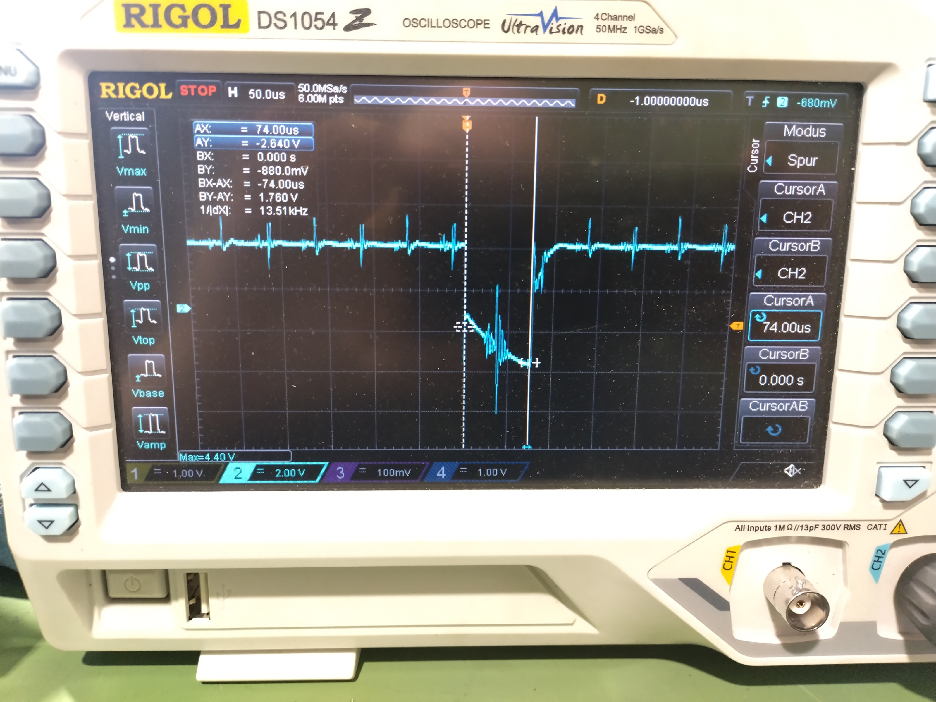

I have a new update. Almost everything is working now. I have one hopefully last problem.
The X axis homing is not repeatable at all. Both axes have a hall switch (original Schaublin), and both axes have linear scales (these do not have index signals). I noticed the lack of repeatability and put the blame on the 50 year old hall switches.
I used the index from the motor encoder (provided by the motor drivers). I connected them to the index inputs on the encoder connector for each axis. So I don’t have the full motor encoder on a separate input on the 7i97T, but I have the A and B lines from the linear scale and the index from the motor on one connector per axis.
With this, the Z axis is rock solid, but the X axis is not.
I homed the axis and drove it against an indicator. Then I rehome and drive to the same position. This way I see about 0.25 mm of variance (I did this about 20 times). Without the index, it was about 0.4 mm.
For Z, the index increased the repeatability from about 0.03 mm to nothing I could measure with my indicators so around 0.001 mm.
What I tested already:
Mechanical: The axis has no noticeable backlash. Moving the axis by hand (with the motor dismounted and turning the pulley by hand) feels very smooth.
Index signal: Both HALScope and a “real oscilloscope” detect the index signal. It is not as clean as I would like it to be, but the pulse is clearly there, and the Z axis that works fine looks the same.
If anyone has an idea where this could come from, I would be thankful.
