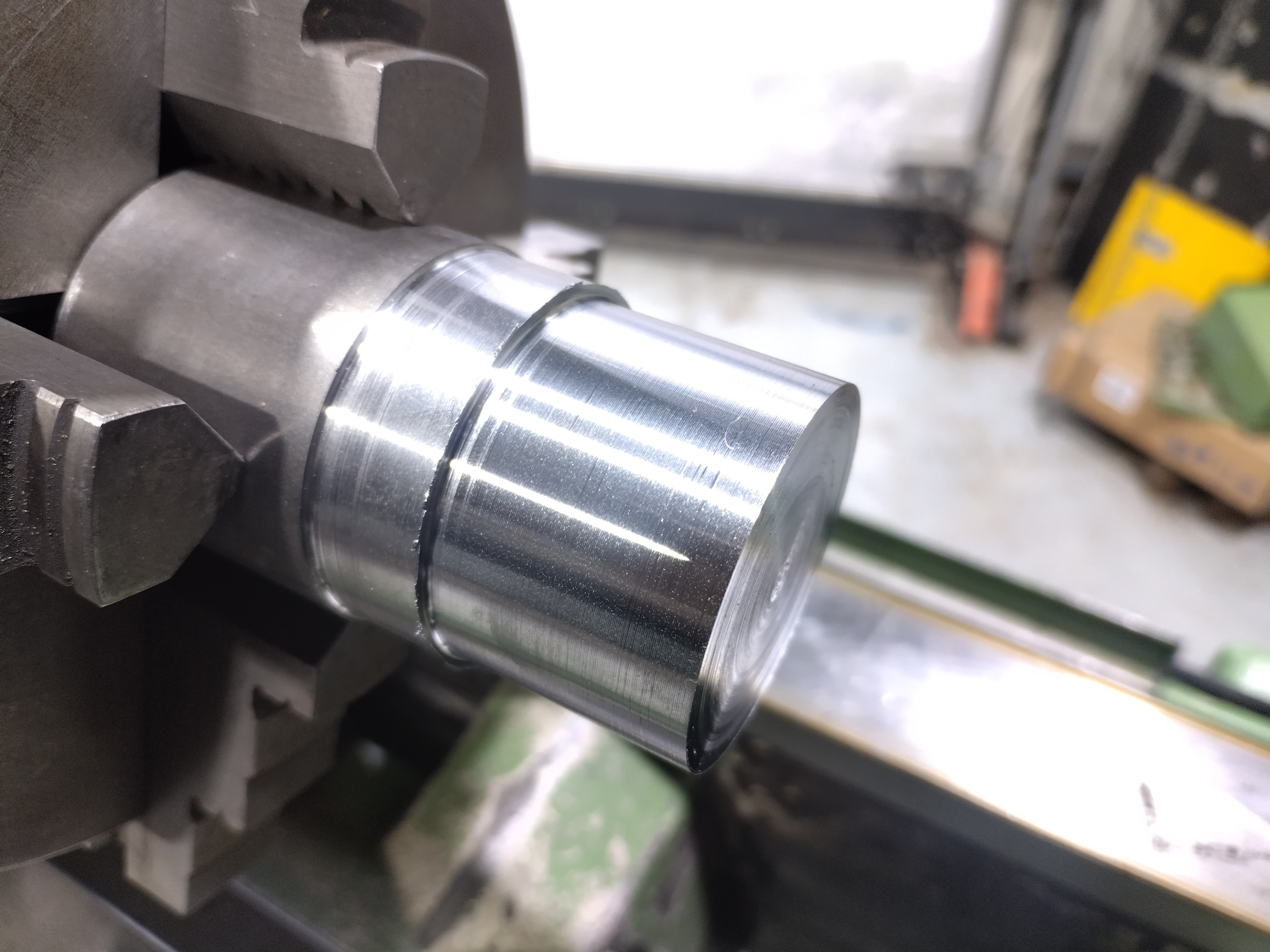

Today I tried threading with G76. It did not go very well (see picture). It looks more like a very rough turning pass. I am not sure if I understand the parameters of the cycle. It is supposed to be M32x1.5.
The code I ran was:
With this, the material was not touched at all, so I started at X32.5 instead of X34 (that is where the picture comes from).
Are the parameters I and K relative (and in radius)? I thought starting at X34 is, in radius, 1 mm away from the nominal 32 mm I want, so I = 1, and the pitch is 1.5, so the final depth should be 0.75 mm lower.
The lines in the GUI looked just like “Figure 4. G76 Example” from:
linuxcnc.org/docs/html/gcode/g-code.html#gcode:g76
Can anyone give me the G76 line for an M32x1.5?
Did I understand you wrong?
The code I ran was:
G90 G21 G18 G94
G91.1
G64 P 0.02
M09
T03 M06
G96 D2500 S60 M3 M8
G43 H03
G54
G0 X34 Z4
G76 P1.5 Z-15 I-1 J0.3 R1.6 K0.75 Q29 H2 E0.75 L2
G0 X35 Z100
M5 M9
M30With this, the material was not touched at all, so I started at X32.5 instead of X34 (that is where the picture comes from).
