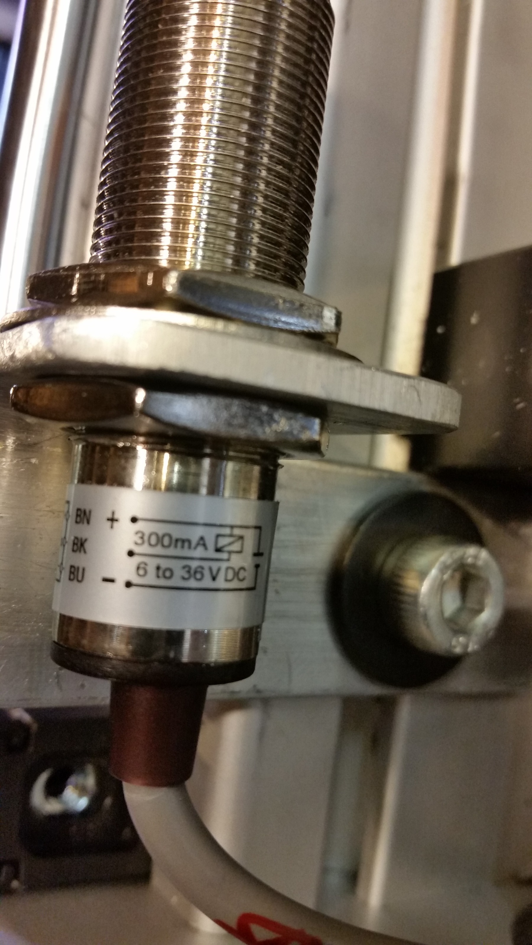

OK, my education continues. I think I'm vaguely starting to get it. I have my inputs configured like the diagram from the OP's Connection Sheet -- with one difference: my sensor is N.O., where his is N.C. Each of my 8 leads go into pins 4-12 on the 7i76e's TB6 connector.
On their way to the input pin, each signal lead gets a T-spliced connection to the +24v side of the power supply through a 2k 1w resistor -- but I'm not sure how this matters, since the sensor itself feeds +24v straight through on it's black wire when it is open. When it detects nearby metal, the +24v toggles to Ground on the black wire. The net is, if I measure voltage on the input pins via their screw heads, that voltage is always +24v while the sensor detects nothing.
Is +24v going into the TB6 input pins OK?
Attached is a photo of the sticker on my sensor. The manufacturer refers to this sticker "the manual" -- yep, that's IT. It appears to show what I believe PCW suggested in his previous post -- that the pullup is built in? The rectangle with the diagonal slash through it is spanning between the signal wire and positive, with "300mA" defined. Does that make the additional resistors unnecessary?
Finally, the difference between the diagram in the OP and my setup: since I'm normally open, the input pin sees "high" until detection, then it sees Ground. Would my configuration just need to invert the signal in linuxcnc to indicate triggering, where this OP's config would show High as a trigger?

I don't think you have a pullup resistor. The "manual" shows a load (whatever you are switching). The NO and NC just says what is the state without the sensor near some metal. So a NC switch will have +24v on the output away from metal and the NC will have +24v on the output while close to metal. Hope I got that the right way round. BEst bet is to hook it up to a power supply and play with a multimeter.
I think you will find that you will get spurious activity on the output without the pull up resistor on an NPN sensor...
This video explains it very well
