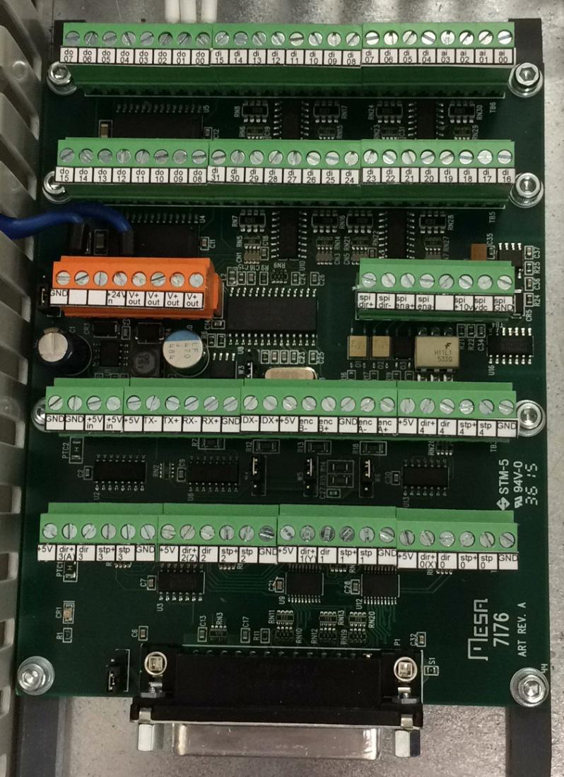

Hello,
I think this might fit here, some days ago I made labels for the clamping brackets of the 7i76:
I attach the pdf and dxf file. I`ve printed them sticked them on doublesided tape.
Best wishes
Jan
Best wishes
Jan
