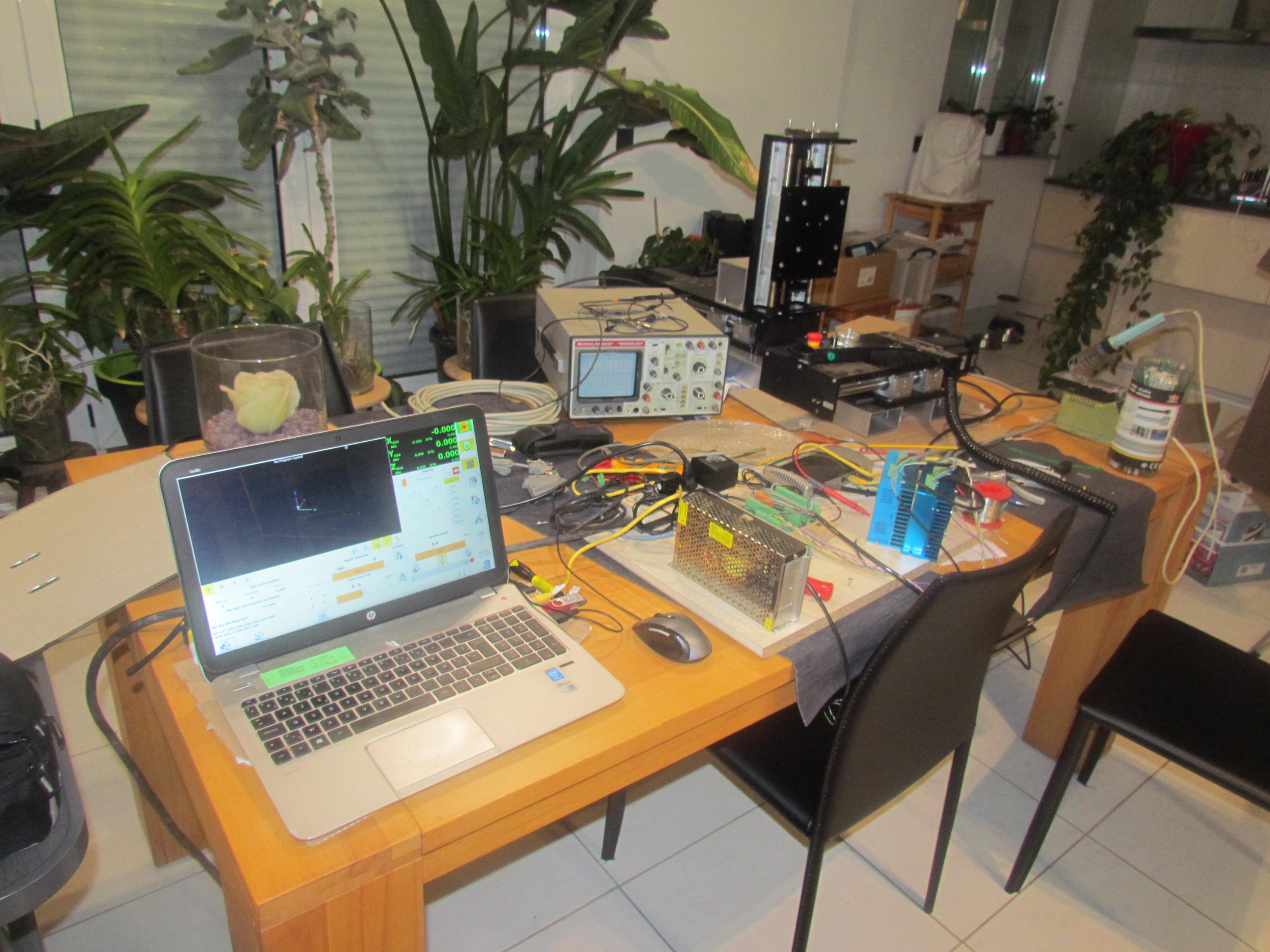

- fons
- Posts: 61
12 Nov 2020 23:29 #189161
by fons
Replied by fons on topic My 7i76e Connection Sheet
mine test setup
