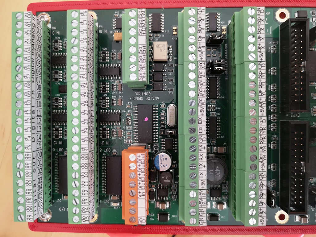

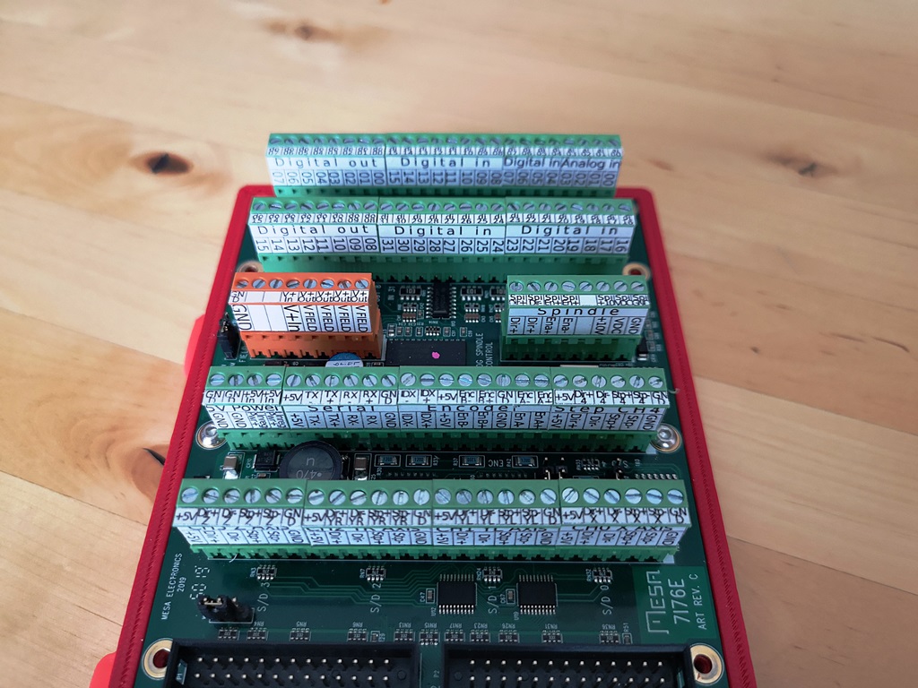

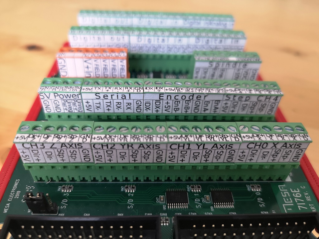

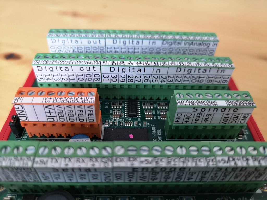

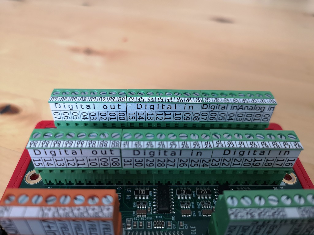

Combined the efforts of @my.cnc.brother (
here
and @+Jan+ earlier in this post to the attached labels for the front and top of the Mesa 7i76e connectors
