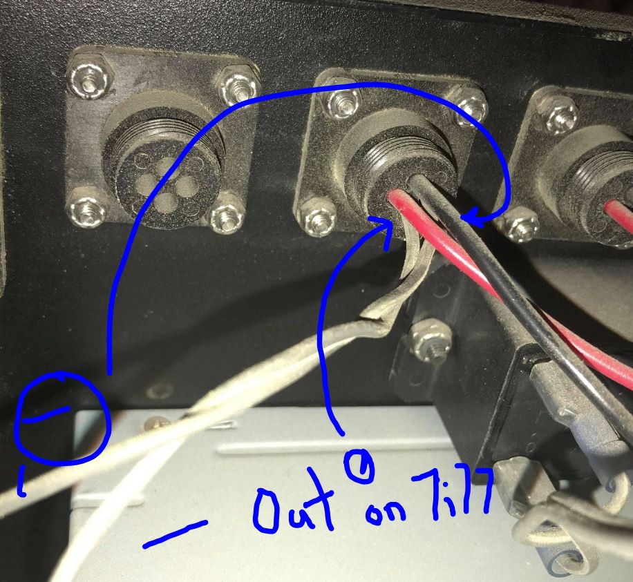

not sure if this helps, but right or wrong, I put wire on the black side to the negative and the wire on the red side to the output pin on the 7i77 card... it's working...

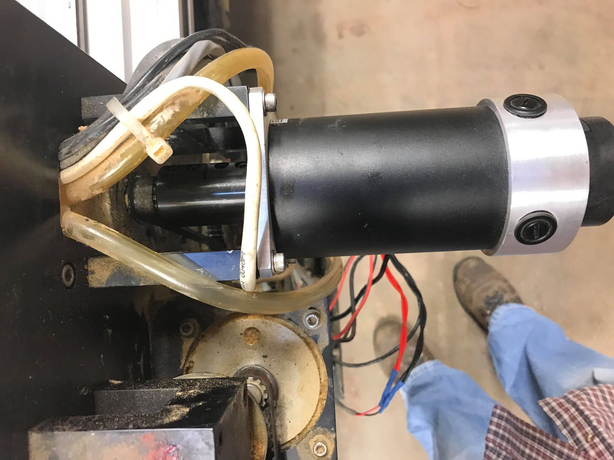

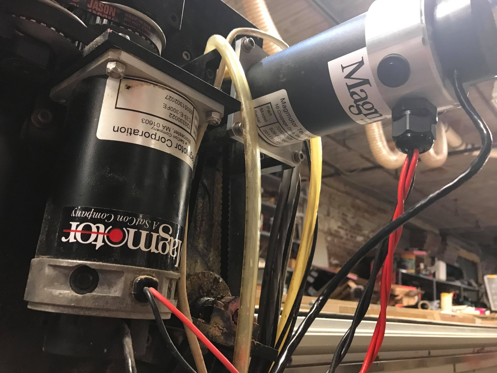

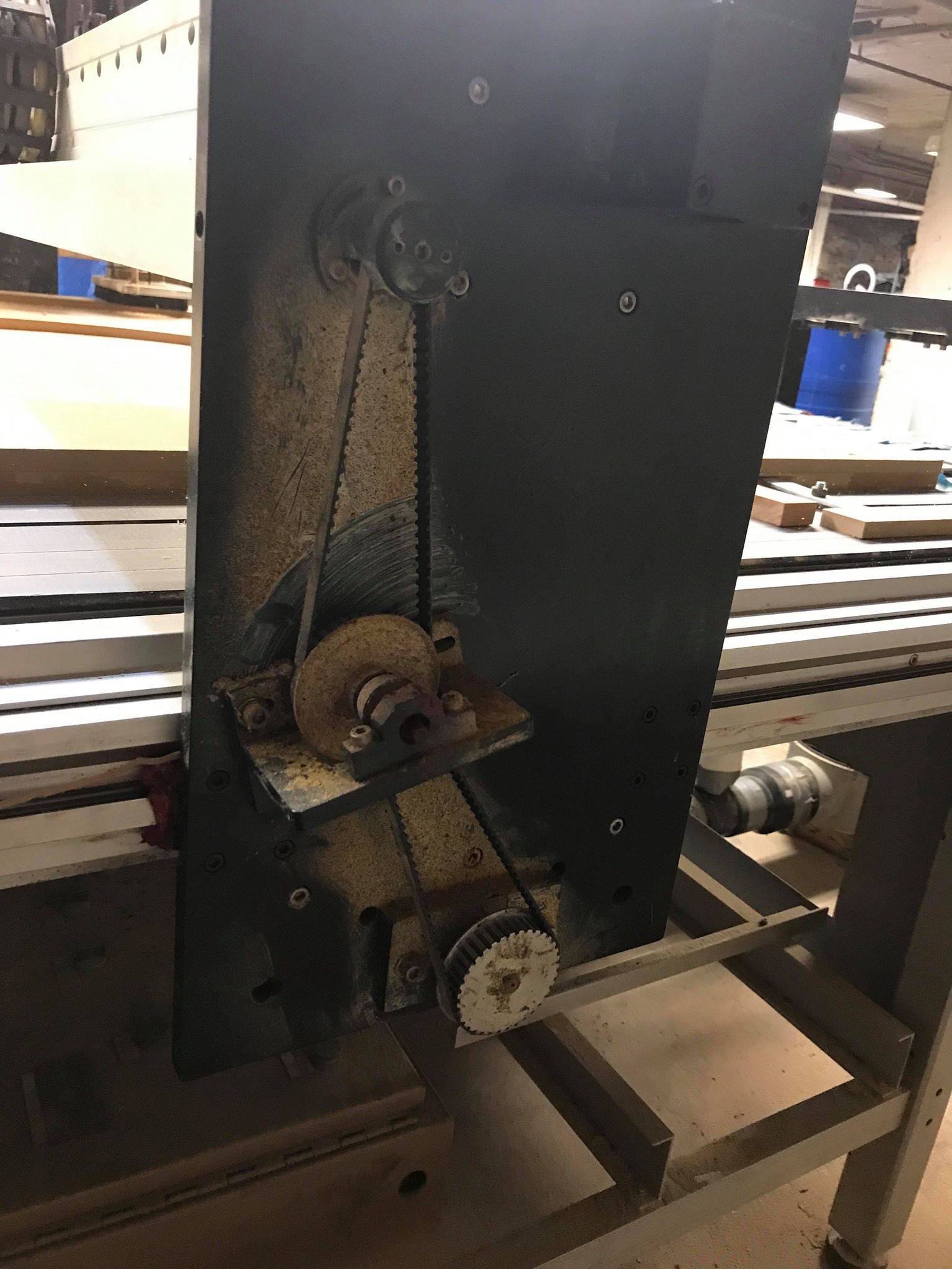

Yes, you are correct, there is a shaft that goes through the Y axis gantry and drives the other sprocket/belt. The X axis motor (the one I just replaced) couples to that shaft, and that shaft has gear to another belt/gear on both sides to long belt/gear.
Yep, 3 servo motors on mine with columbo spindle.
The new magmotor I just added had a different shaft size, so I changed the coupler to a reducing coupler. Seems decent.
