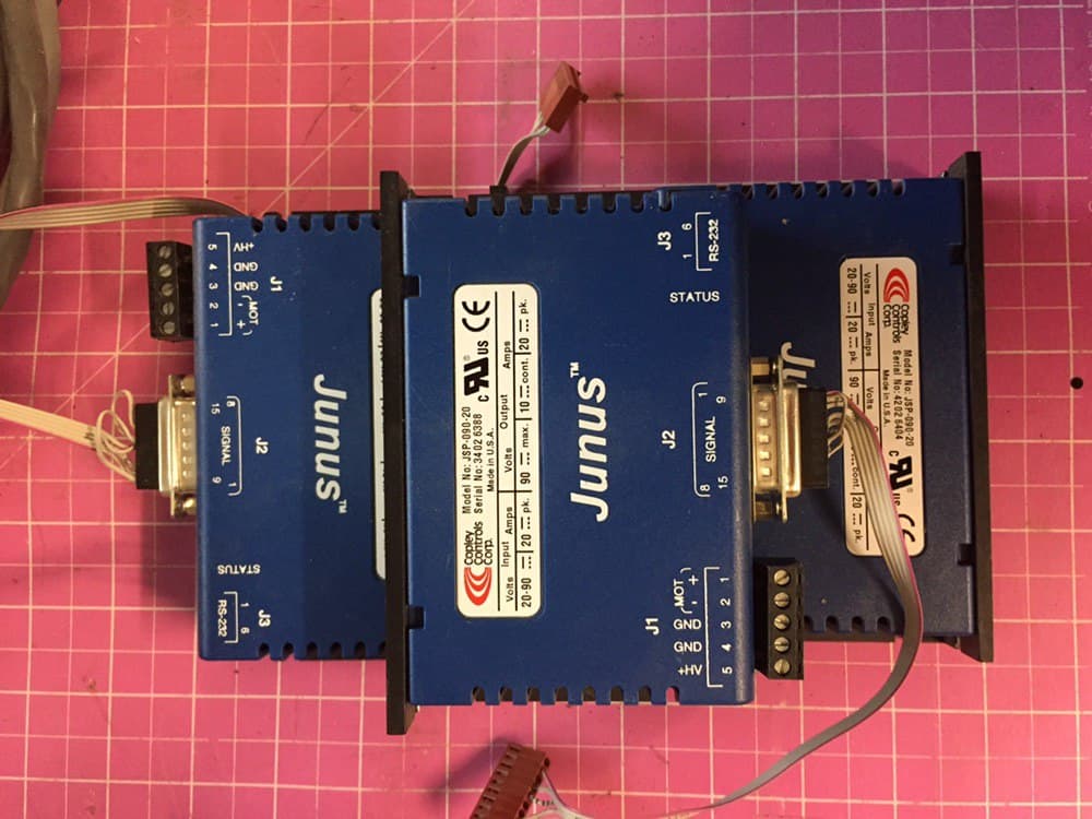

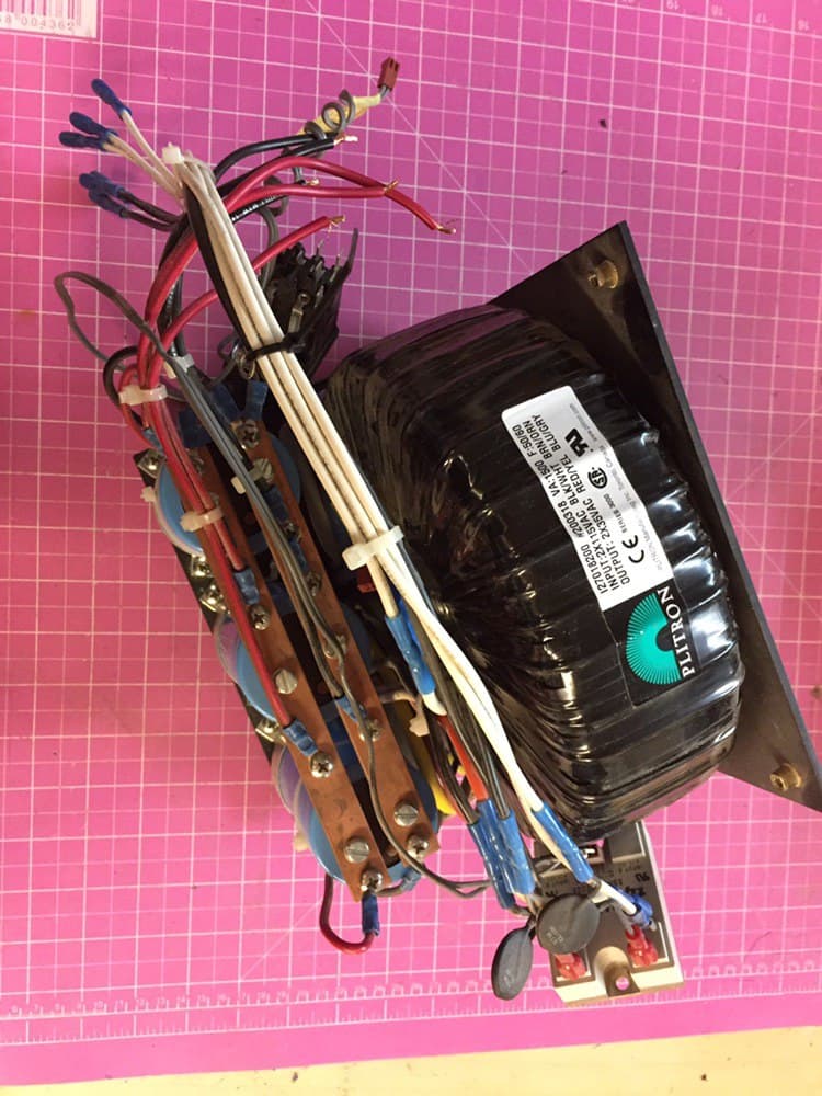

I think posted the way I connected my unit on this thread.
Here are some of my notes, which you are welcome to look at.
drive.google.com/drive/folders/138NwzKSV...wru9Mgxn?usp=sharing
I am sure an expert on MESA cards can help you like they did me.

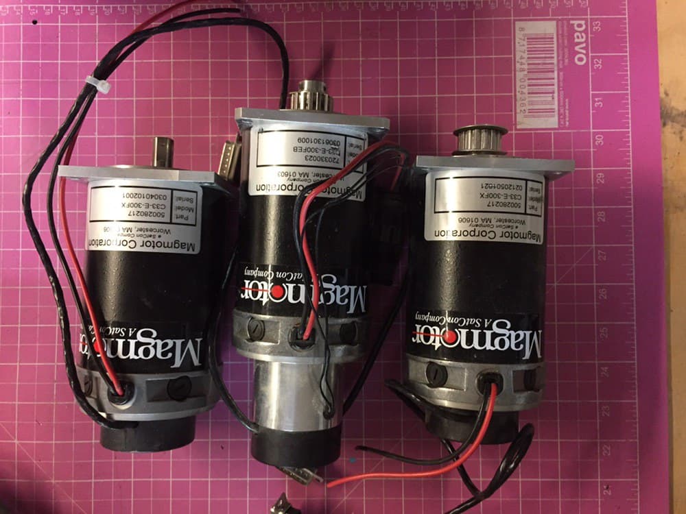

I switched my last Astromech motor to MAGMOTOR which I recommend. They were very helpful. The motors aren't cheap, but I think they are good quality and good support. However I did have a ASTROMECH motor for about a year. Every once in a while I would get a runaway condition on the X axis (the last astromech) so replaced with Magmotor and no problems since.
If you have any questions on my machine, let me know and I will show you what I did - I can take pic/video of my machine... It's not pretty, but it does work!

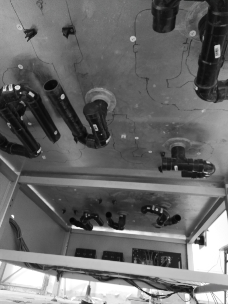

Also some of the vacuum system I took today if they can help:
photos.app.goo.gl/UWqd7nxTHYDhtidh8
Honestly, I usually am trying to hold down 4x8 sheets so they are all open.
Even more honest, I rarely use the vacuum now. I use a composite nailer and hold down my materials that way. It's loud and doesn't do a real good holding down full sheets. I probably got some air leaks and it's only 15hp? or 10hp? I can't recall now. Probably work great for smaller pieces if I had it switched properly.
On mine I think the magmotor and astromec were wired similarly. Who knows how they did them, since mine had 2 magmotors and 1 astromec when I converted. I think when I switched to magmotor I kept the same wiring it's been a while.

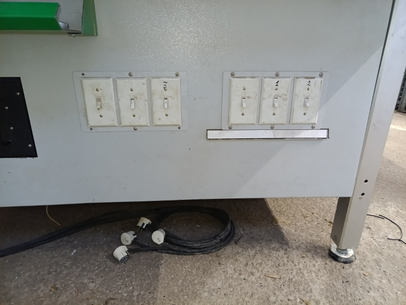

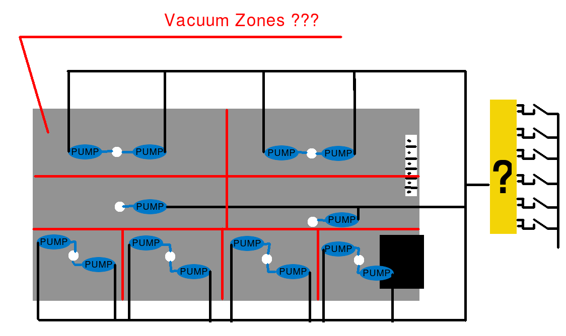

I attach a photo of the original control of vacuum pumps.
There are twelve (AMETEK lamb electric 116312-00 ) vacuum pumps (mine are now removed for maintenance). Four of them are connected to the holes one to one. The other eight are two to one hole. (See the appendix.)
This is controlled by six switches. One switch to two pumps, how they were connected in the original I do not know.
I have holes on top of the table in the sacrificial material not drilled and I can't check which hole is responsible for which part of the table (yet).
For good holding down, it is not the power of the vacuum pump motor is important, but its air performance. Original pumps have an Air flow 50 l/Sec that means: 50*60*60 - 180 m3/hr. Total 180*12 - 2016 m3 per hour (Vac 133 mm H2O). I suppose you need a more productive vacuum pump.
You wrote: "Let me know what else I can do to help!".
OMG! I saw a picture of the Precix Servo Controller USER MANUAL v.99f ! Do you have a scanned copy? It would be very helpful to me.
Thanks again for your respponse.
