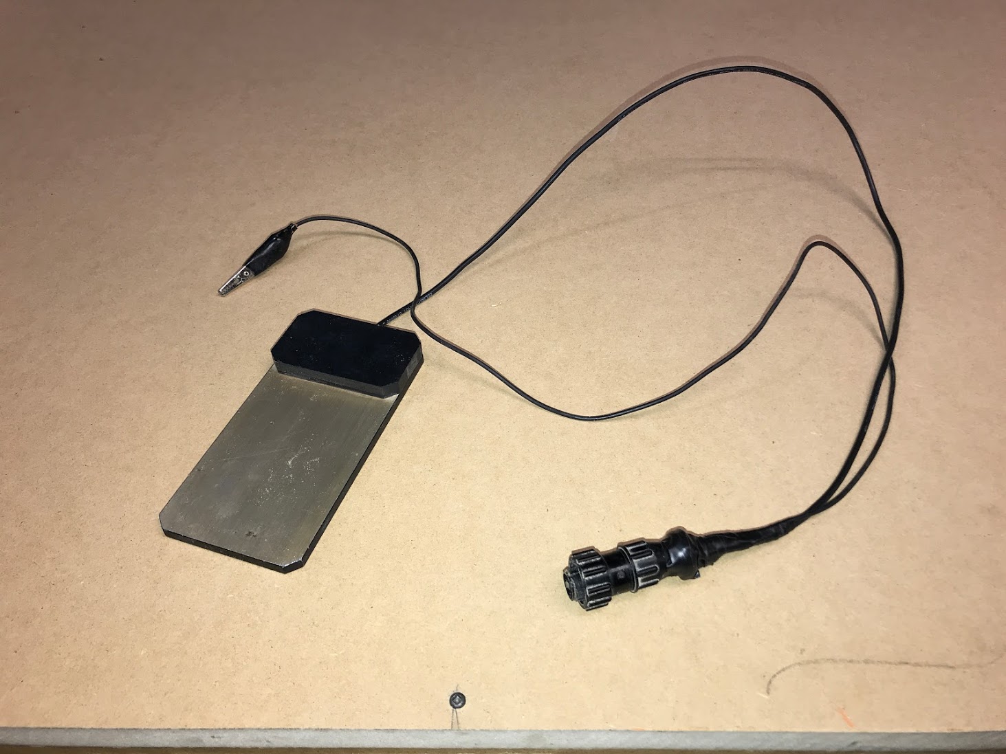

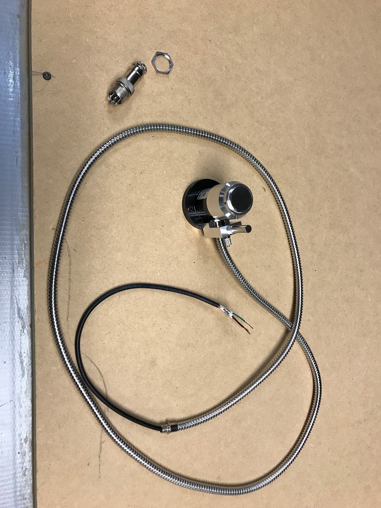

28 Feb 2021 17:20 #200484
by randypetersen
Replied by randypetersen on topic Retrofit of Precix 5x10 CNC
First off I want to say, thanks so much for all the help this forum has provided! I really appreciate it...
Trying to expand the machine a bit to make it function better for me.
It came with a touch plate, however I never thought it would work properly. It's an air cooled spindle and it was added afterwards. The tool bit is not making any connection with any of the wiring. It is sometimes grounded to the unit, but if I rotate the bit the connection goes on/off, is that normal?
Since I am having issues with my V-engraving being sometimes too deep, sometimes too shallow, I really want a reliable and accurate way to tell the surface of my material. Thanks to the forum, using my XHC-WHB04B is working great! but hard to get the Z exactly right.
I took the plate they provided and I added a clip to it, there were 2 wires going to the plate, now 1 goes to the clip and 1 goes to the plate.
I verified that I have a good connection going from that to some wires in my controller that can go to my 7i77 card, just hoping to get some help on how/where to connect them. Also, seems like I will need a new probe screen?
I also purchased a tool setter probe in hopes that during tool changes I can be more accurate.
Bought of Amazon:
www.amazon.com/gp/product/B07PRPMZKS/ref...05_s00?ie=UTF8&psc=1
Not worried about that right now, want to focus on workplace z height accuracy and whatever software I will need to do it.
Thanks for any help!
