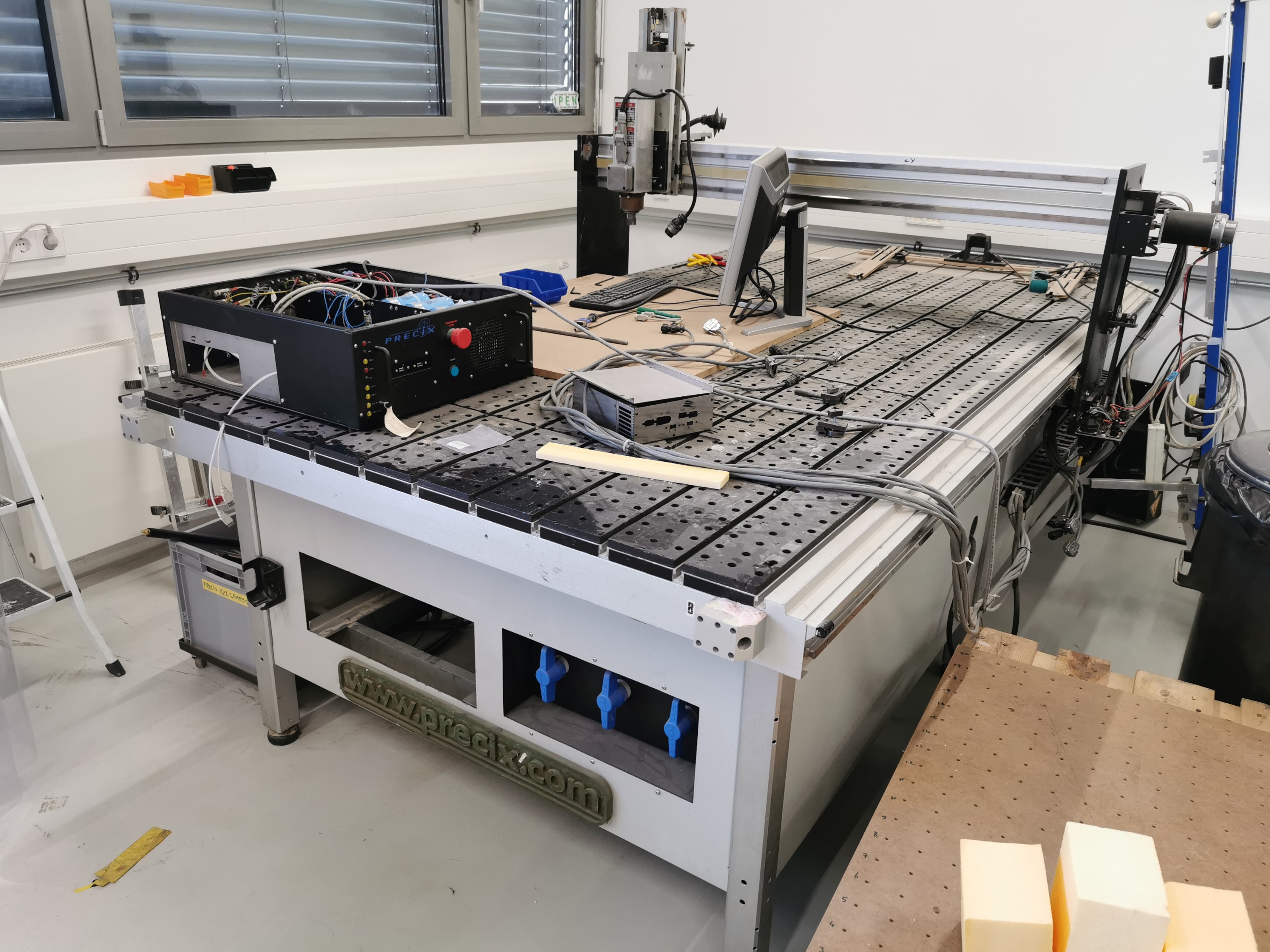

Hello all!
First i want to give big THANKS! to Randy for giving all the infos of his precix retrofit!
We also have an Precix mill (almost the same config as Randy's running since 2000 at our university department (Art academy in Austria).
Mechanically we ran through many repairs/fixes during the last years on our own as we got no support from precix. Mostly we suffered from UNC part supplies in europe, so the mechanics turn more and more into metric
Thanks to Randy's posts we were encouraged to give our old lady another chance to stay in our workshop, as our controller went down 2 years ago.
So far we go the same track with mesa 7i77 and 7i92 (just shipped)... and i am super eager to get it running again.
So far we have no major issues, thanks also to linux cnc and the forum! ... but i would be very grateful if you guys could help me when stuck with the project.
Best wishes from Austria,
Armin

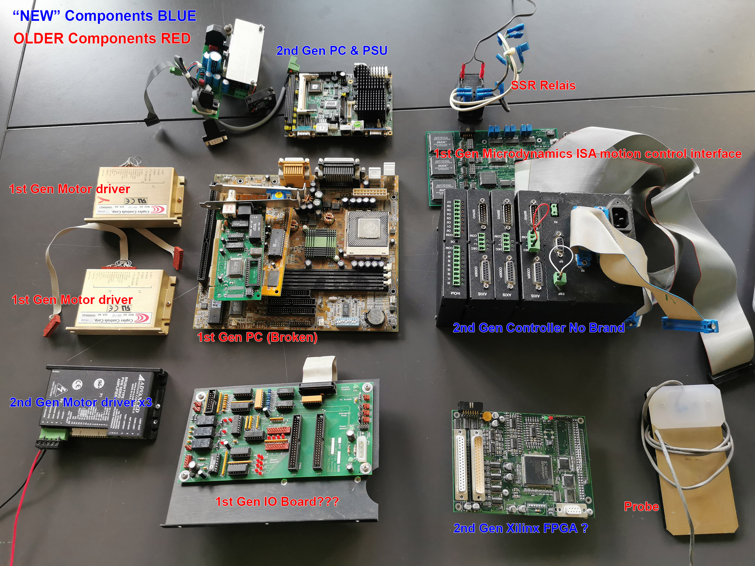

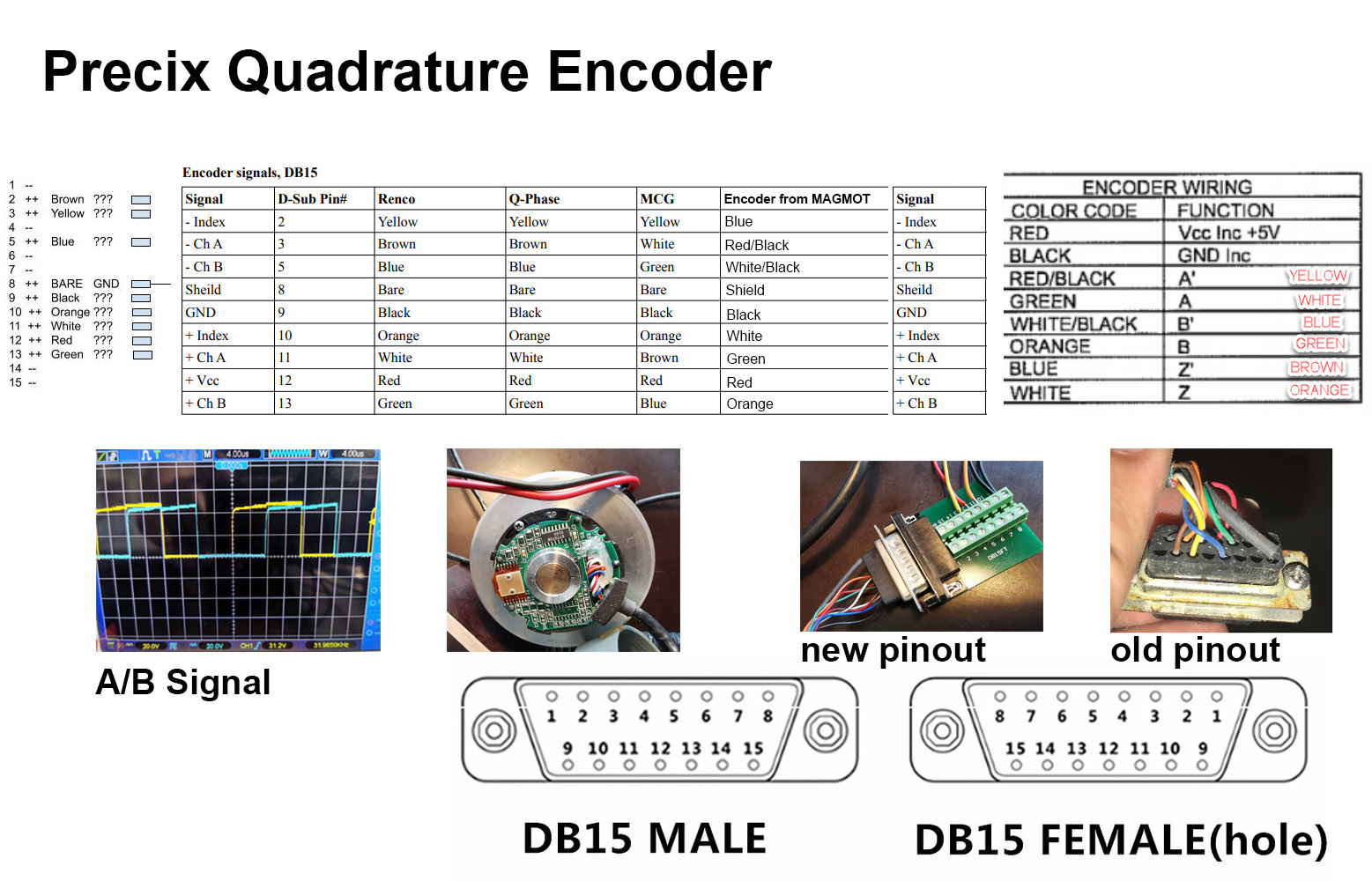

@my project:i cleaned up my controller cases- so we had two controllers:
-one very old and original from precix dating back to 2000, and
-a newer one (~2010?) which was changed already to linux cnc. sadly i could not figure out the controller type/brand from the newer one.
so all hardware (mostly) twice
-i will try to keep most hardware motor/encoder/servo drivers. and the toroidal psu(s).
made a photo of the old stuff:
- i tried both motordrivers (1.Gen and 2.Gen from the image) pinout is fairly the same, but i would go with the older drivers first (for testing) ?
- i am trying now to set up a servo loop on the bench for learning. i could also go with an mpg controller - would this make more sense?
- tested the encoder signals, not sure if the signal looks ok ?
- last but not least i would like to test the toroidal transformers, the capacitors are rather old, would this make sense ?
- i also would like to add up to randy's documentation as we have fairly the same machine, but i am not sure if this is the right policy here?
thx in advance,
Armin

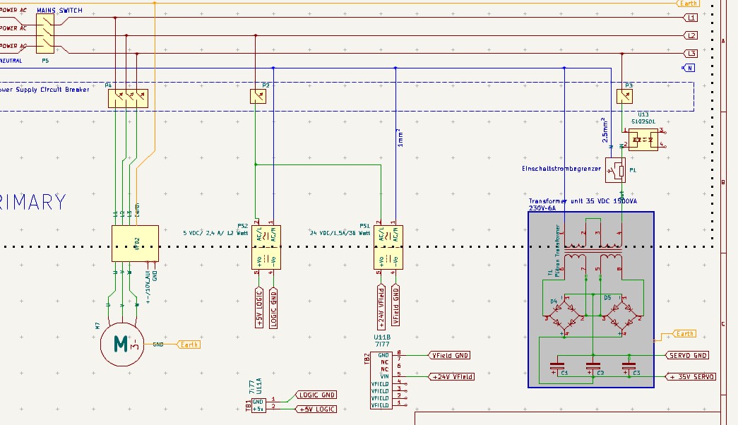

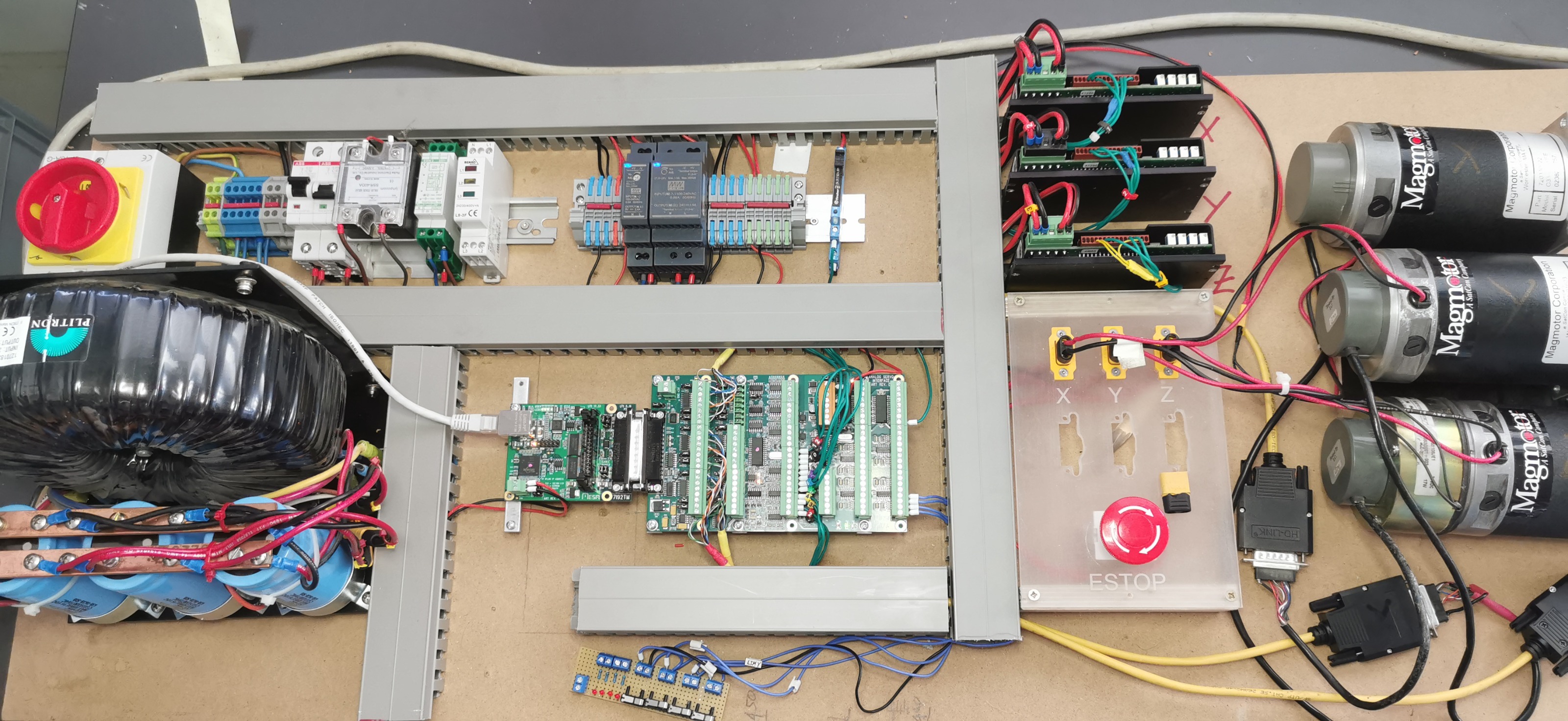

Dear Randy,
Sry, it took a while to get my precix project further. Not sure if you are still on this forum.
Meanwhile i build the electronics from scratch (also the electricity supply), i did a (almost) complete blueprint with Kicad which turned out super helpful. Also ran some gcode (just with the test setup, not the whole machine).
But:
After some testing it turned out i have a issue with my transformer: when switching off all breakers on the AC side go down. Also my SSR Relay which switches the toroid trafo went up in smoke. So i guess an ssr was not a good idea to switch the trafo.
Maybe you could help me with my issue(s):
Did you have similar issues? - Primary Fuses Blown?
What components do you have in front of your servo trafo? Maye a varistor or some other circuitry?
Did you change the big capacitors as they were end of life? - But i guess this is not the issue.
I added a screenshot of my blueprint with my actual configuration. The trafo/PSU is marked in grey.
Also if someone else could help me with inductive overcurrent/overvoltage issues i was super happy, even if it has nothing to do with LinuxCnc.
Thks,

Wow, that's awesome! What a cool build out.
I am sorry, but I am not that knowledgeable on that. I had to get help to hook up my vacuum and spindle VFD. The other components powered up as normal. No issues with tripped breakers or blown fuses. I didn't change the capacitors, but I think I should as I am having some issues on fine motor control.
I am sorry I can't help much, I'll take a video of my controller, maybe you can see something mine has that yours doesn't.
This forum is filled with super intelligent people, I am guessing someone will chime in. If not, you might want to make a new forum post and I'll bet someone will help.
