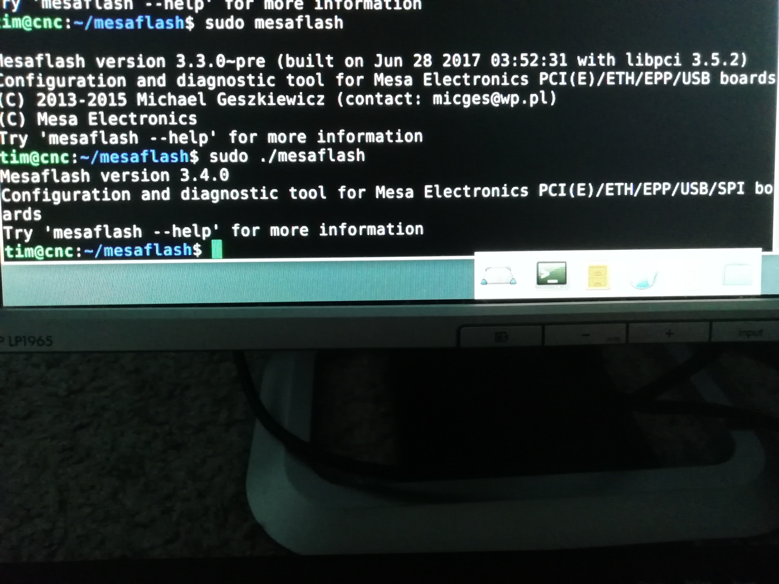

09 Oct 2021 16:44 #222662
by mittim
Replied by mittim on topic Mesa 7i95
- Posts: 18093
- Thank you received: 5325
09 Oct 2021 16:46 - 09 Oct 2021 17:07 #222663
Replied by PCW on topic Mesa 7i95
You did not install the newer mesaflash:
sudo make install
EDIT
No, I see you did install the new version, maybe the old version
was installed somewhere else.
You might try:
which mesaflash
to find out the path of the older version and then delete the older version
sudo make install
EDIT
You might try:
which mesaflash

09 Oct 2021 17:06 - 09 Oct 2021 17:06 #222665
by mittim
I don´t know what´s the issue
tim@cnc:~/mesaflash$ sudo make install
install -p -D --mode=0755 --owner root --group root mesaflash /bin/mesaflash
install -p -D --mode=0644 --owner root --group root mesaflash.1 /share/man/man1/mesaflash.1
tim@cnc:~/mesaflash$ mesaflash
Mesaflash version 3.3.0~pre (built on Jun 28 2017 03:52:31 with libpci 3.5.2)
Configuration and diagnostic tool for Mesa Electronics PCI(E)/ETH/EPP/USB boards
(C) 2013-2015 Michael Geszkiewicz (contact: This email address is being protected from spambots. You need JavaScript enabled to view it.)
(C) Mesa Electronics
Try 'mesaflash --help' for more information
Last edit: 09 Oct 2021 17:06 by mittim.
- Posts: 18093
09 Oct 2021 17:08 #222666
See my previous edited response
- mittim
- Posts: 92
09 Oct 2021 17:16 - 09 Oct 2021 17:16 #222667
by mittim
That´s it!!!
There was a mesaflash file in /usr/bin.
Now readhmid in mesaflash works.
Thank you for your patience.
Last edit: 09 Oct 2021 17:16 by mittim.
