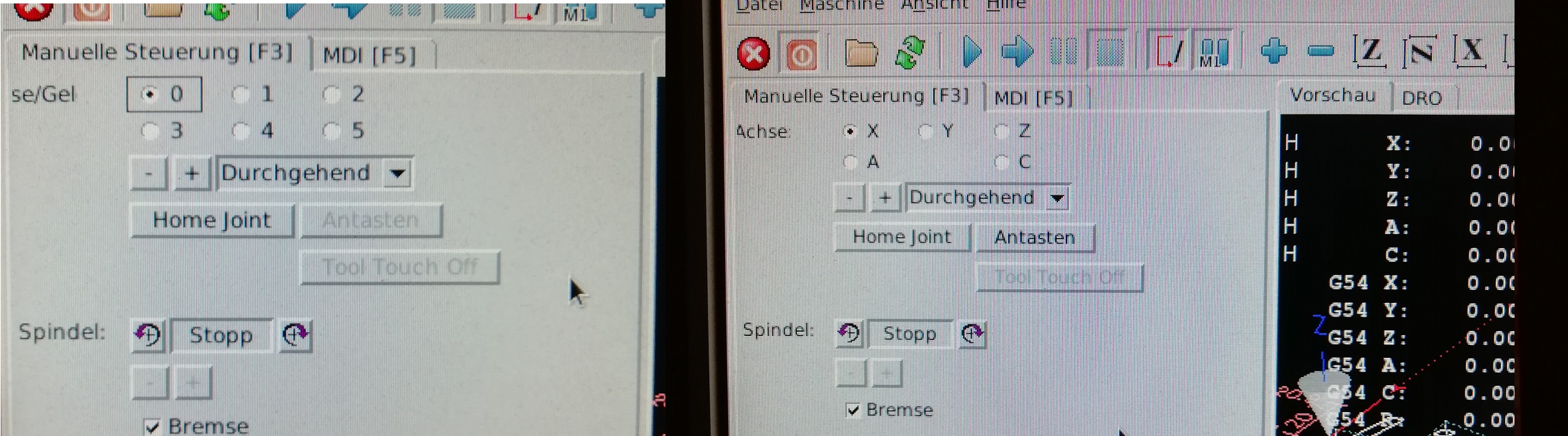

10 Oct 2021 11:52 #222741 by mittim
Replied by mittim on topic Mesa 7i95
I am currently trying to edit the .hal and .ini to my gantry style Y-Axes. Y on joint1 and Y2 on joint2. Motor connected to joint1 does move, while motor on joint2 does not. Also there is no movement in the DRO when moving Y.

10 Oct 2021 17:33 #222778 by mittim
Okay, have to look that up. This is what I´m getting right now before and after homing:
10 Oct 2021 17:50 #222783 by rodw
Replied by rodw on topic Mesa 7i95
As Peter says, you need HOME_SEQUENCE=N for each joint in your ini.
Joints 1 & 2 (your Y axis) need to be HOME_SEQUENCE=-1
Joint 3 (your Z) is usually HOME_SEQUENCE=0 so it lifts up out of the way at the beginning
All of the rest could be HOME_SEQUENCE=1 so they all home simulteneously or you could continue the sequence to do them in sequence eg use 1,2,3 to set the order you want.
What does it look like after that?
