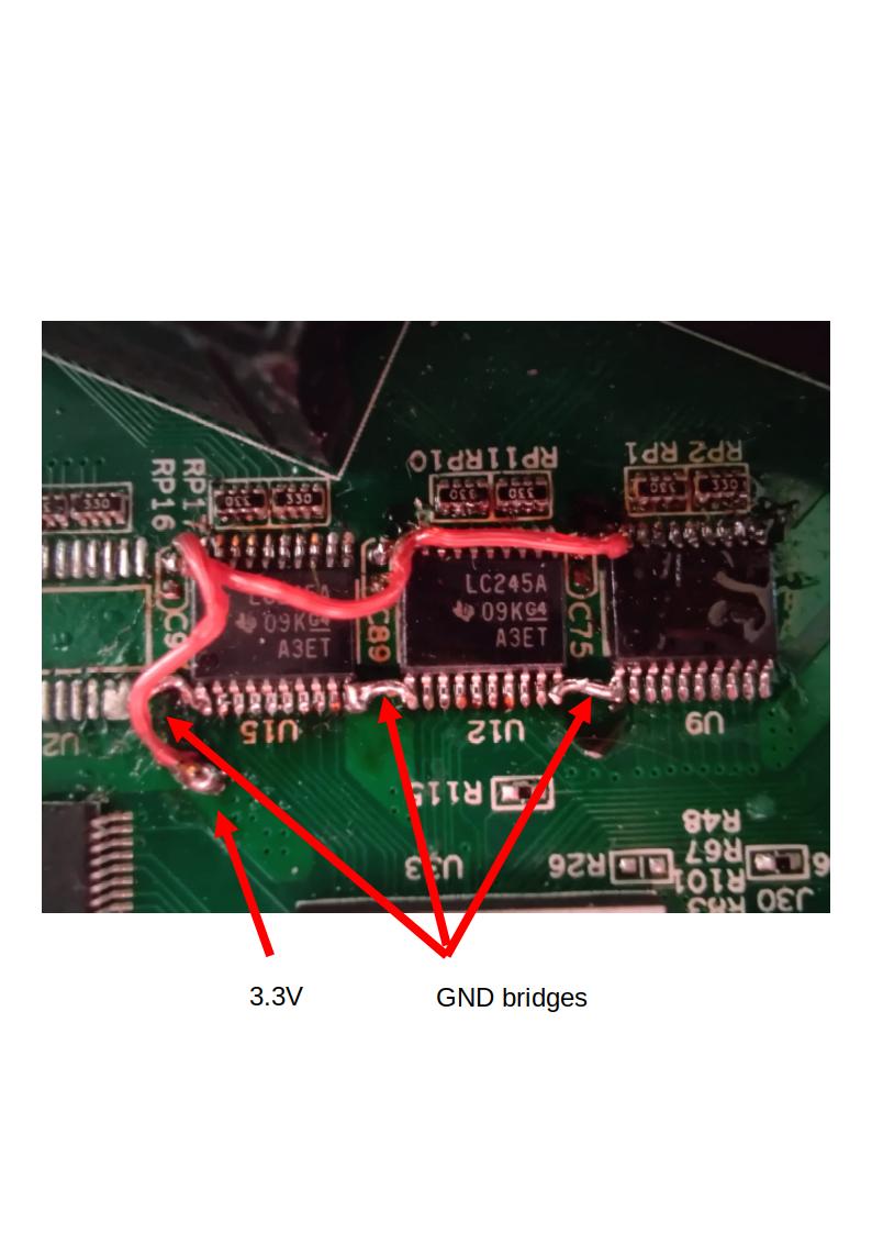

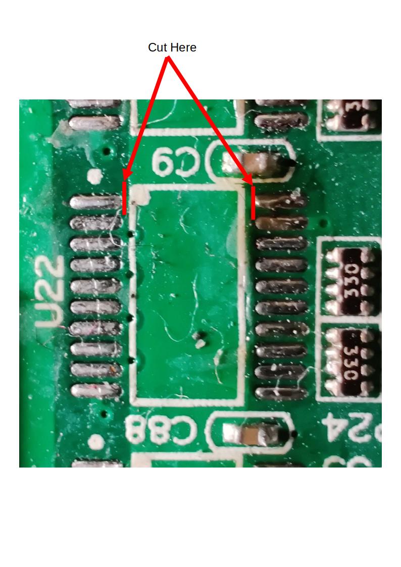

About the mod for inputs, for 5a75b I've swapped U9 U12 U15 with 74LC245 ic's.
I'v removed the old buffers, cut the connection of pin 1 and 20 in order to rewire them.
Then soldered on the new buffers, connect pin 1 to pin 10 of the nearest chip (GND)
then connect pin 20 to 3V3 trace nearby.
This mod is IMHO a dirty hack, in future I'll replace buffer with simple bridges and
then connect external pcb with proper pull-up/downs, filtering and optocoupling as needed.
Last edit: 25 May 2022 17:01 by muvideo.
The following user(s) said Thank You: besriworld, TOLP2
